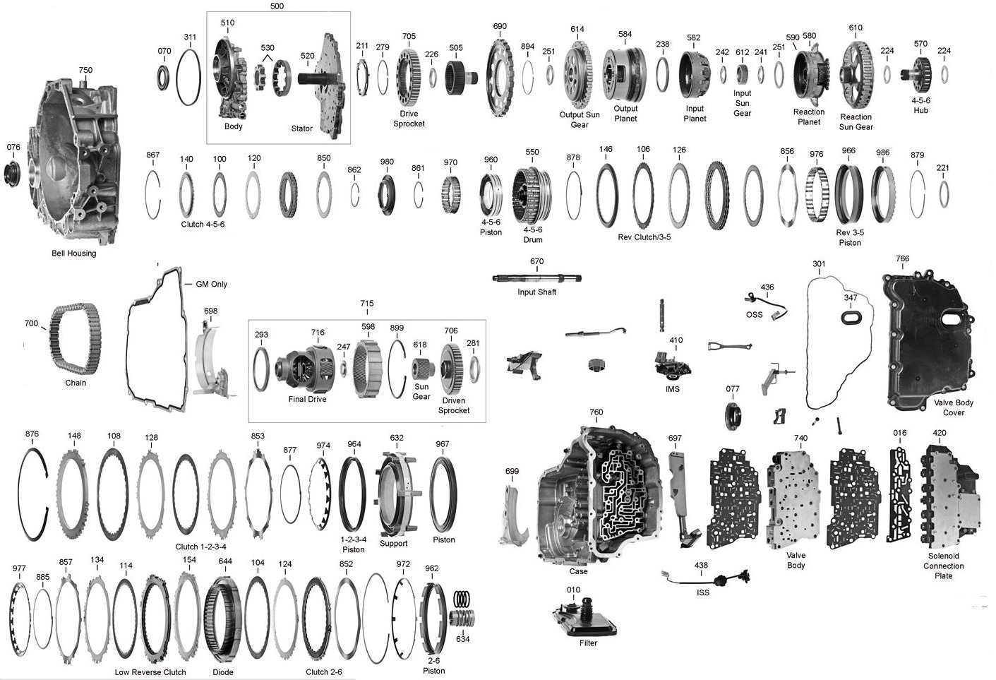

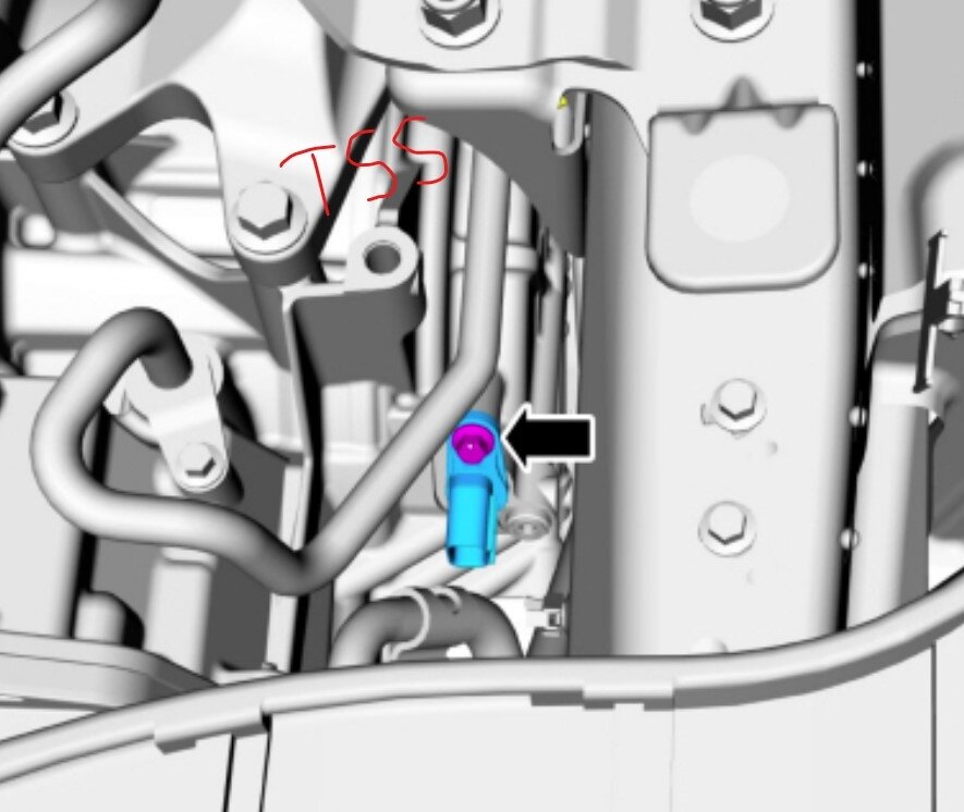

What is the problem you have? Both of those sensors will set codes if they are a problem. Either circuit or signal range codes. The cover is the large one you see in this picture, should be on the front of the transaxle. You can see the input and output sensors in the exploded view.

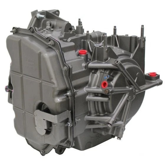

Is that the one sensor?

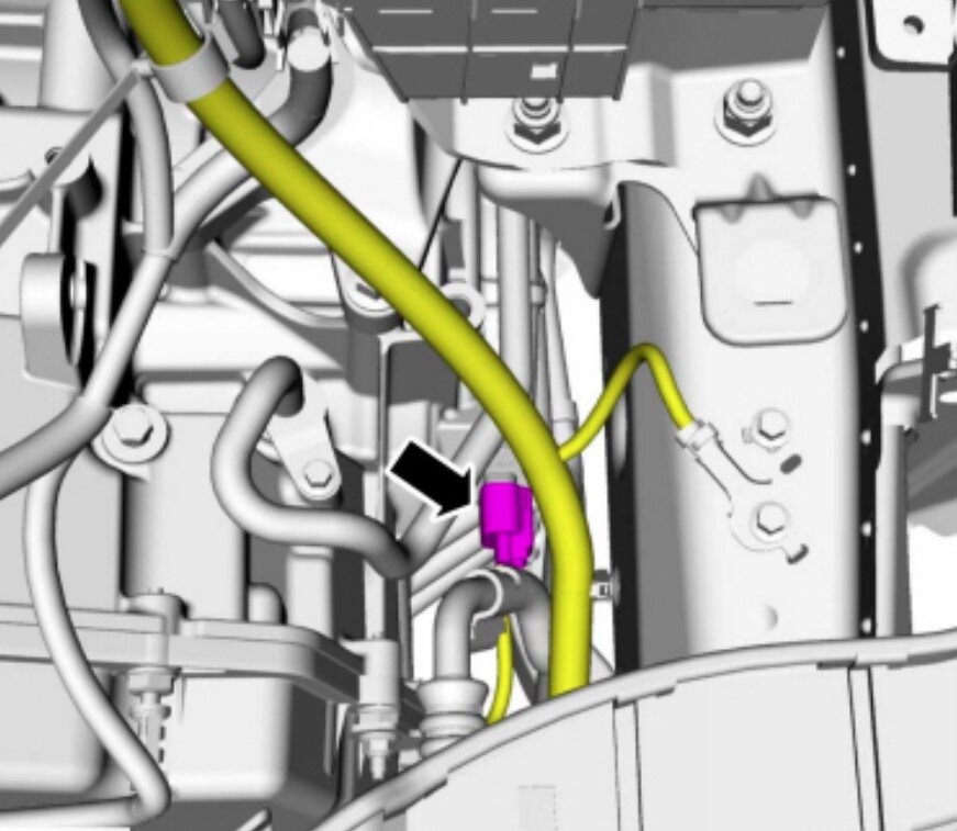

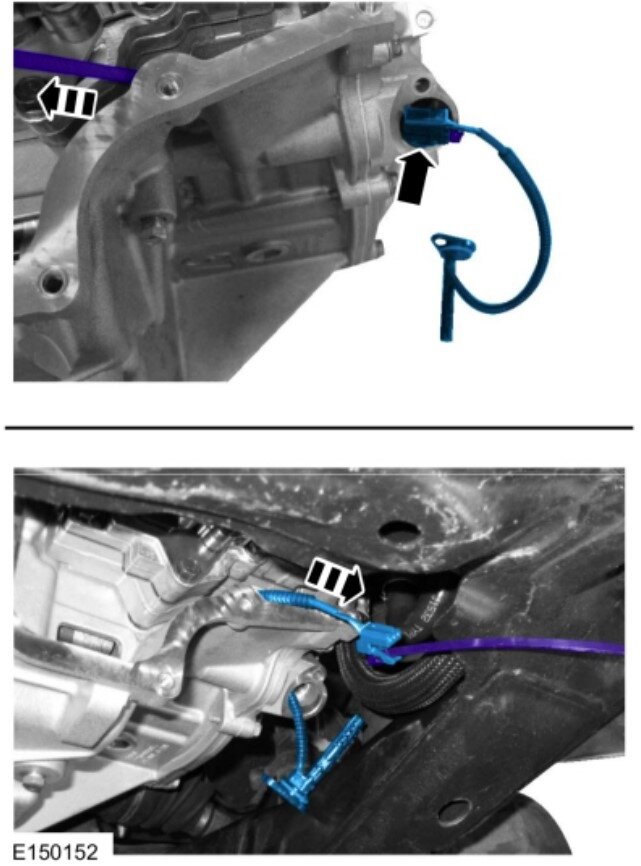

It doesn't look like it unless that image is flipped. You can see the locations in these images. There is only a connector on the outside of the transmission, the sensors are inside.

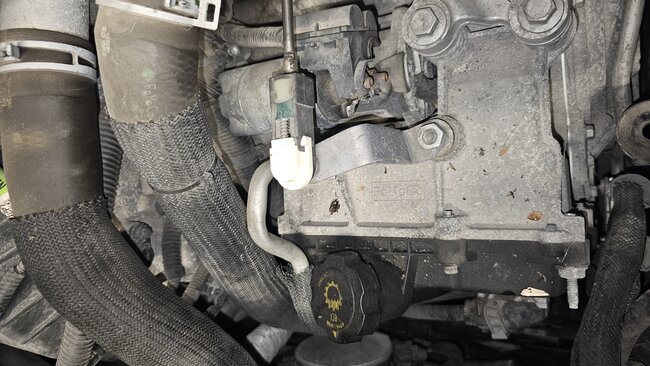

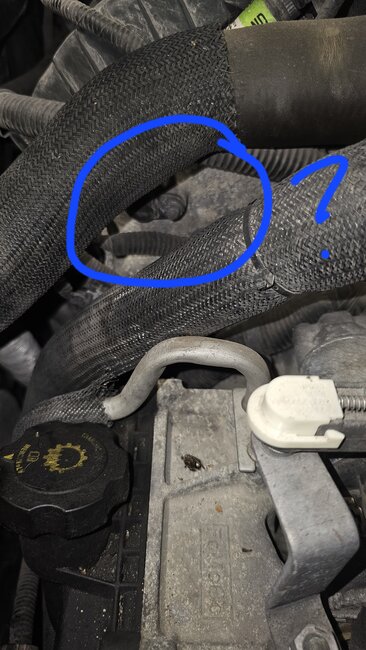

OK, need some more help. The pics I sent you earlier are looking into my engine compartment from overhead, driver side facing passenger side with the air filter box removed. I can't find any landmarks in the drawing your providing that look anything like my engine compartment fit the tss. Are those pics with the battery and tray removed? Looking up from the underbody? I can't find that cross member with the two bolts on the left either.

The sensor connection is on the opposite side of the transaxle in the pictures you took. If you follow the cooler line toward the back and look below it you will see the connector. But the sensor itself is inside the transmission.
