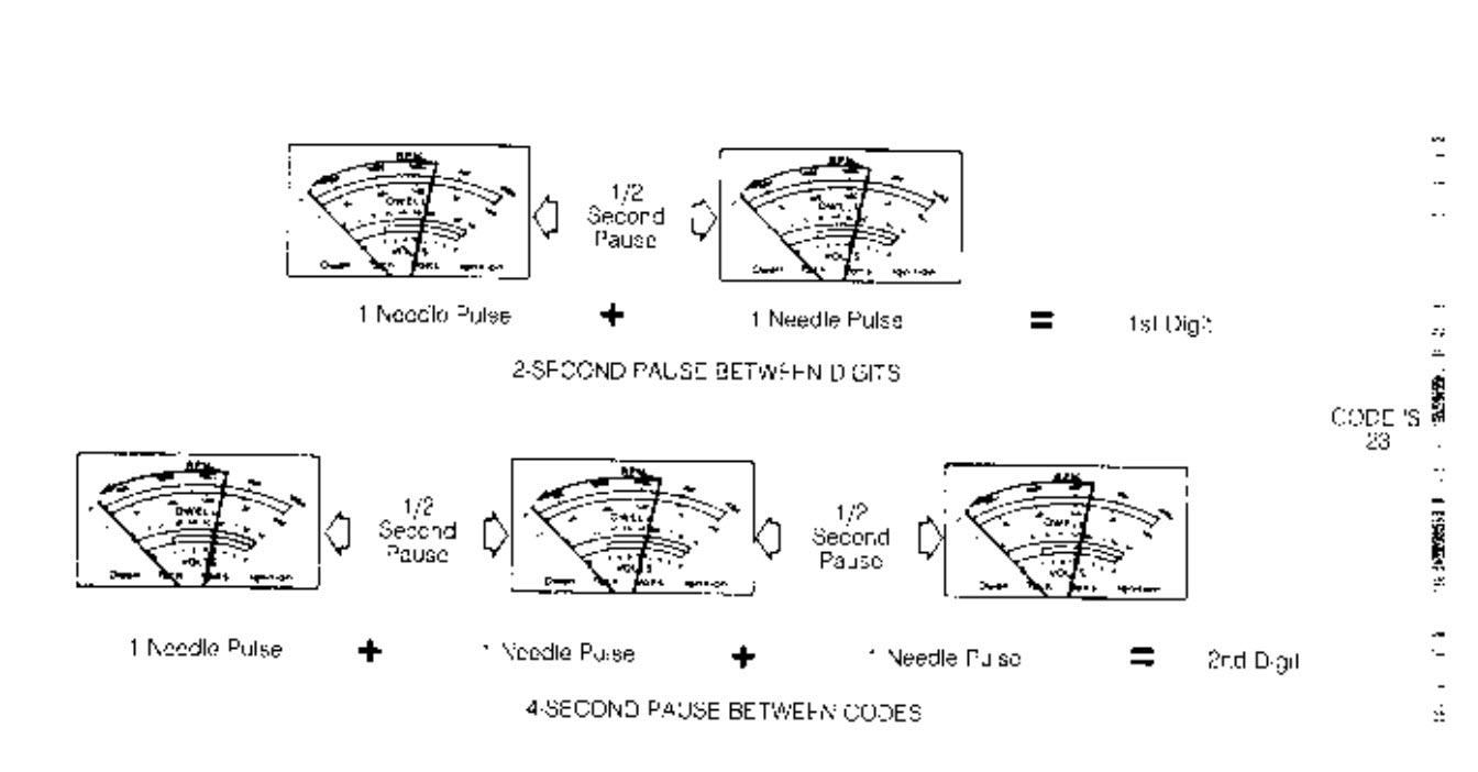

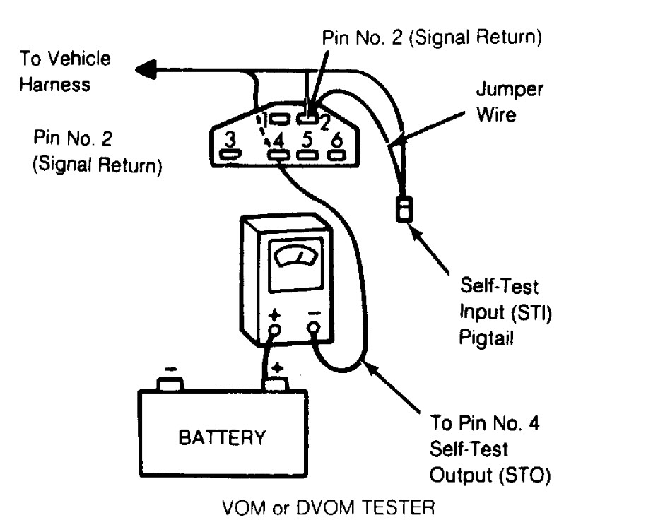

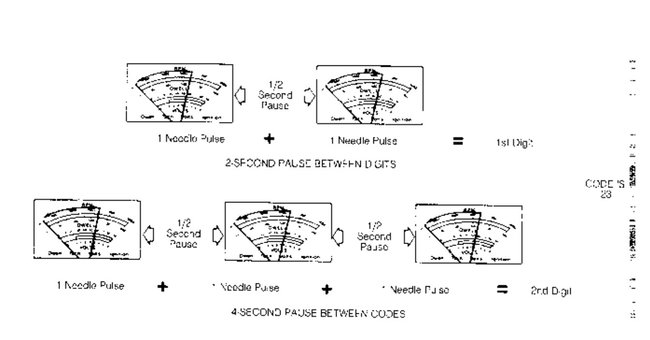

scan for codes first and then check compression and check plug wires also check fuel pressure with a gauge auto parts rent it then get back to us. see pics and link.
