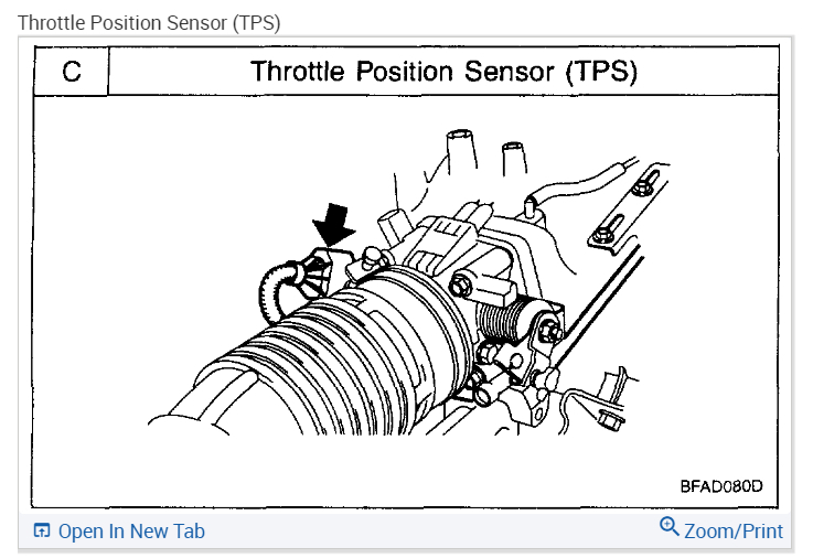

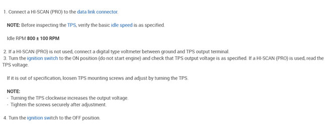

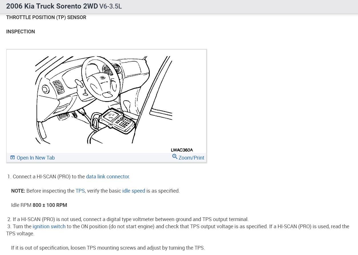

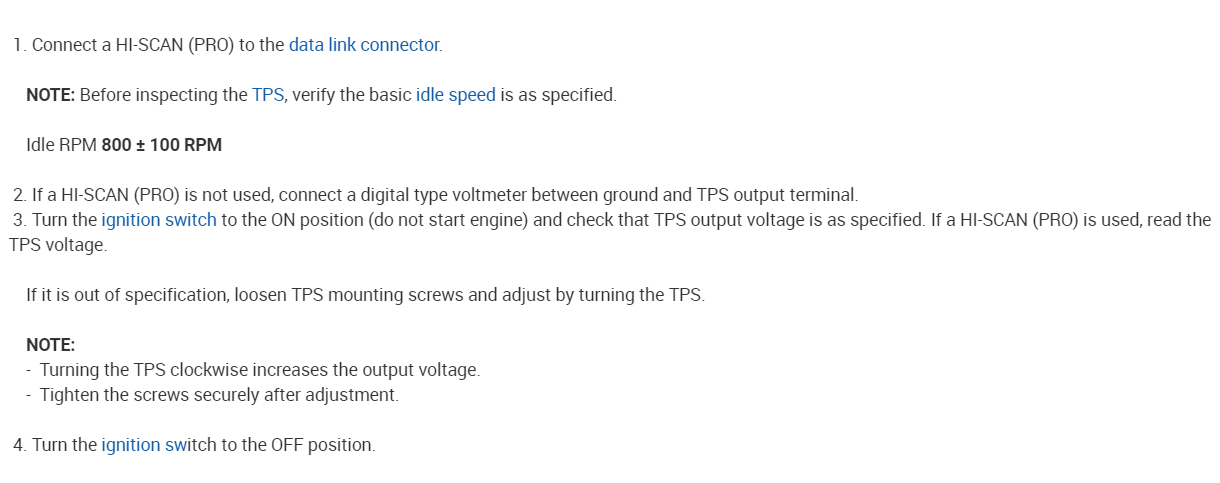

It sounds like you have a vacuum leak or the TPS is not installed correctly. Here are two guides to help us with the TPS installation instructions as well.
https://www.2carpros.com/articles/engine-idles-too-high
Use this guide when the engine is cold only:
Check out the images (below). Please let us know how it goes.
