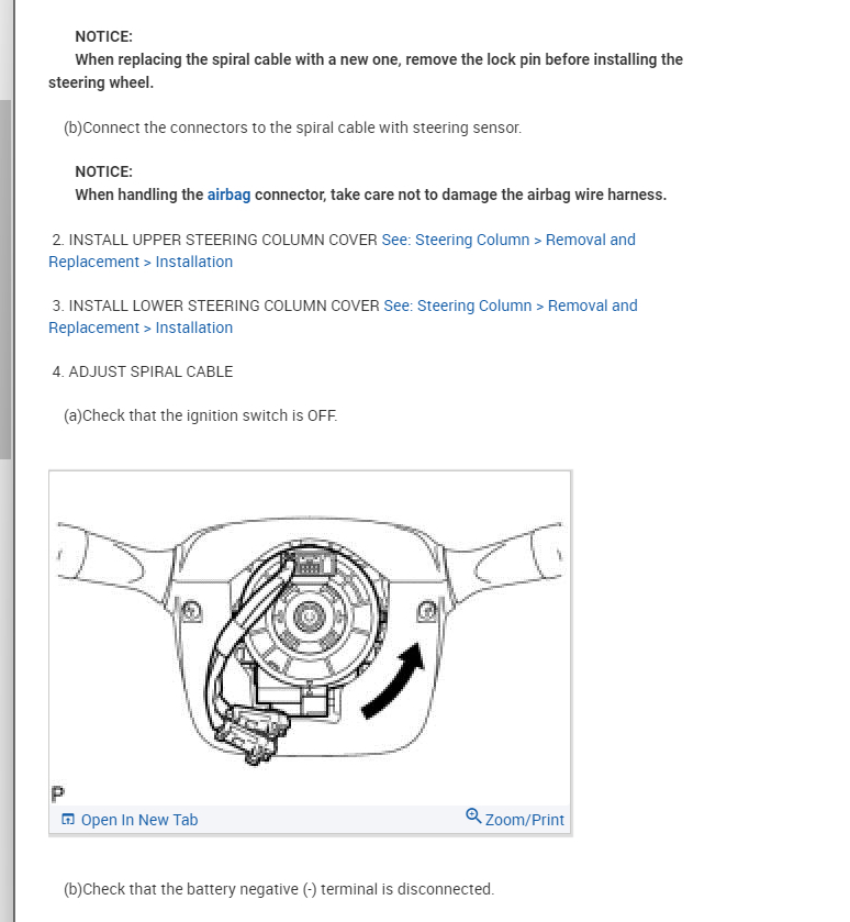

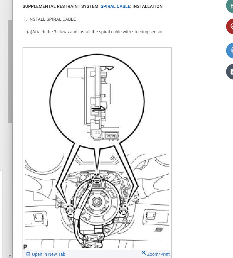

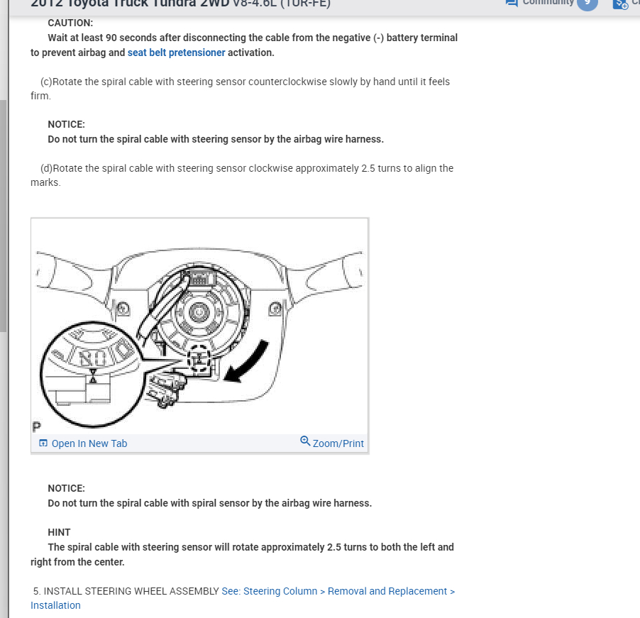

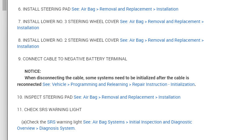

I am attaching the process below from the manual on installing the clock spring. As you will see the last step is to just check for the light. If it is on, it takes you back to the diagnostic. This means what I was stating above that there is no reset process after replacement.
Please run through this and let us know what you find. Thanks
