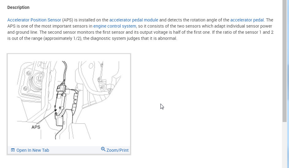

As for what the issue could be, we need to have them monitor the Accelerator position sensor while this is happening. That will tell us if there is a possible pedal issue. It could just be sticking or there could be a sensor issue.
