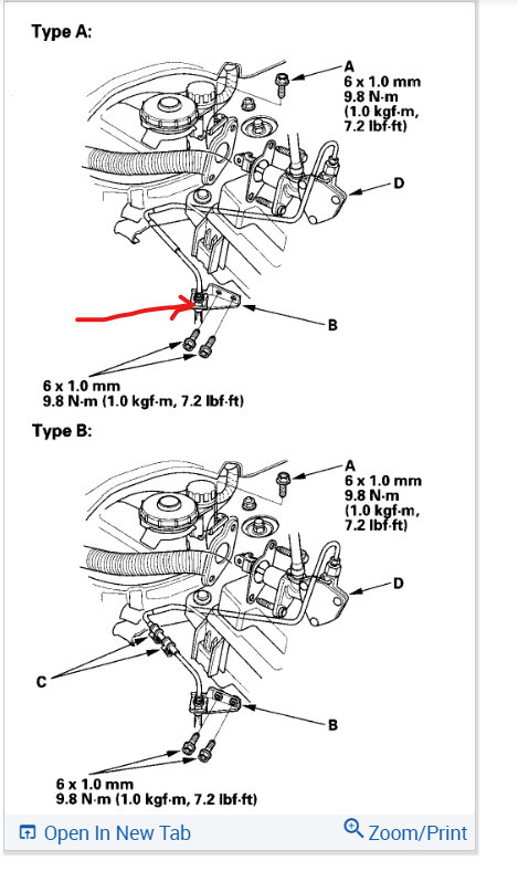

I am needing to replace clutch pipe A, a hydraulic line that connects to the clutch master cylinder. I replaced the clutch master cylinder and damaged the original pipe in the process. :-(
The clutch pipe is held to the car body by what a diagram describes as "tube clips." My question is - how can I remove these clips in a way that I don't damage them? I want to use them on the new pipe.

This is a simple clip that pulls straight off. You can use a large standard screwdriver to do the job. Check out the images (below). Please let us know if you need anything else to get the problem fixed.
