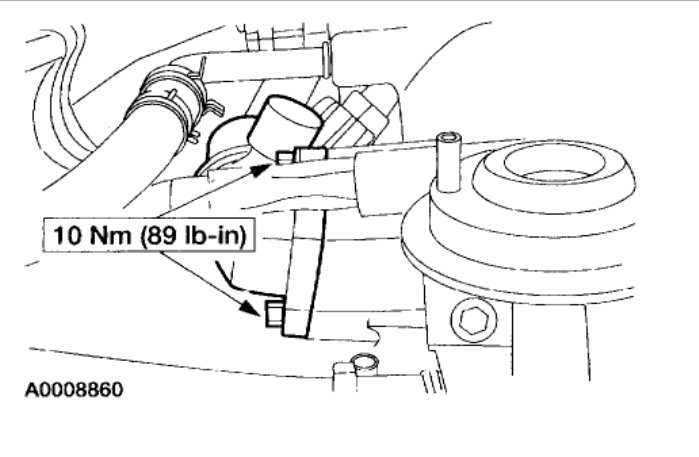

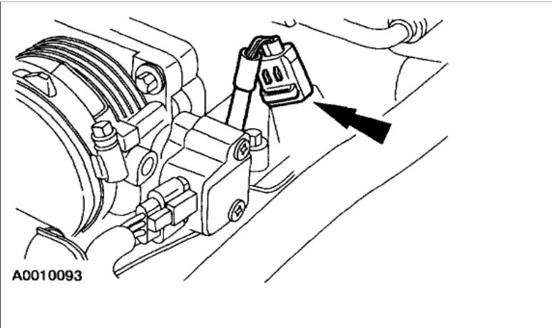

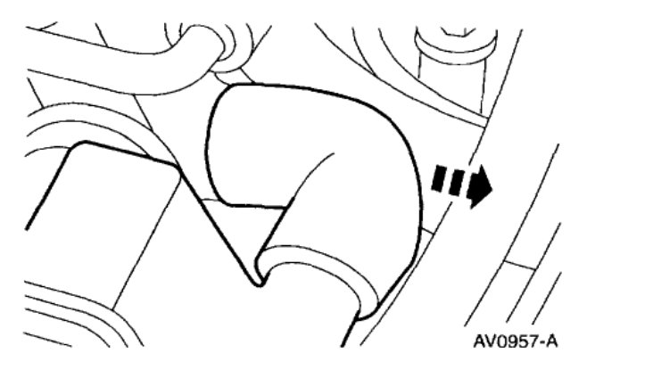

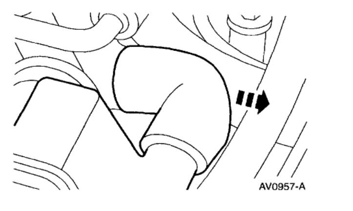

You are on the right track, but you cant clean the IAC you must replace it. The honking is caused by broken parts inside the IAC.
Here is a guide to help you get it fixed.
https://www.2carpros.com/articles/how-to-replace-an-idle-speed-control-motor-iac
Here is your car (below)
