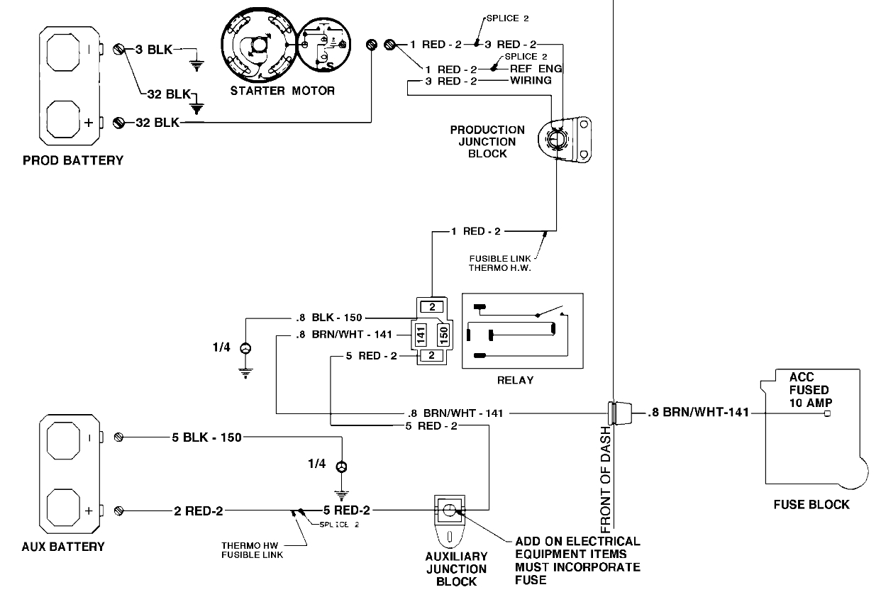

Put a rear outer tire on and new battery. When turning the key. No crank nor clicking. Turned on the lights, just the running lights. No low beams or high beams. Could it be the starter? It did start and run but that was two years. Trying to get it out of the storage yard and clean it up to sell.

Yes, it could be the starter, but I would check the main power leads coming off of the battery it sounds like one of them is corroded. Also check the fuses as well. To check if the problem is the starter, I would use a test light when the key is in the crank position to see if there is power. Here is a guide to help and the starter wiring diagrams so you can see how the system works.
https://www.2carpros.com/articles/starter-not-working-repair
Check out the images (below). Please upload pictures or videos in your response of any problems so we can see what to help you with.
