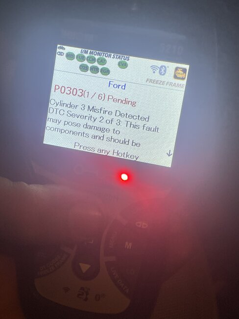

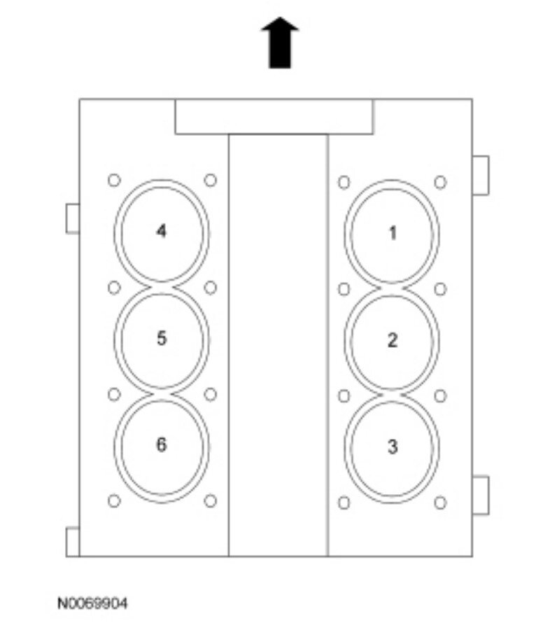

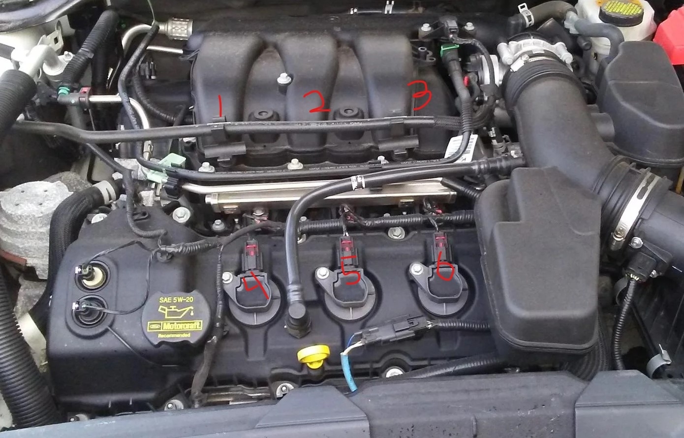

I got the P0303 code for a misfire detected in Cylinder #3. I have seen a few different diagrams which contradict each other. Is it 1,2,3 on bank 1 or 1,3,5? Any help would be greatly appreciated. About to change the spark plug for that cylinder and if still getting that code and running rough I am going to replace the coil pack.
