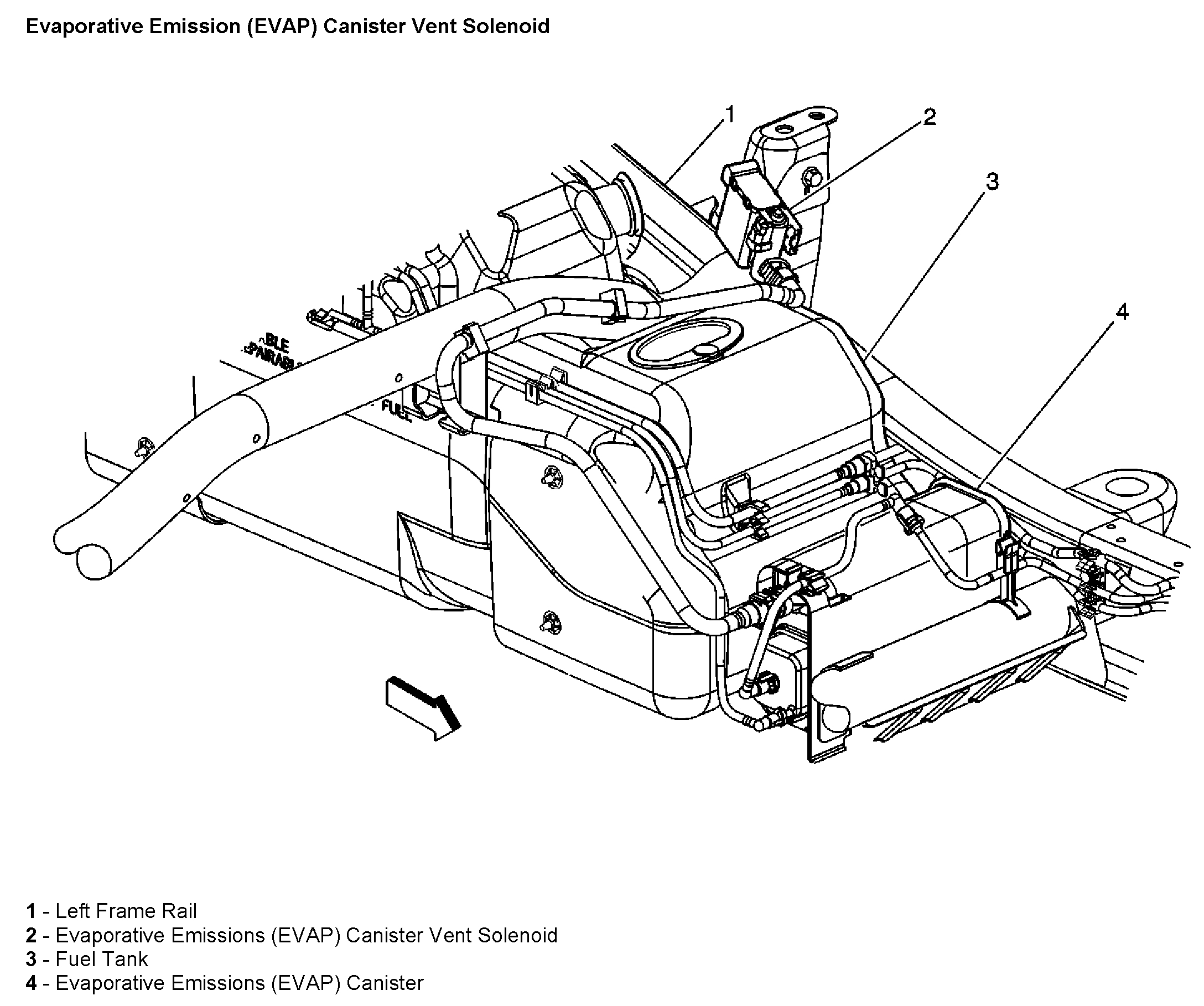

For fuel to enter the tank, air has to escape. There is a one way valve that connects the fuel tank to the EVAP Canister. It is purpose is to allow gas vapors to enter the canister instead of the air when refueling. If the vent valve is not working, it will not allow vapors to escape fast enough causing the pump to shut off. (Hence 30 cents at a time)
Since the check engine light is on, my first suspect is the vent valve solenoid. I have a feeling it is stuck in the closed position.

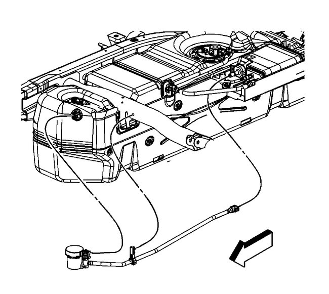

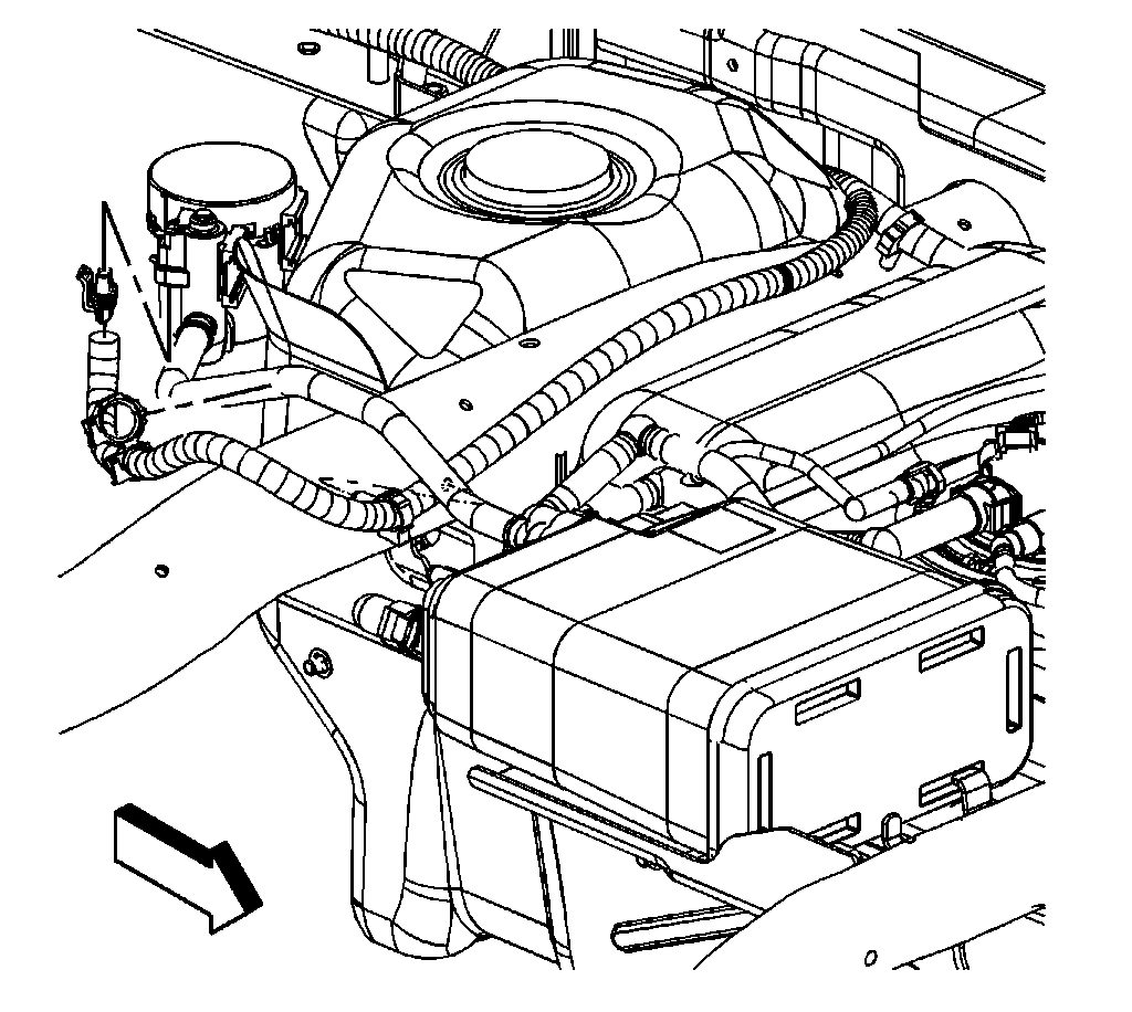

Take a look at the first two pictures I attached. They indicate the component's location. In picture 1, find component number 10. In picture 2, find component 2.

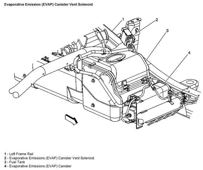

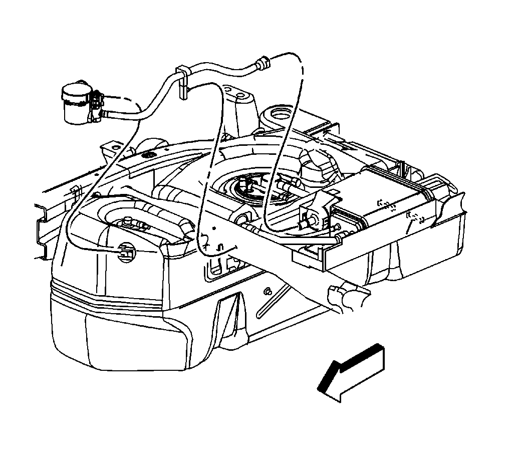

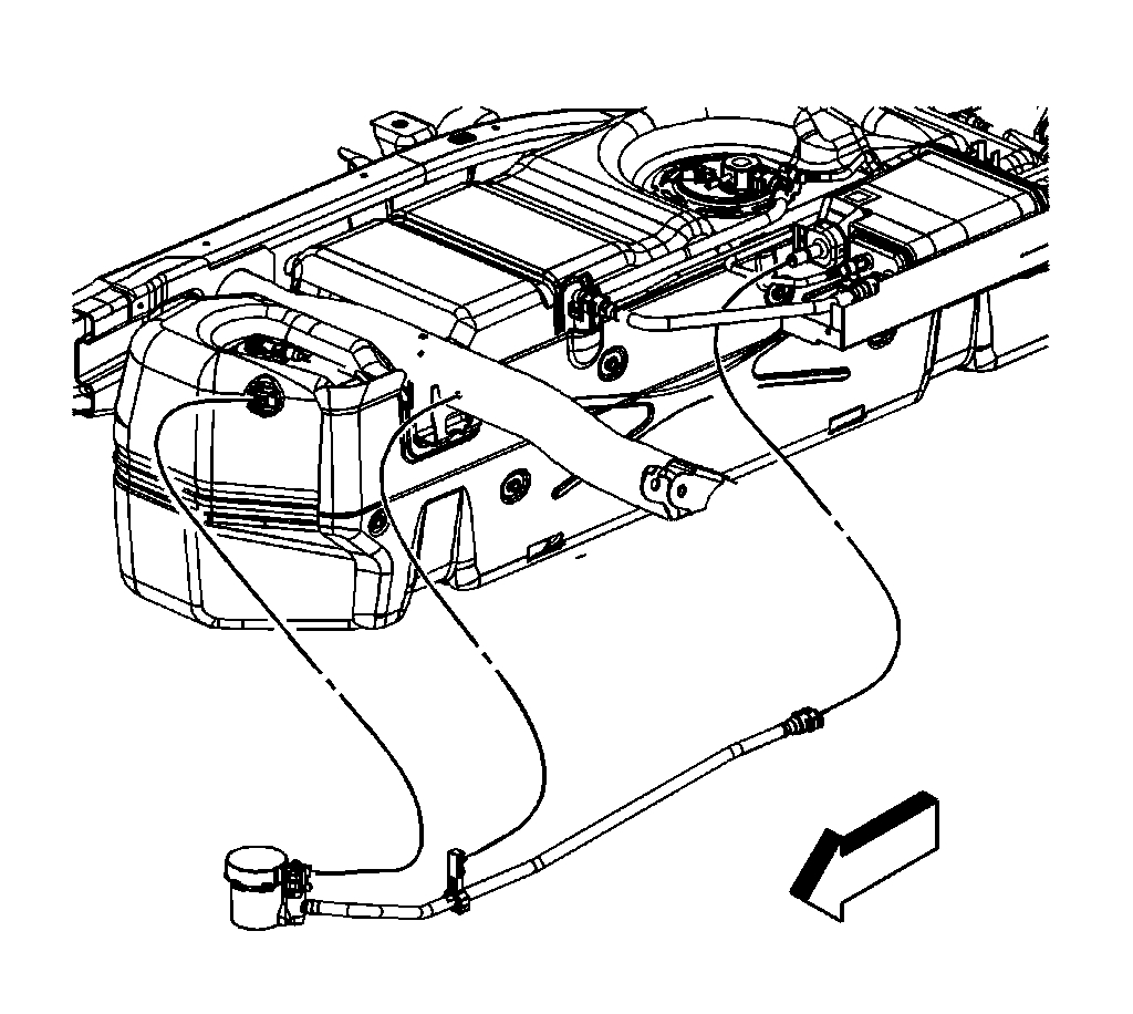

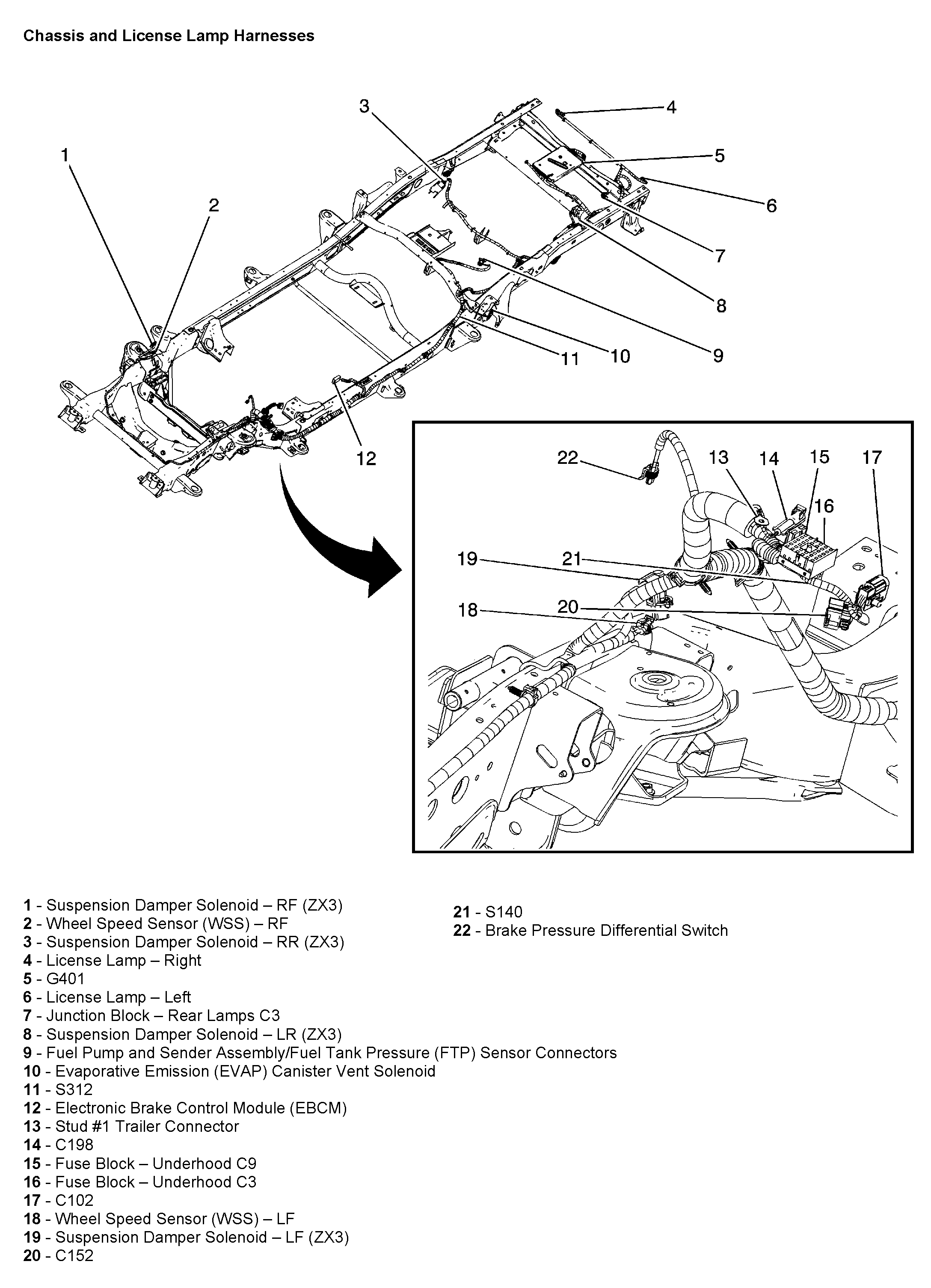

If on your own you determine this is the issue, here are the directions for replacing it. All remaining pictures correlate with these directions.
EVAP CANISTER VENT SOLENOID VALVE REPLACEMENT (PICKUP)
EVAPORATIVE EMISSION (EVAP) CANISTER VENT SOLENOID VALVE REPLACEMENT (PICKUP)
REMOVAL PROCEDURE
IMPORTANT: Clean the evaporative emission (EVAP) connections and surrounding areas prior to disconnecting the fittings in order to avoid possible system contamination.
1. Raise and suitably support the vehicle. Refer to Vehicle Lifting.
2. Remove the harness clip from the canister vent solenoid (CVS) line.
3. Disconnect the CVS electrical connector.
4. If the vehicle is equipped with a 6 ft box, disconnect the EVAP CVS line from the canister.
5. Remove the CVS clip from the frame crossmember.
6. Push in the retainer and remove the CVS from the fuel tank clip.
7. If the vehicle is equipped with a 8 ft box, disconnect the EVAP CVS line from the canister.
8. Remove the CVS clip from the frame crossmember.
9. Push in the retainer and remove the CVS from the fuel tank clip.
INSTALLATION PROCEDURE
1. If the vehicle is equipped with a 8 ft box, install the CVS to the fuel tank until the clip engages.
IMPORTANT: On vehicles equipped with a 8 ft box, the CVS line is routed below the frame crossmember.
2. Install the CVS clip to the frame crossmember.
3. Connect the EVAP CVS line to the canister.
4. If the vehicle is equipped with a 6 ft box, install the CVS to the fuel tank until the clip engages.
IMPORTANT: On vehicles equipped with a 6 ft box, the CVS line is routed above the frame crossmember.
5. Install the CVS clip to the frame crossmember.
6. Connect the EVAP CVS line to the canister.
7. Connect the CVS electrical connector.
8. Install the harness clip to the canister vent solenoid (CVS) line.
9. Lower the vehicle.
