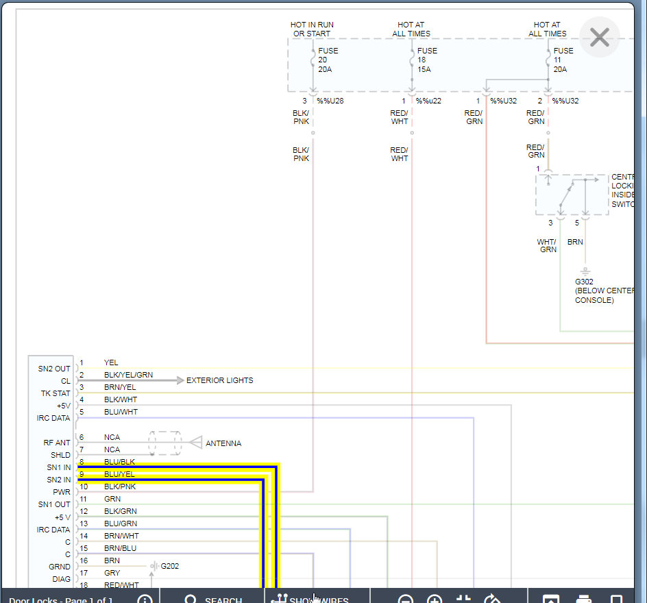

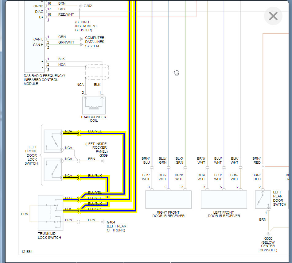

Since I got this car from my sister the remote trunk release won't work, both in the dash and the key remote.
Whenever I press the trunk release button in the dash it does not pop up the trunk. When I try the trunk release button in the key, nothing happens.
Remote Lock/unlock works though both in my 3 button key and dash button.
What i've tried so far is check the trunk release actuator and line from the actuator going the the rear seat pse pump. Everything is good no leaks.
I know it is not a big deal since you can just press the button in the trunk key slot to open the trunk but it just feels great when everything is working.
Thanks in advance.
Ramzi
