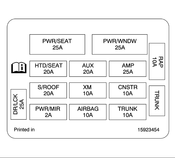

My truck release stopped working, key fob and dash board. I have it opened, by using the yellow manual release. I am trying to find the pin out for the connector on the solenoid, voltages and ground, where and when. Also , I replaced the fuse, BATT 1, but no fix. Is there a relay, and if so, where?
Jun 18, 2018 at 3:57 PM

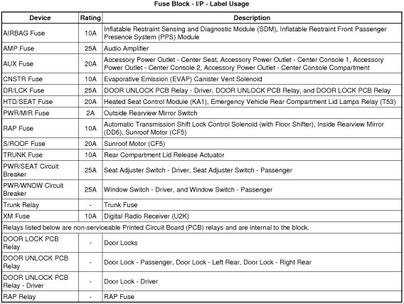

There is a fuse and relay for the trunk. They are located in the I/P fuse box on the passenger side in the carpet molding. I have attached two pictures of the box. The first picture is of the box and its components. The second is a legend of what each part is for.
Let me know if this helps.
