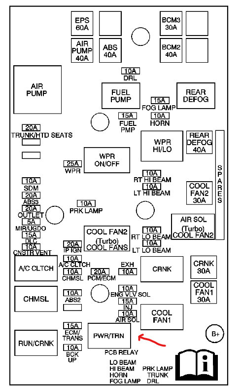

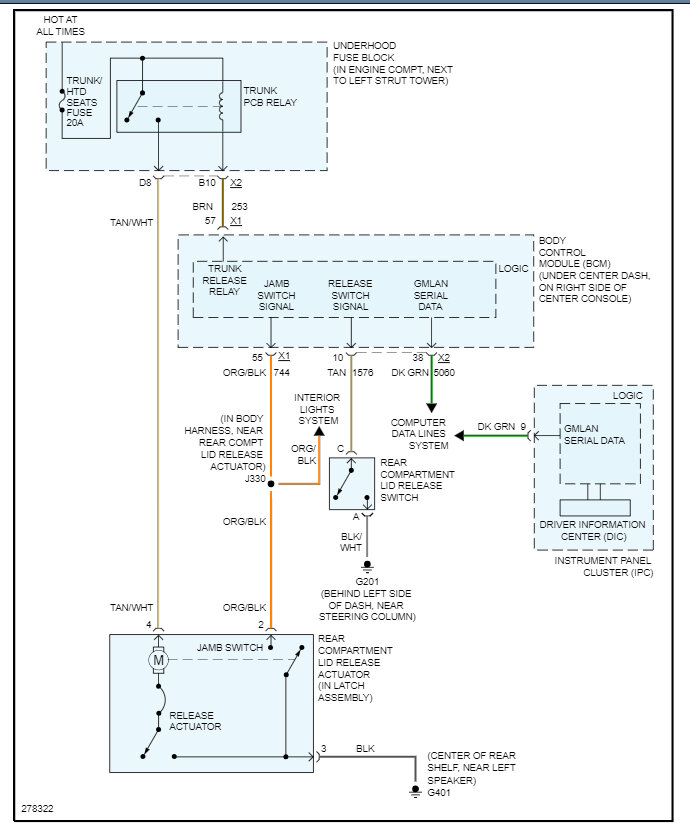

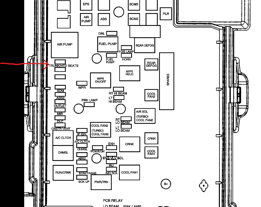

Yes, there is a fuse (trunk/heated seats) and control relay under the hood in the fuse panel on the left side near the shock tower. Here is the location of the fuse and relay so you can check them out and the trunk release wiring diagrams so you can see how the system works.
