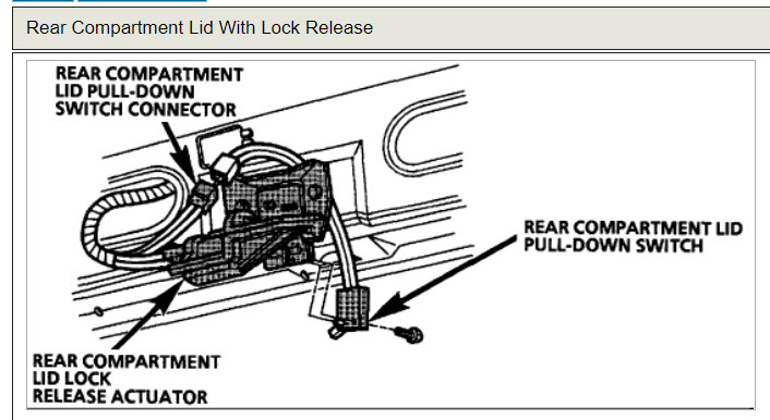

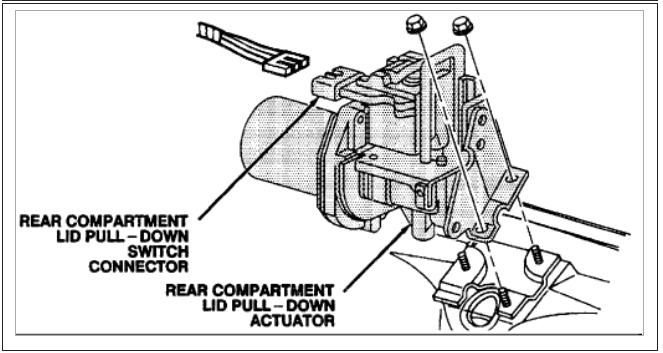

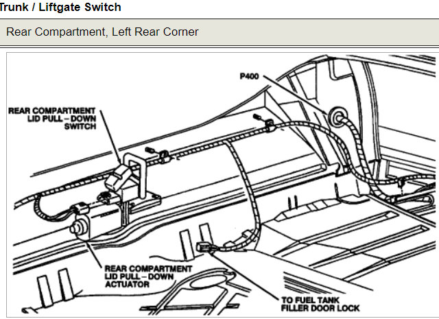

These had problems breaking mounts so check that out here are diagrams for you to take a look with.
Check out the diagrams (below).

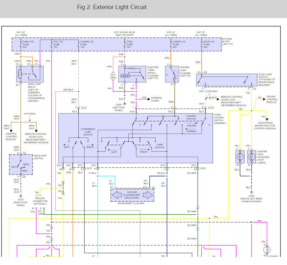

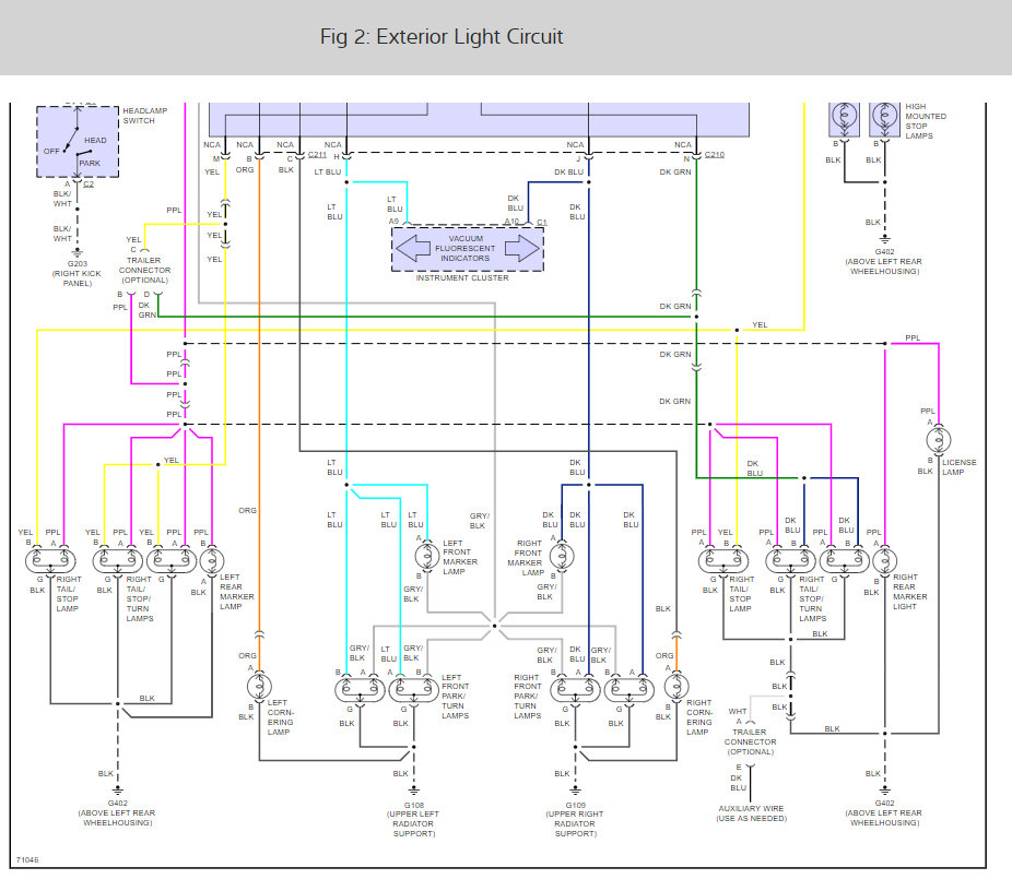

It sounds like the wiring where the trunk closes must be broken because the license plate light is tied into the running light circuit (purple wire). here is a wiring diagram so you can see how the system works.
