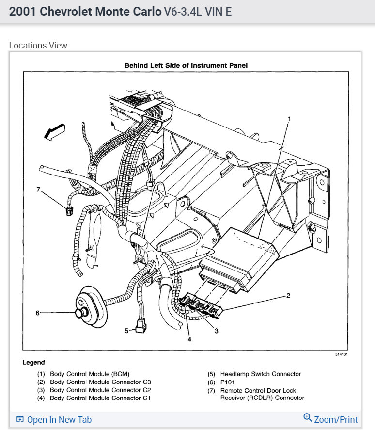

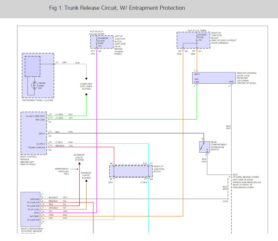

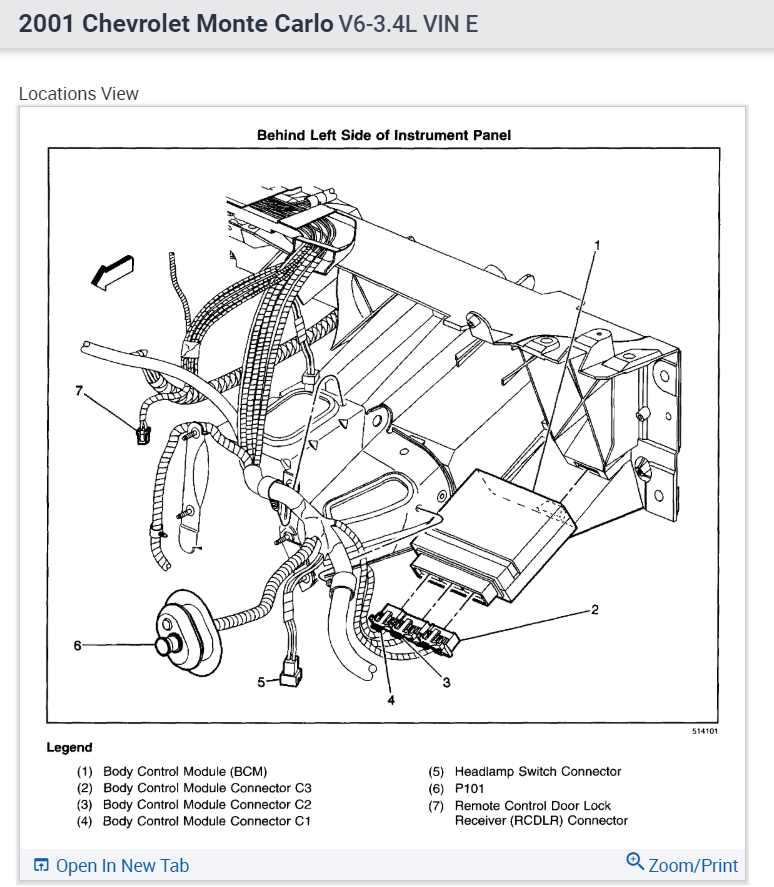

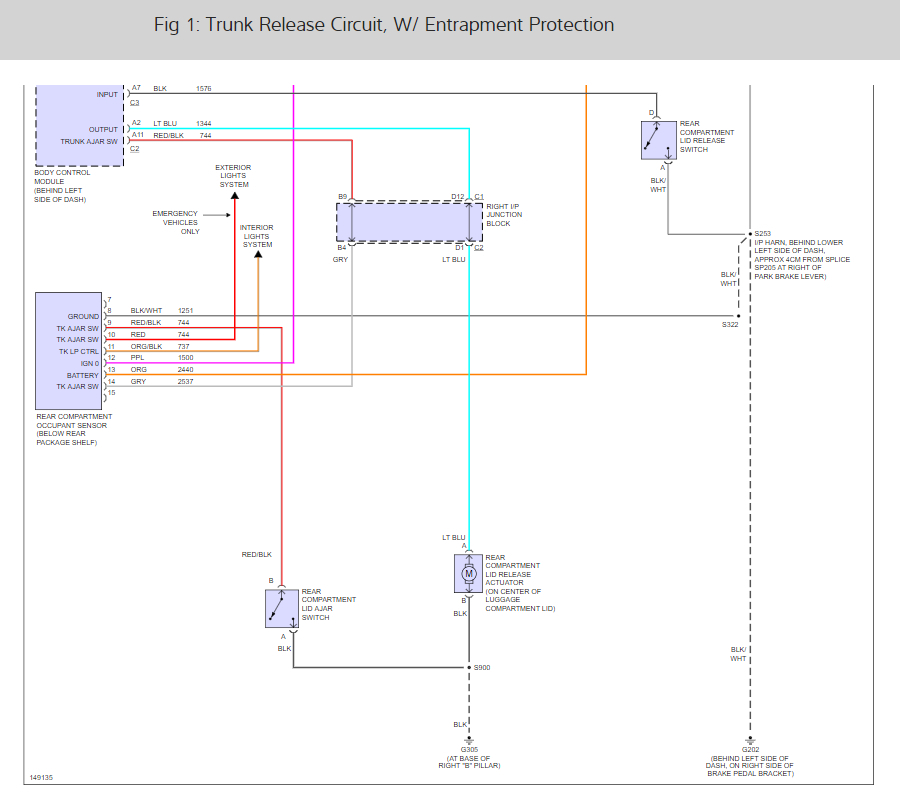

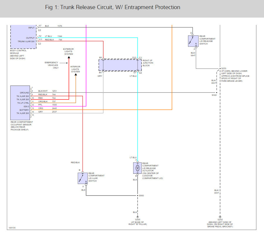

I would check the wiring to the BCM. Here is a guide and the trunk wiring diagrams. If okay it sounds like the BCM is having issues and needs to be replaced. I would try a used one here is the location. Also here are the truck wiring diagrams so you can see how the system works:
