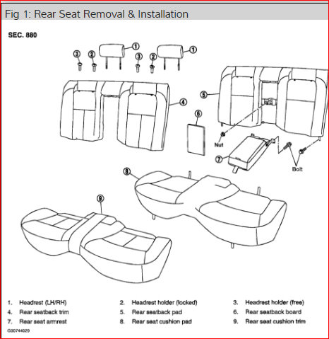

Hello, I saw your answer to replacing Infinity M trunk lift support. It is recommended removing the seat. Your friend at Infiniti has a tricky way of removing the support behind the seat. Can you tell me the trick. I have a the car listed above and I do not have all the tools or knowledge to remove and replace the seat cushion and back. Thank you.

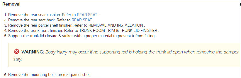

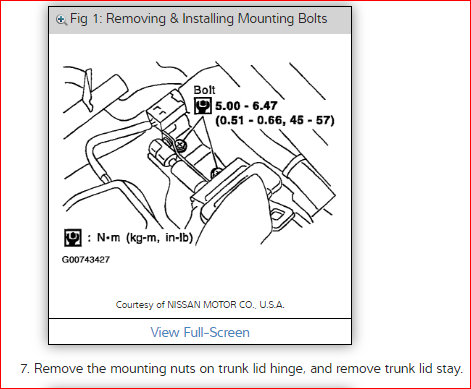

Hello, I am Danny.
I have attached a few pictures and how-to step by step instructions for you. Hope this helps and feel free to ask any questions if needed. Thanks for using 2CarPros.
