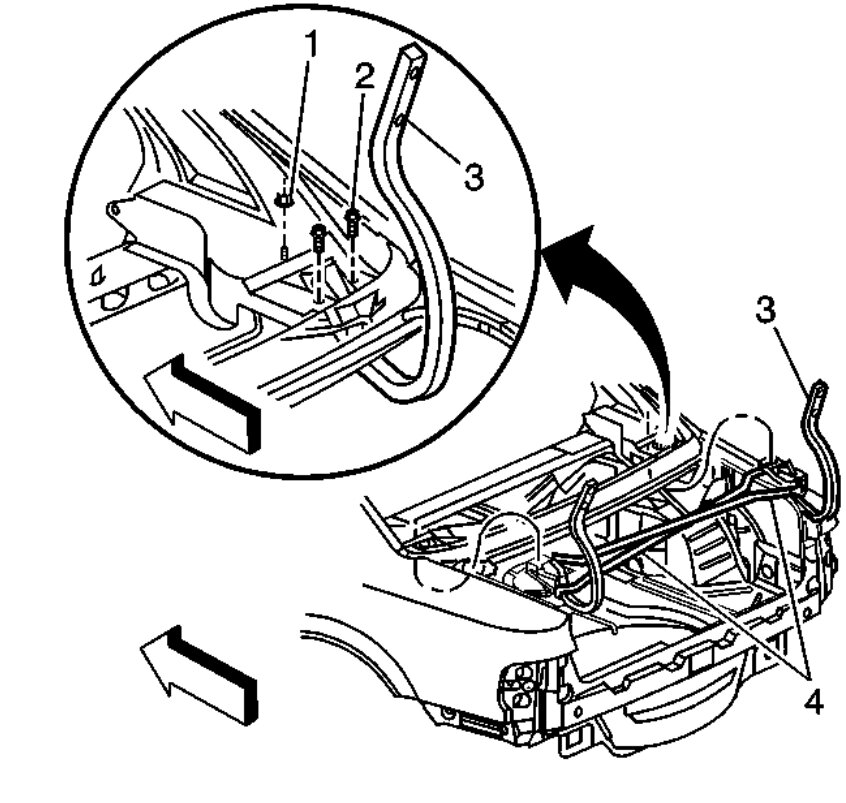

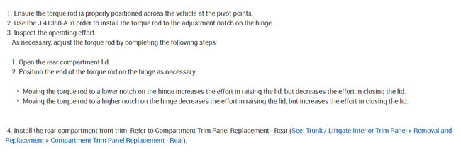

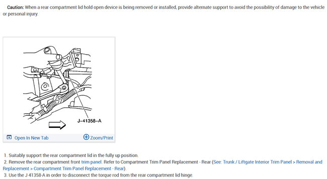

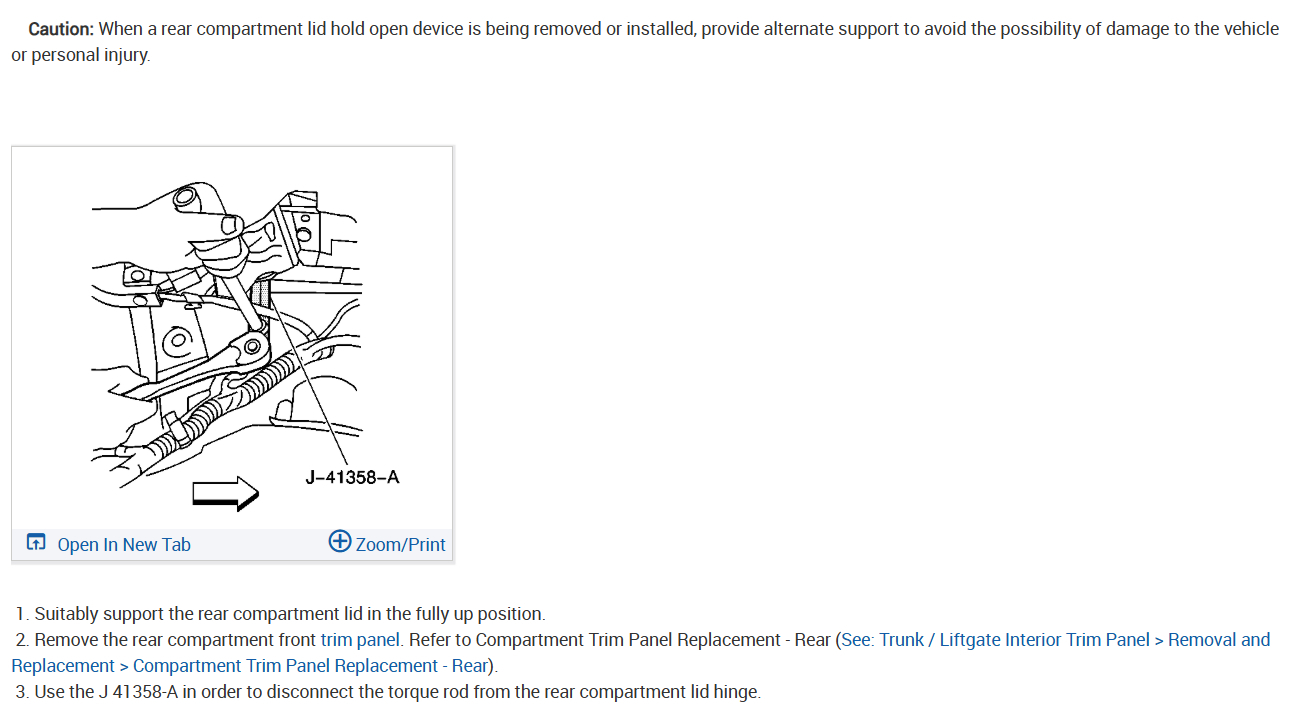

Yep, these can be tough so be careful when working on these. Here is how the trunk lift torsion bars are replaced. Check out the images (below). Please upload an image or a short video in your response
