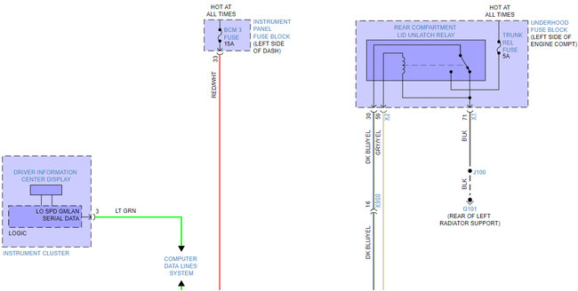

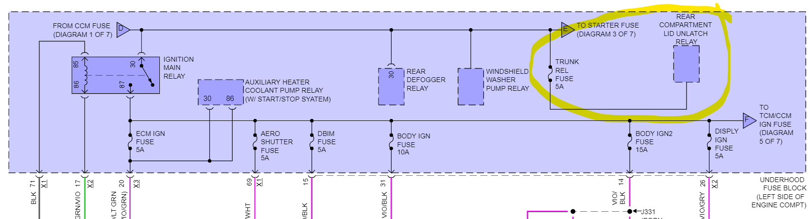

Hello, is this the "Trunk REL Fuse" 5Amp that keeps blowing? I'm assuming you are going to try to open the trunk, it doesn't open, then you notice the fuse. I would like to know if you have a fuse in there and it blows without you trying to open the trunk using the instrument panel switch. That would tell you if it could be a short on the motor circuit for the release latch or is its somewhere before the latch relay. And does this model have 2 batteries. It looks like it does.

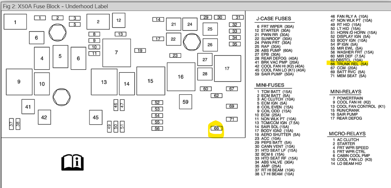

I don't think this has two batteries or not. It is a 2LT 3.6L. It is #66 in the fuse panel, and it is a 5 amp. I am not sure if it blows without me trying to open the trunk from the fob or interior. How do I check that?

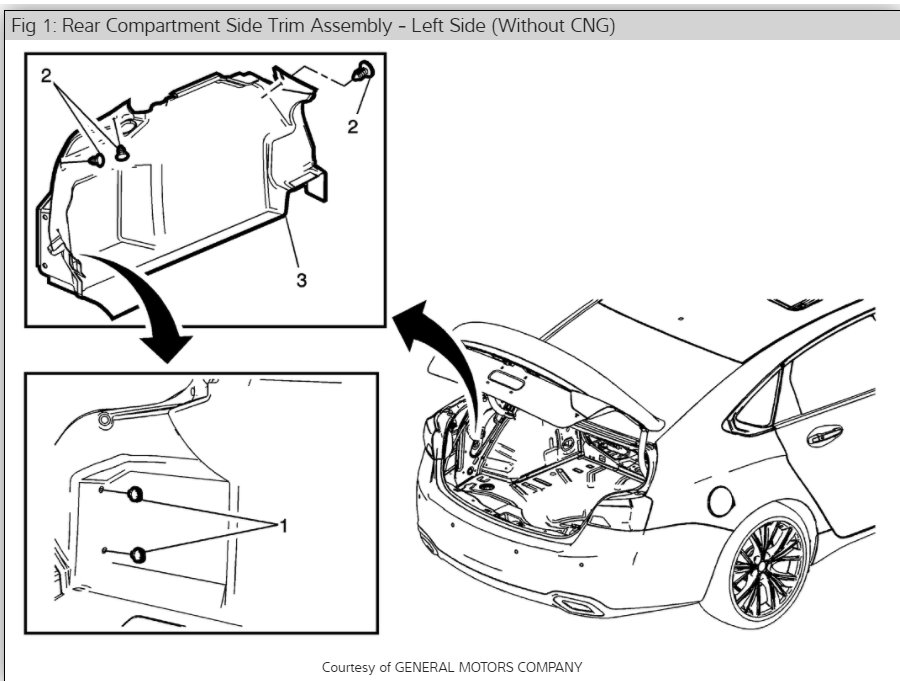

If you have a second battery it will be in the trunk behind the left-hand side (driver side) Trim panel. Not that its important right now, buts it's good to know if you do have one in case of future issues. The wiring diagram is saying it might have one. There's a lot of different changes depending on the different model/sub models.

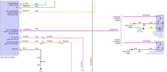

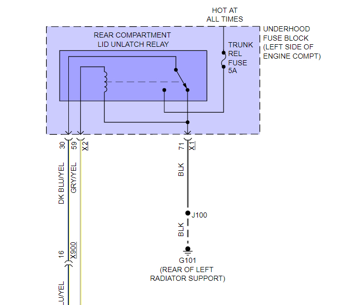

If the fuse does blow without you attempting to open the trunk, then it's a short somewhere from the battery to the Trunk unlatch Relay because without activating the relay, that's where the circuit ends. as in the diagram. That would mean that the short is in the engine compartment somewhere because that Relay is in the Under-hood Fuse Block.
If you come back from your test drive and take the fuse out, which will be easiest for you to do, and it's not blown. Put it back in and try to open the trunk with the interior switch. We'll see if that blows the fuse.

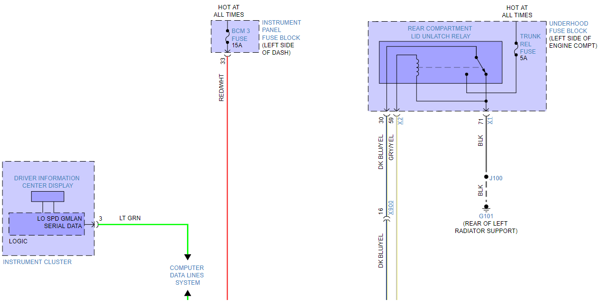

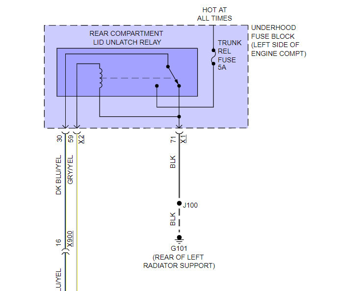

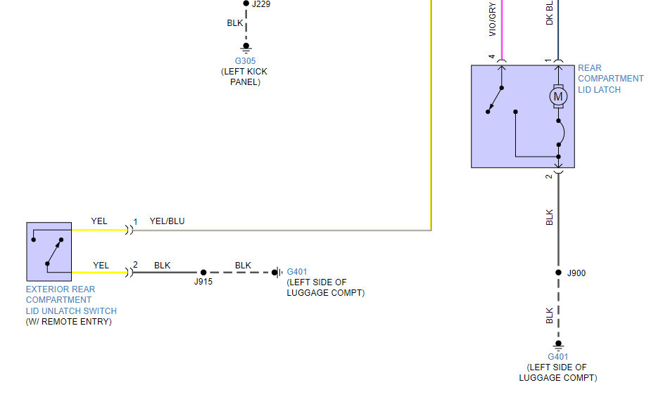

Just added a diagram showing the end of the circuit.
