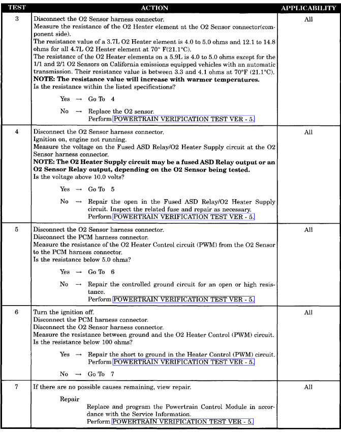

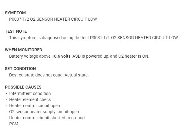

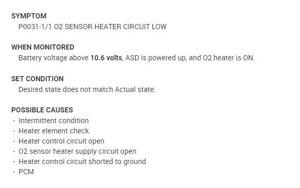

Both of those codes are Oxygen sensor codes. It's likely due to getting the harness wet.
