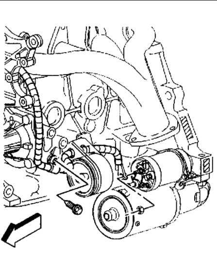

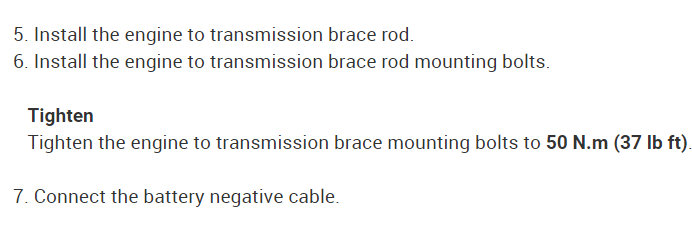

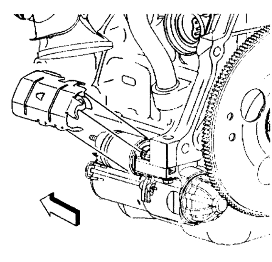

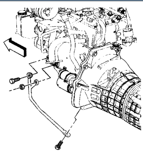

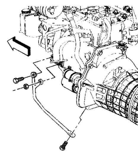

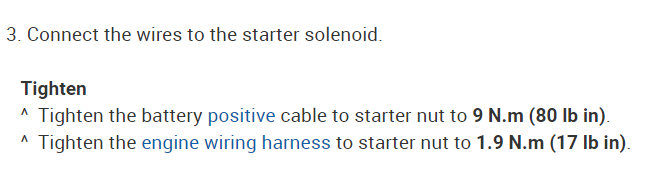

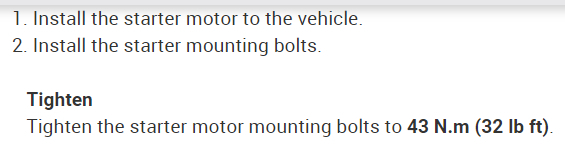

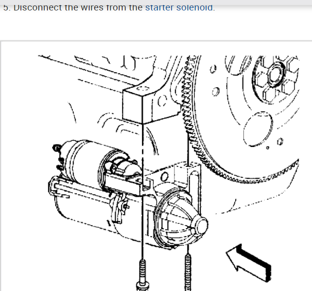

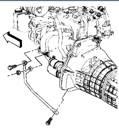

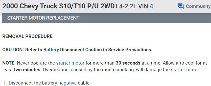

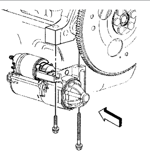

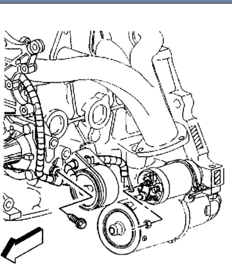

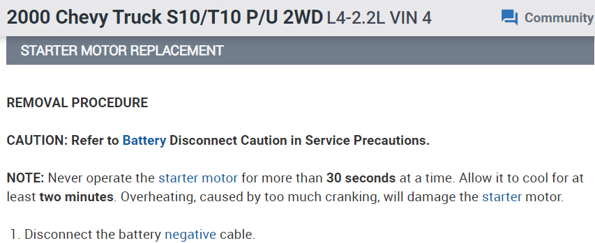

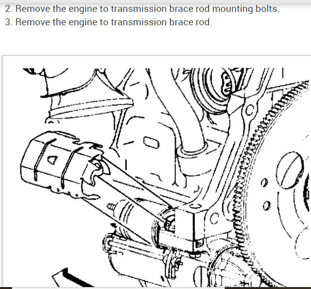

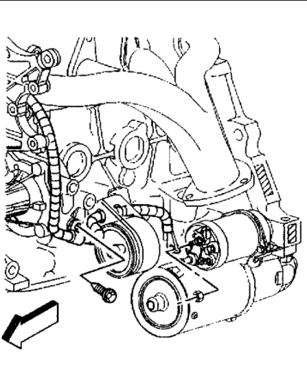

It sounds like the starter motor solenoid on the starter motor has failed. Once you remove the starter motor from your truck you can take it to any local auto parts store and they will test it for free. Here is a tutorial showing how to remove and replace a starter motor:
I've attached picture steps below on starter motor replacement for your truck. Hope this helps and thanks for using 2CarPros.
