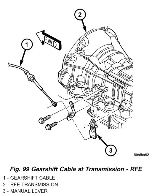

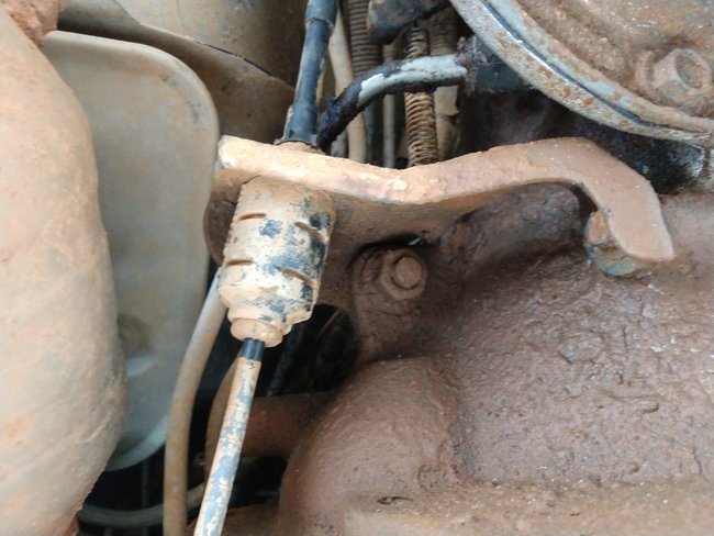

Since it was stuck in a ditch, my fist suspect is the shifter cable was damage or the shift lever was bent. What I am going to provide are the directions for replacing the shifter cable that runs from in the truck to the transmission. However, before you replace it, secure the vehicle so it is safe to crawl under it and check the cable, the mount (which is easy to bend) and the lever. If you look at the first picture in the directions, it shows all three. My guess is that the mount that holds the cable has been bent. The result is the cable doesn't retract far enough to actually reach park. Do this first.

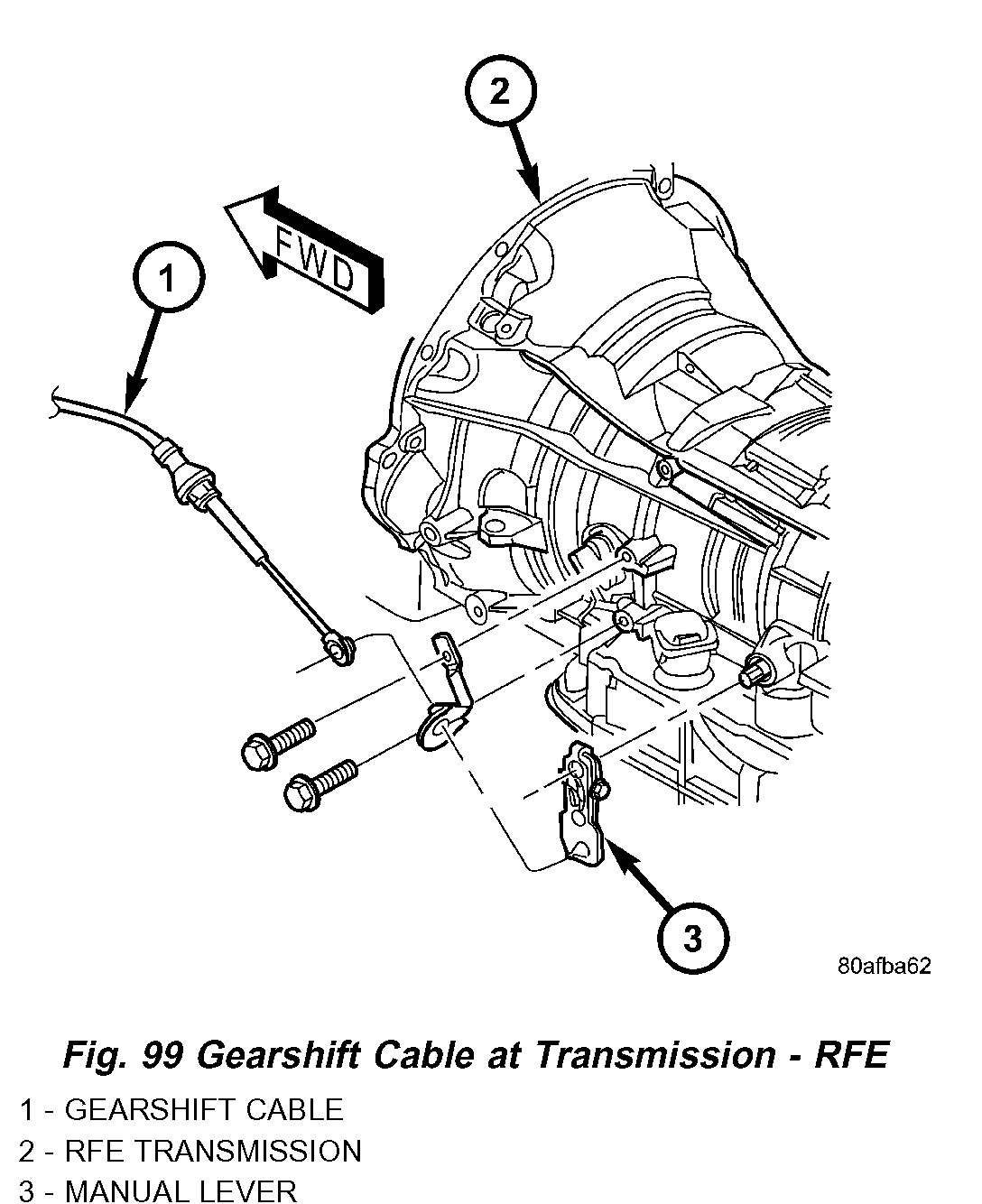

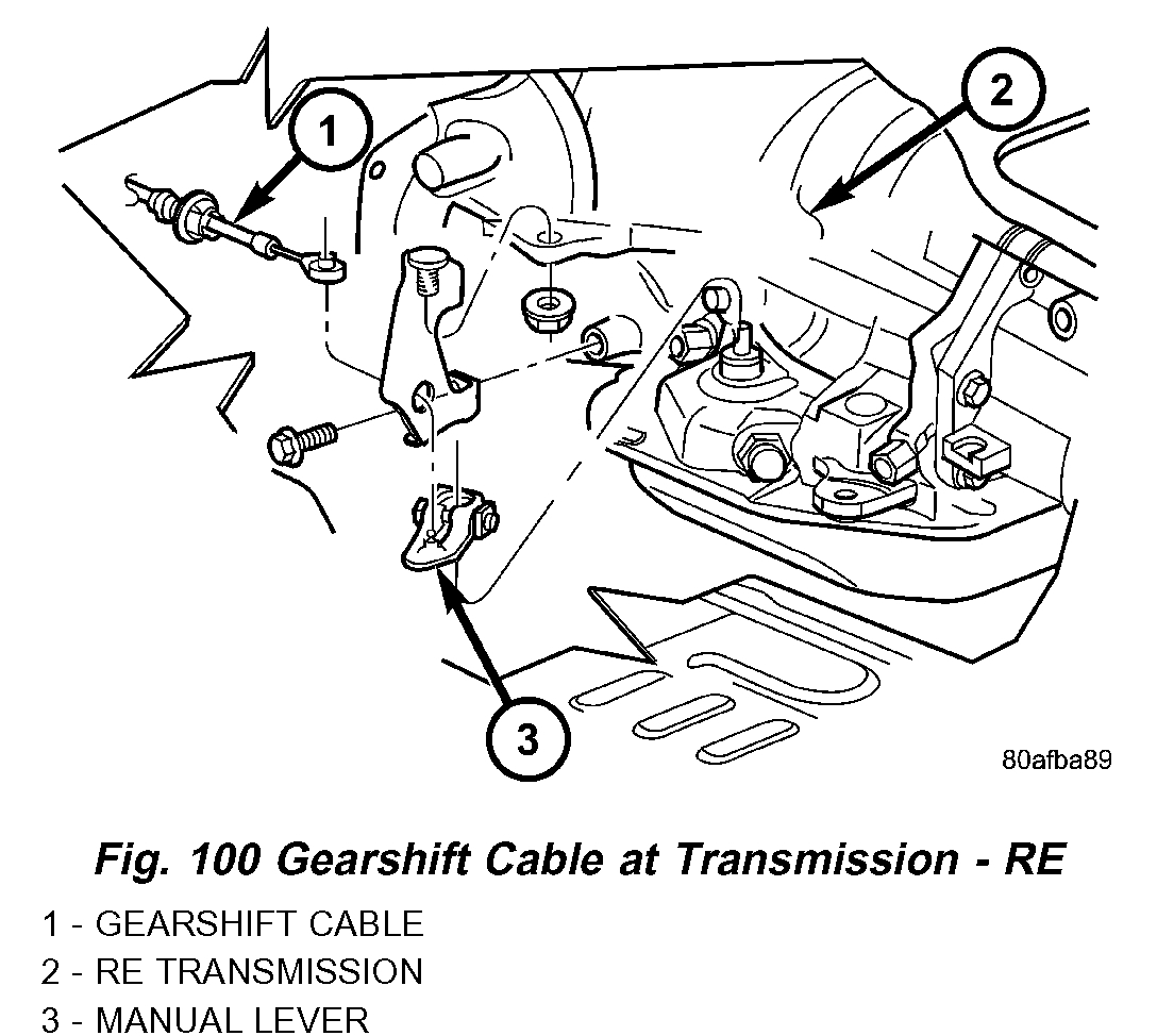

3. Disengage cable eyelet at transmission shift lever and pull cable adjuster out of mounting bracket (Fig. 99) or (Fig. 100).

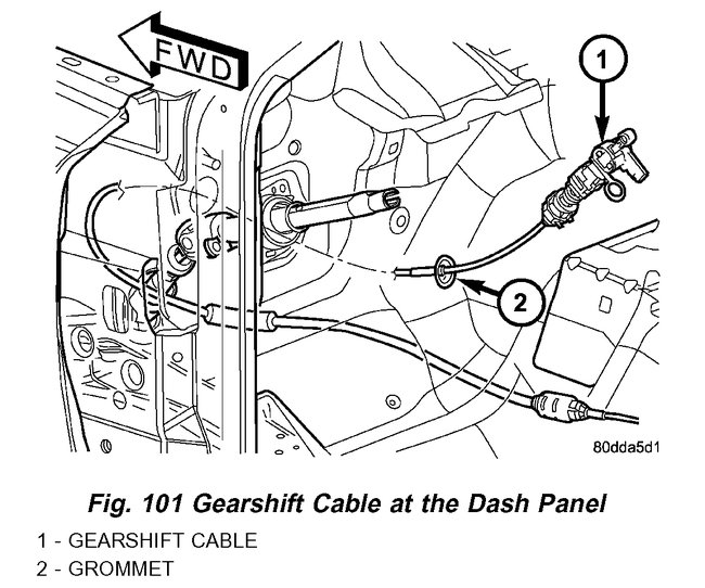

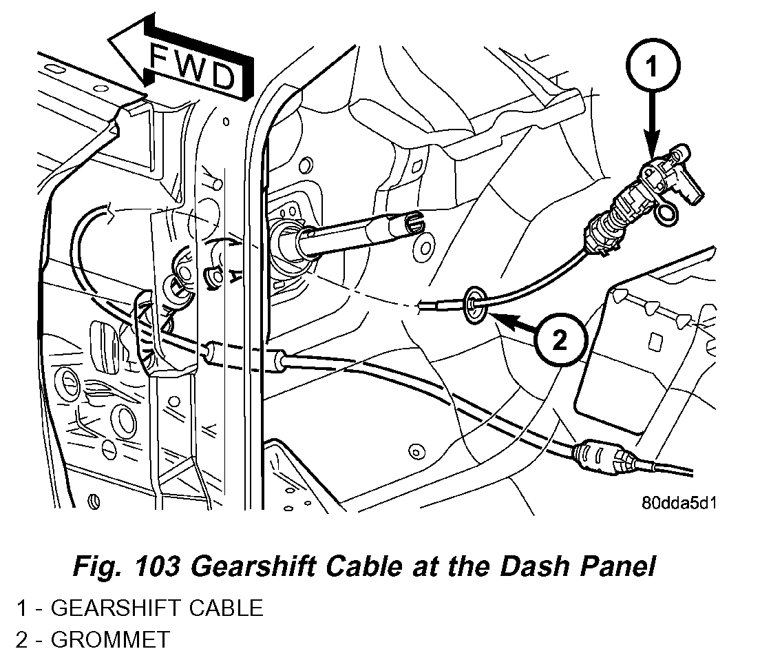

5. Remove the dash panel insulation pad as necessary to access the gearshift cable grommet (Fig. 101).
6. Remove grommet from the dash panel.

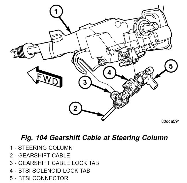

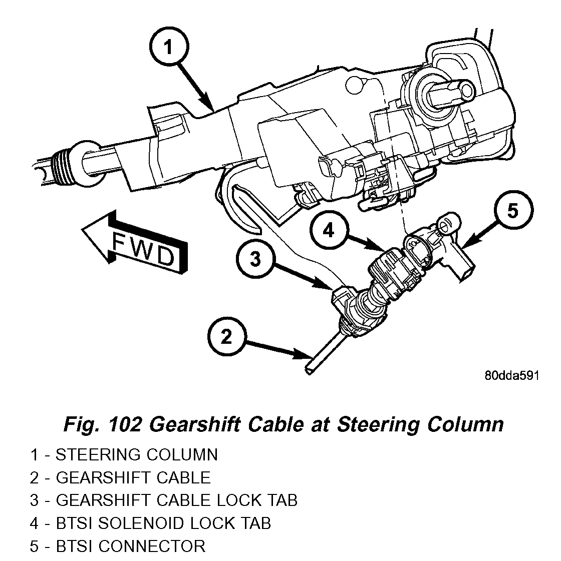

9. Disconnect cable at lower column bracket and shift lever pin and pull the cable through the dash panel opening into the vehicle (Fig. 102).

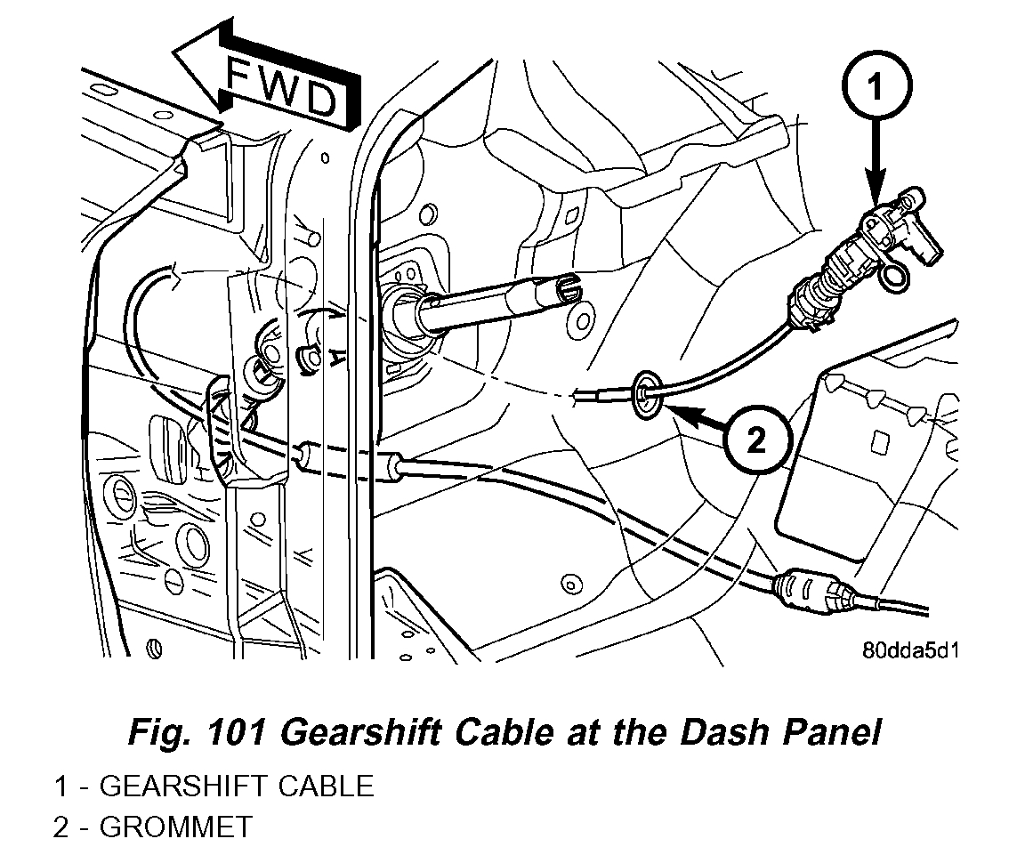

1. Route the transmission end of the gearshift cable through the opening in the dash panel (Fig. 103).
2. Seat the cable grommet into the dash panel opening.

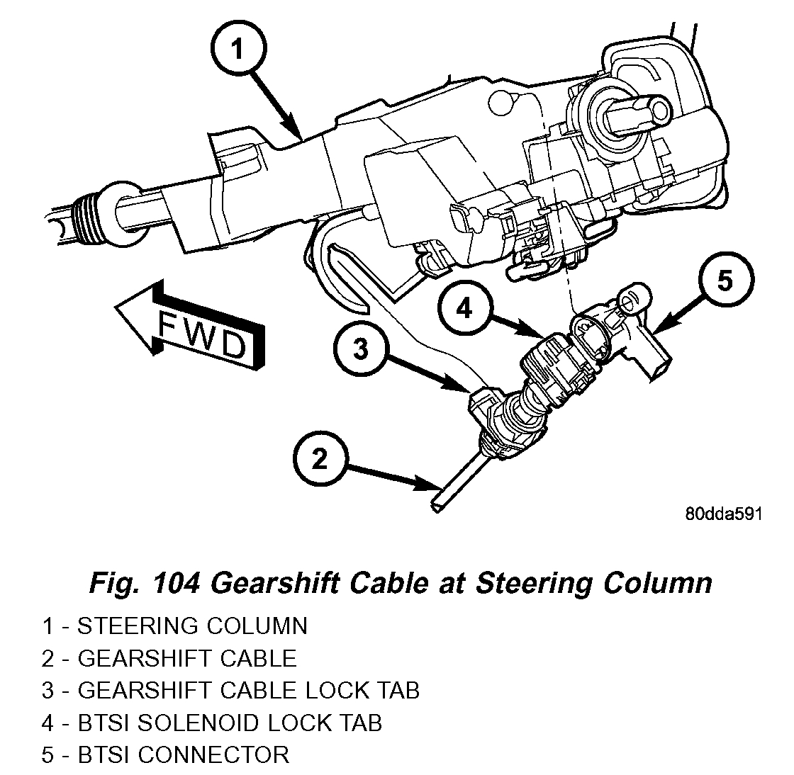

3. Snap the cable into the steering column bracket so the retaining ears (Fig. 104) are engaged and snap the cable eyelet onto the shift lever ball stud.
