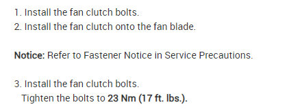

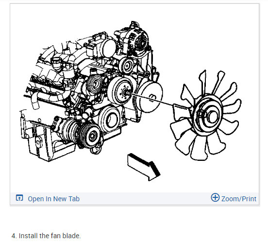

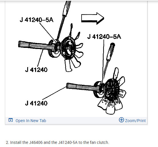

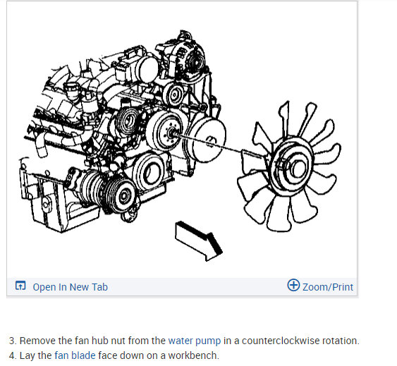

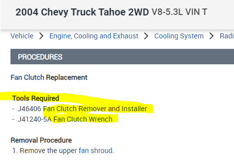

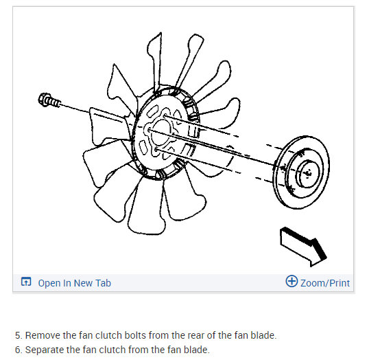

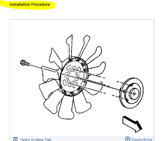

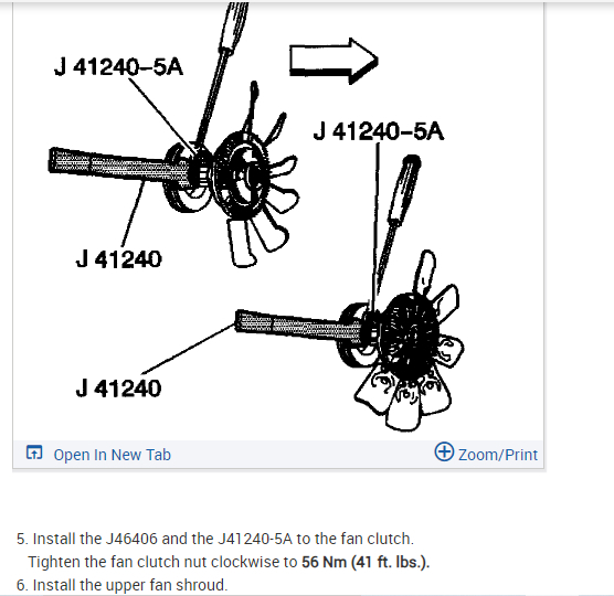

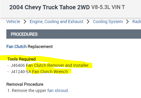

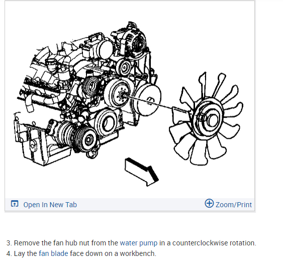

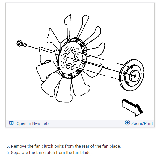

If you look below, I attached the directions for replacing one. You will need a few simple tools specifically designed for the procedure, but most parts stores, such as AutoZone will lend you what is needed.
Take a look through the directions and let me know if you are comfortable performing the job or if you have other questions.
See pics below.
