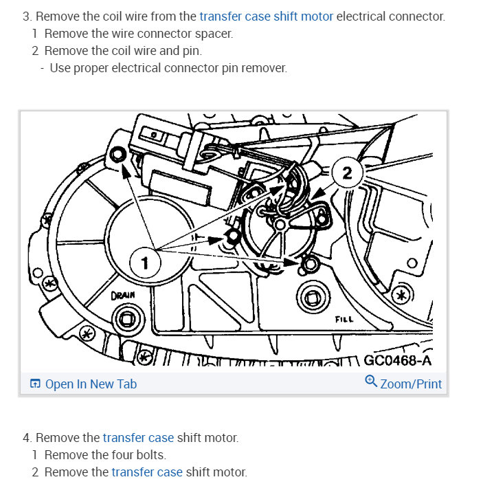

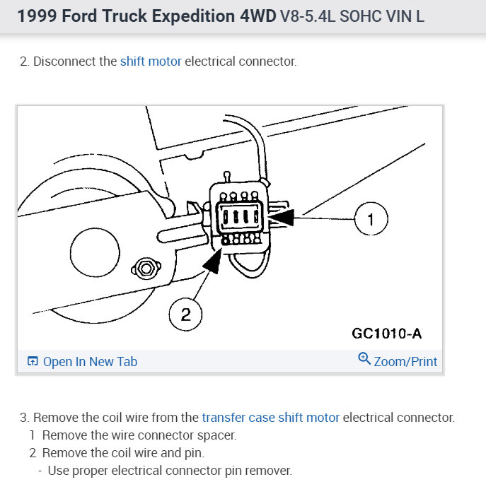

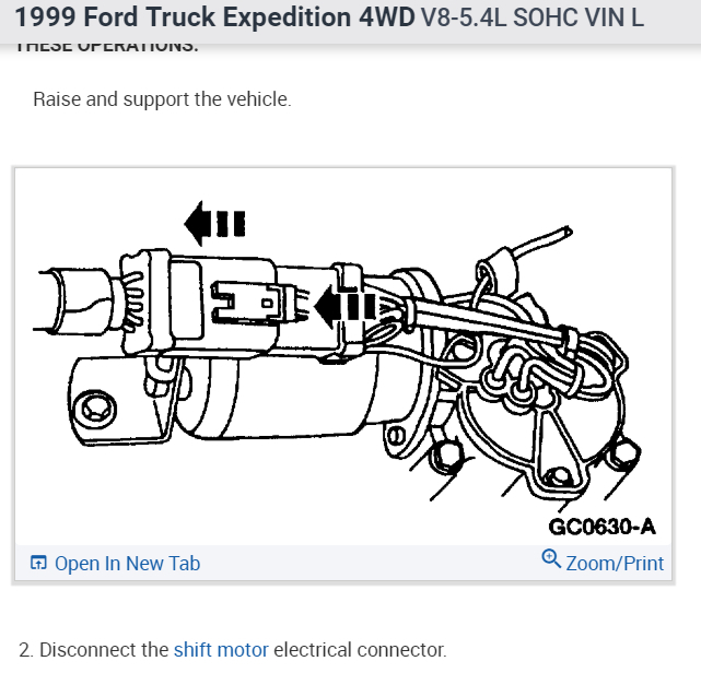

It sounds like the encoder motor is seized up not tracking correctly. Here is a diagrams so you can remove the motor to see if it is working correctly. Please check it out and get back to me.

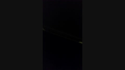

I removed the shift motor and the transfer case was already on 2 hi and the video is the shift motor switching AWD to 4 HI to 4 LO back to 4 HI to AWD.
Apr 9, 2019 at 3:56 AM
Thanks for the video, yes that seems to be working fine, can you tell where the noise is coming from?
