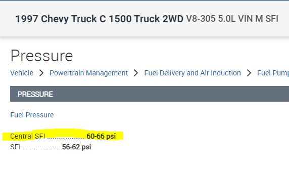

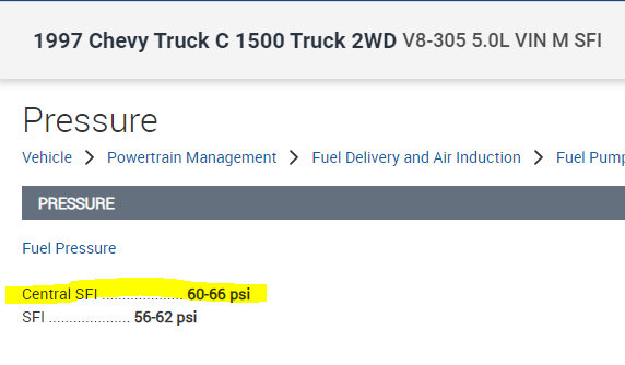

I wouldn't be surprised if it had more than one problem. For one thing he says the fuel pressure is low. Sometimes when on for quite a while it goes down to 40-45 PSI and it's supposed to be 60-66 PSI. But he has got it to stall out by leaving it on for fairly long periods of time but when it stalls it stalls out fast and he doesn't think that would happen from low fuel pressure. He says if it was stalling because of the fuel pressure it would stall more like when you run out of gas; not like if you just turned the key off.
