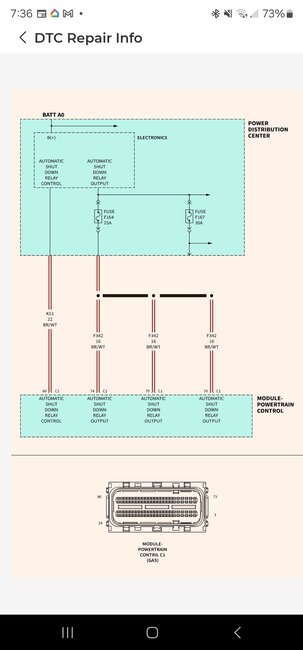

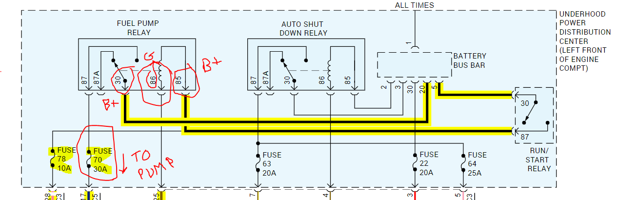

If the ASD checks good, we need to check a couple of fuses and the pump relay.
If you look below, I attached a pic from the schematic. Check fuses 70 and 78 in the underhood fuse box. If they are good, remove the relay and locate connector pins 85 and 30 for the relay. Connector 85 should have power when the run start relay is closed. Check if that is the case.
Pin 30 should have B+ at all times. Confirm that as well. If they both get power, then I need you to jump connector pins 30 and 87 of the fuel pump relay to see if the pump turns on. If it does, then we likely lost ground at connector 86 which is provided via the PCM. If it doesn't turn on, we need to check if there is power at the pump when these are jumped.

See pic below.
