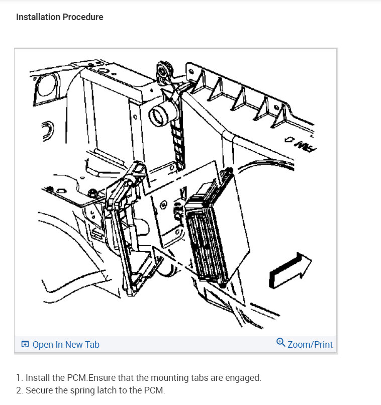

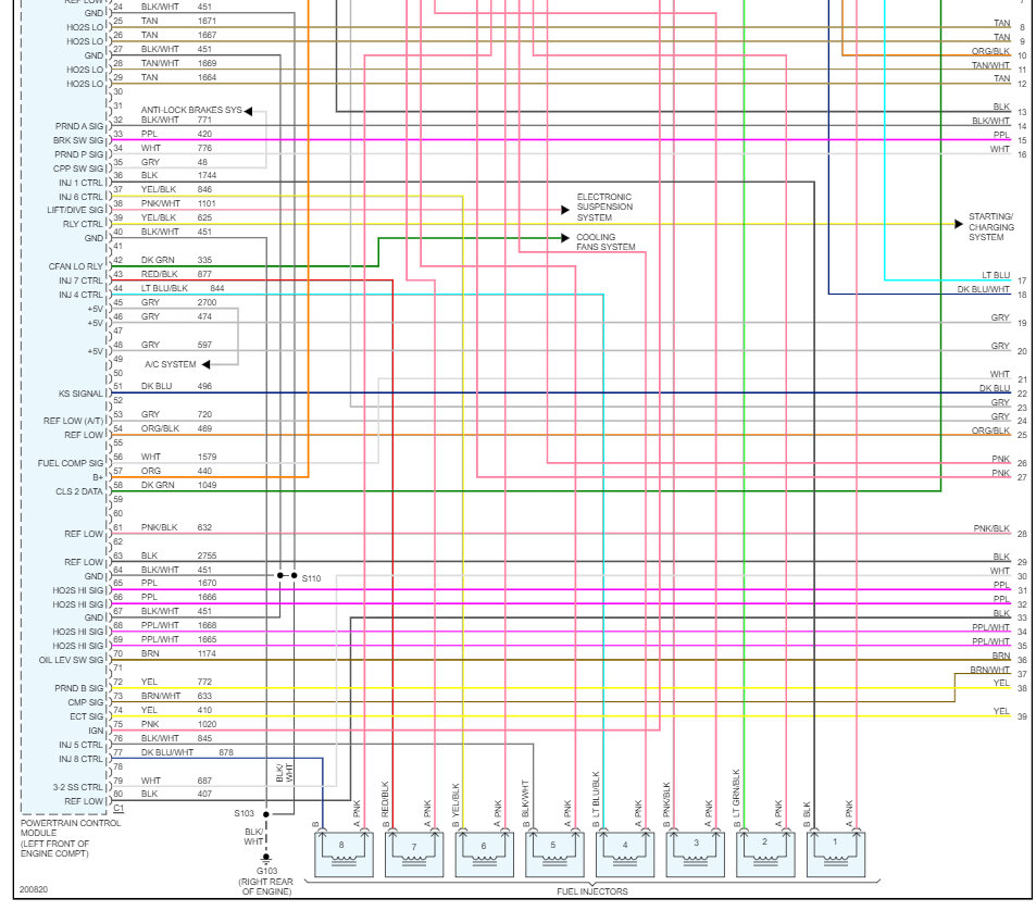

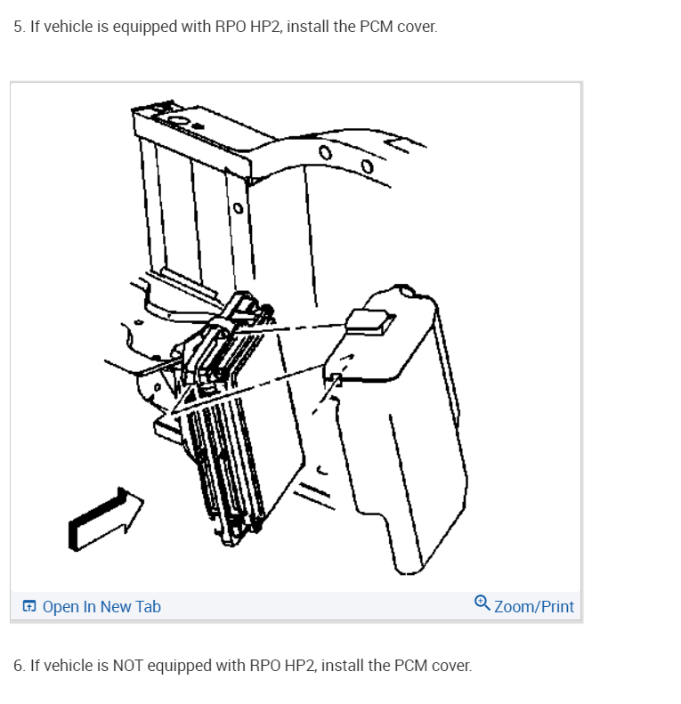

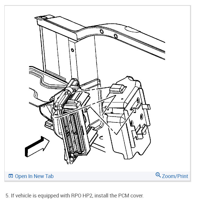

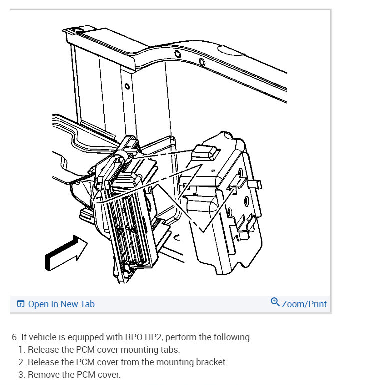

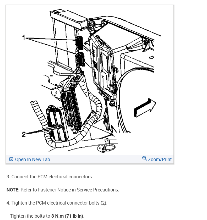

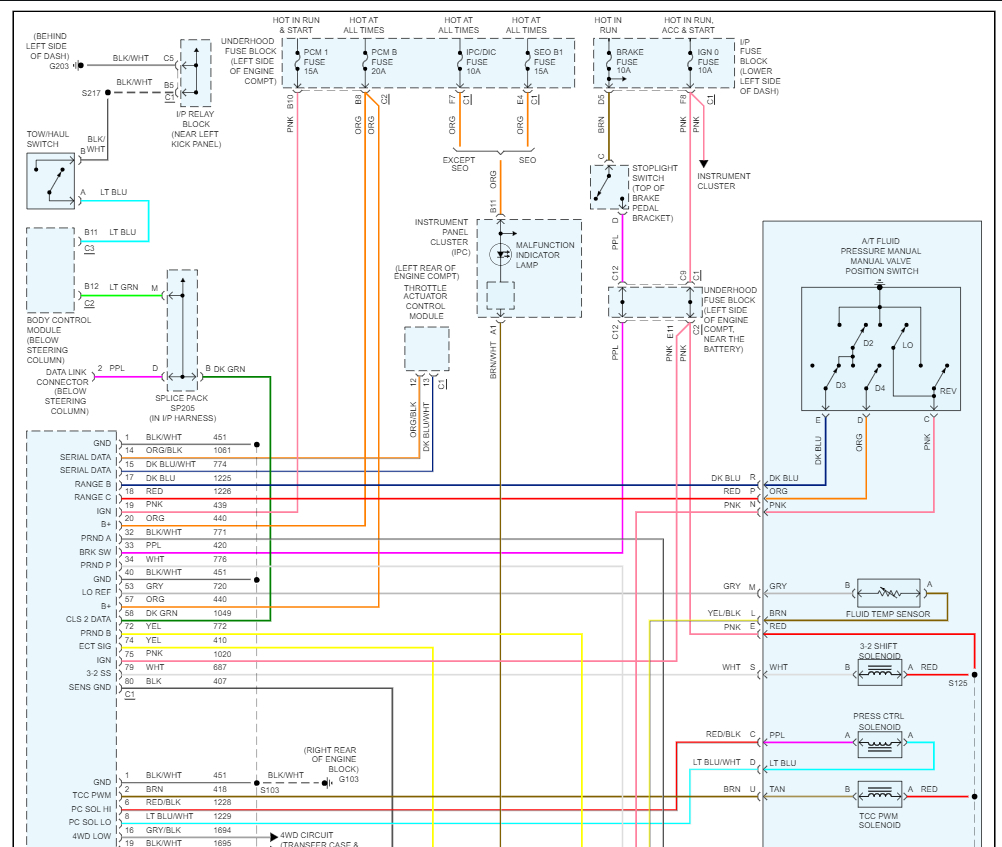

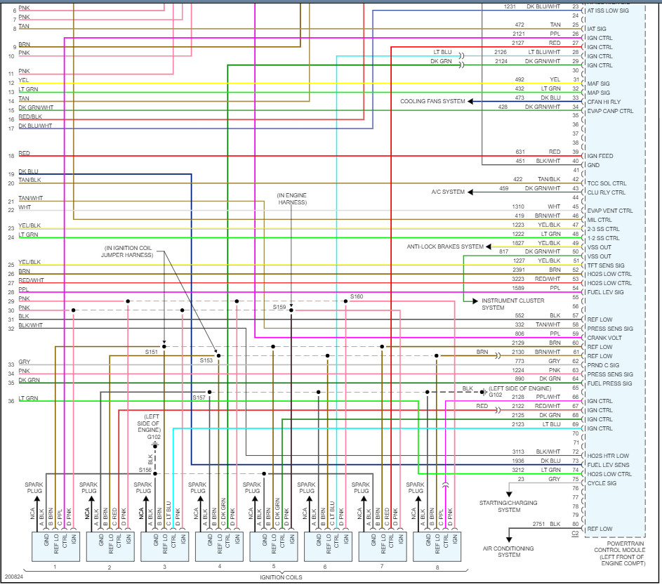

I would start by checking the power and grounds to the PCM which this code is pointing to. Also, you can send the PCM in for testing because it sounds bad, the fact you can reset the system and it works for a while is a classic sign the PCM is bad.
The U0107 error code communication problem between the Engine Control Module (ECM) and the Transmission Control Module (TCM).

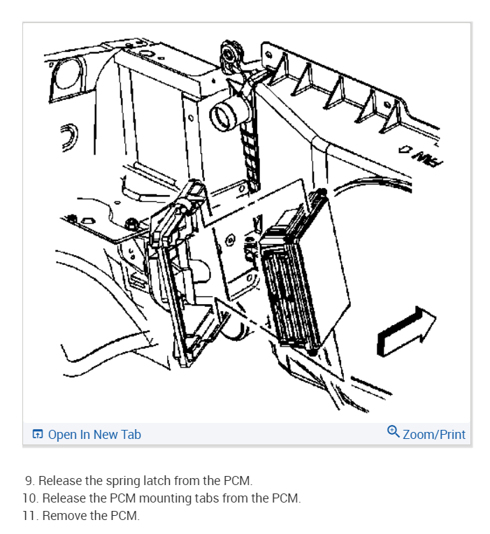

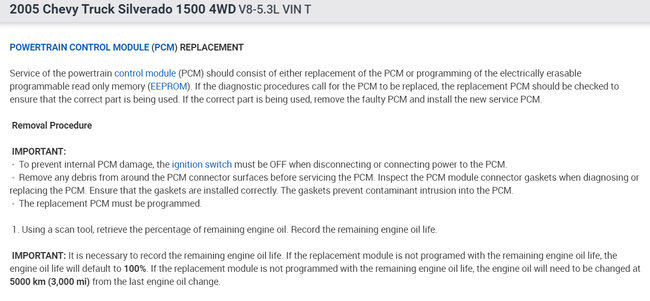

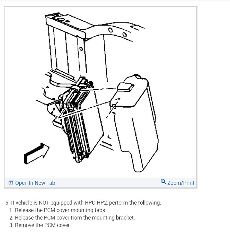

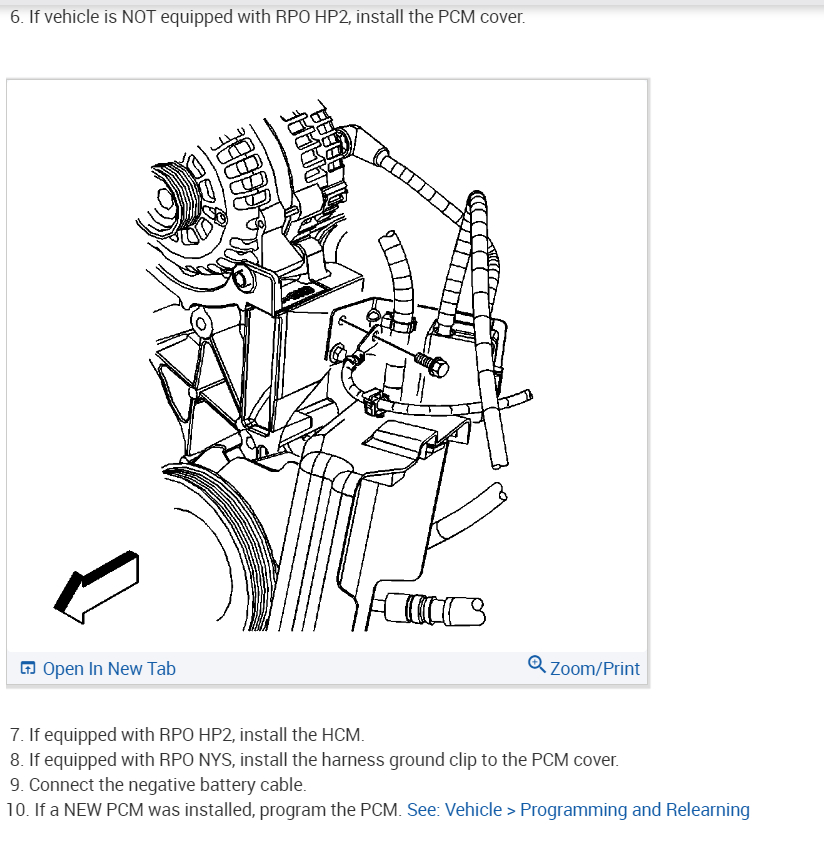

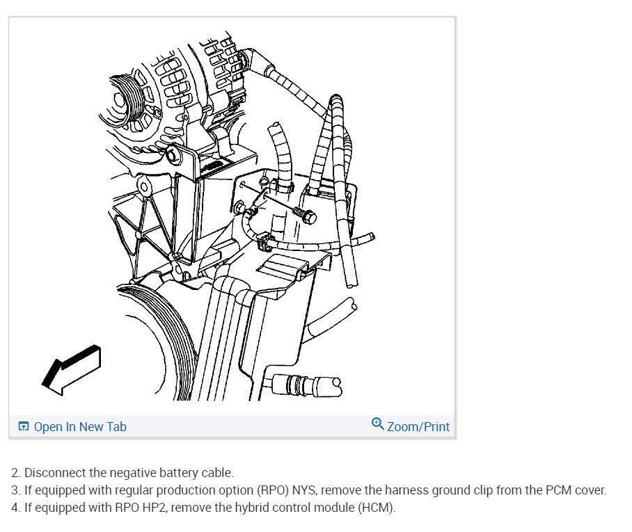

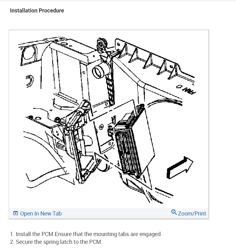

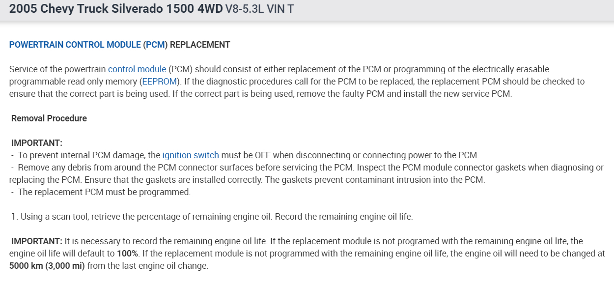

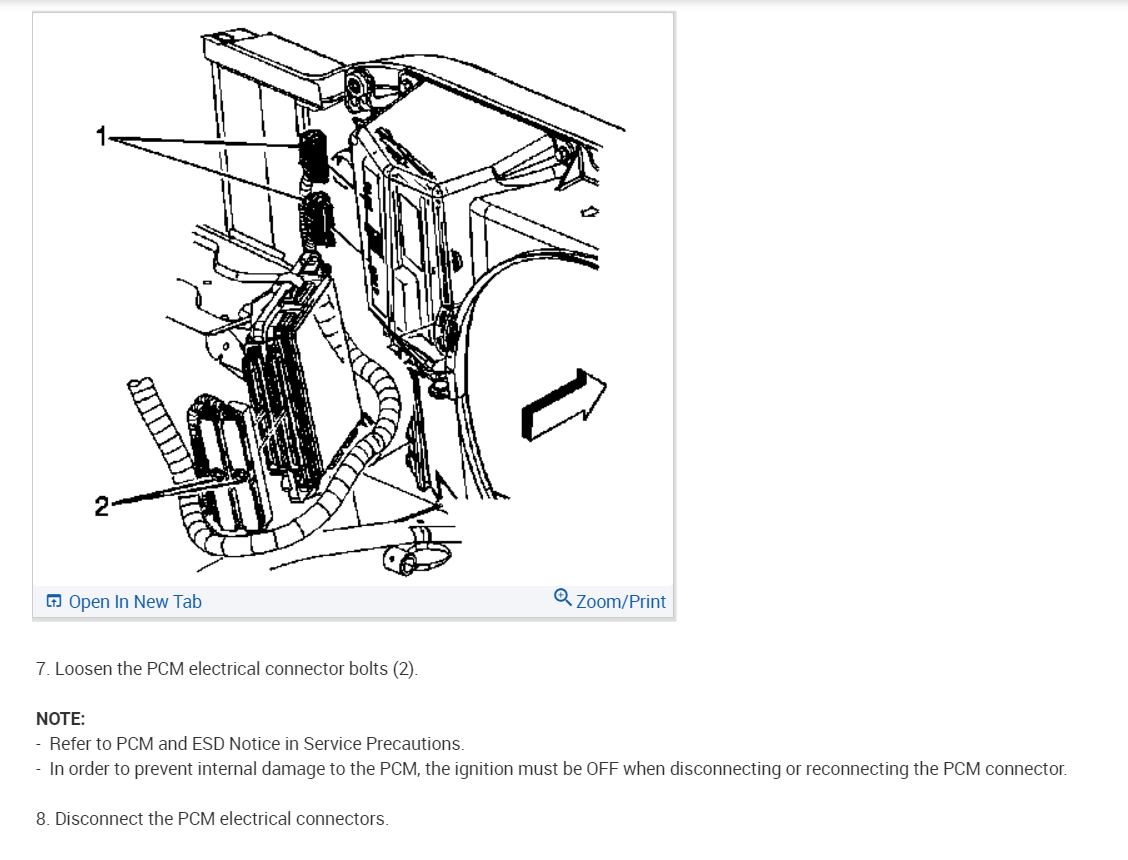

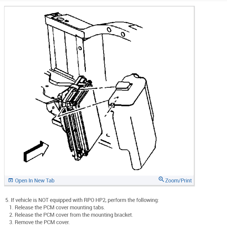

Here is how to change the PCM out, you can get a preprogrammed unit by searching Google or Ebay.

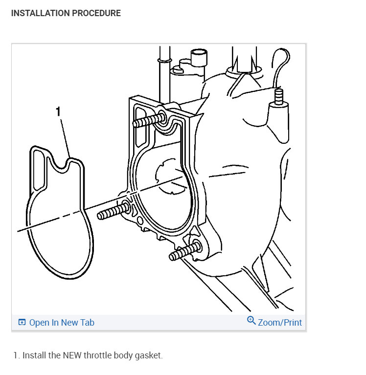

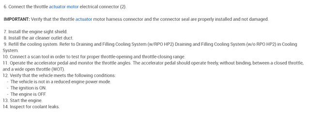

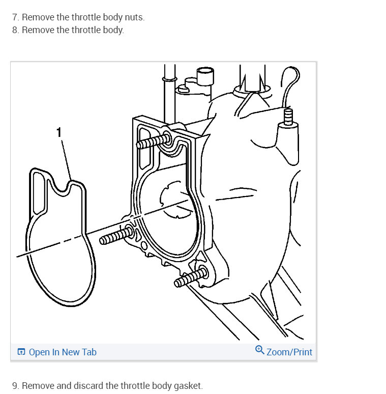

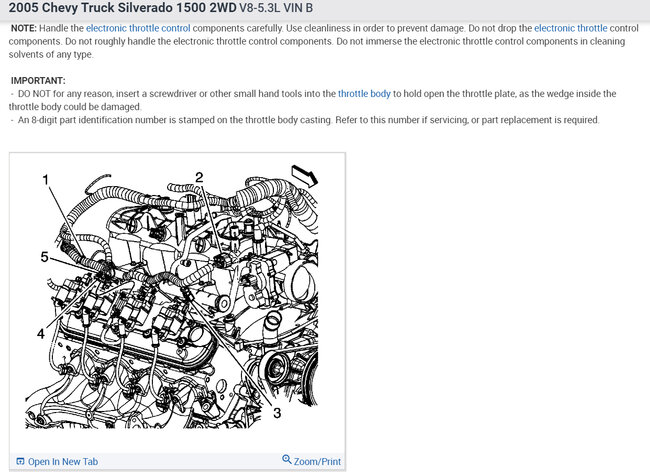

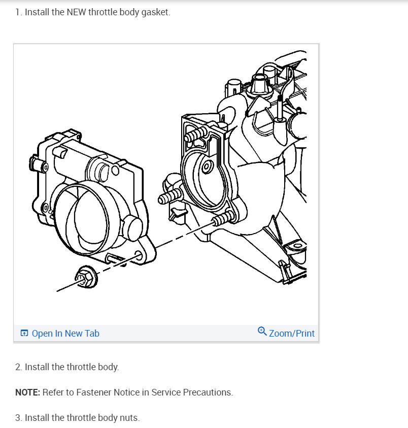

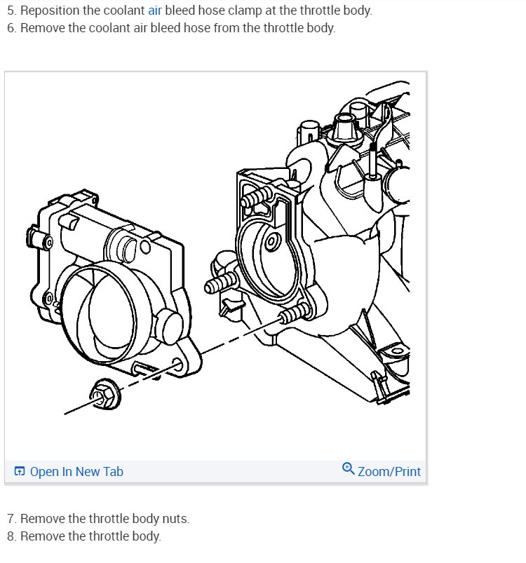

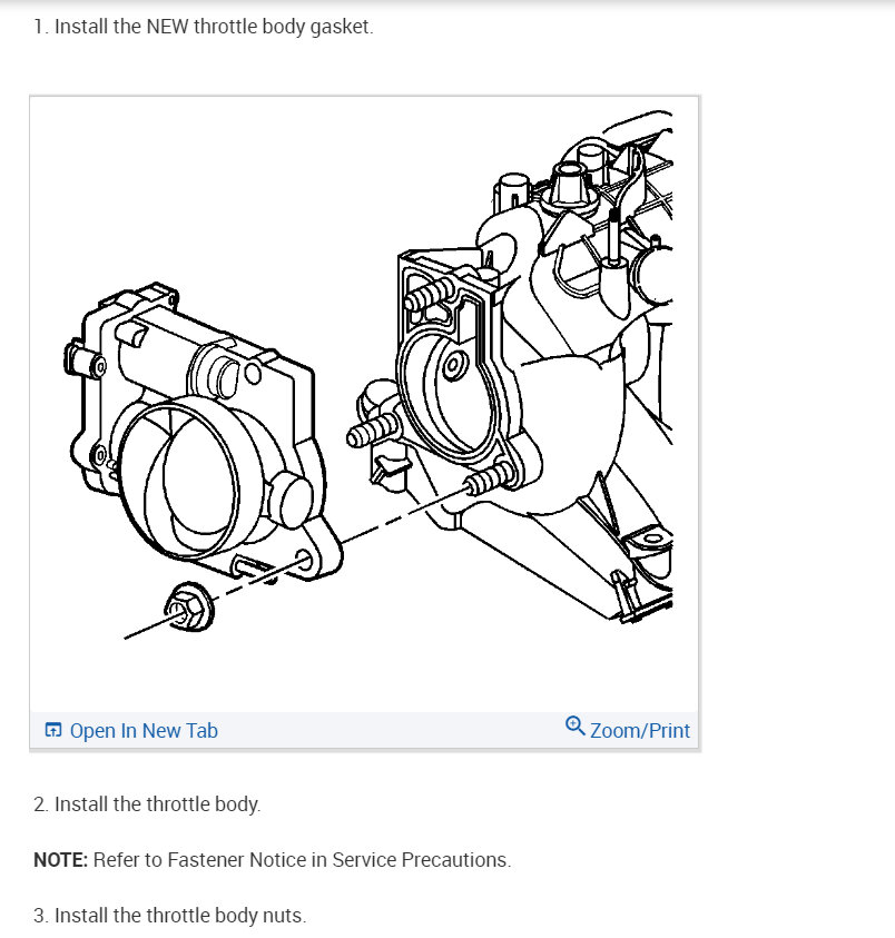

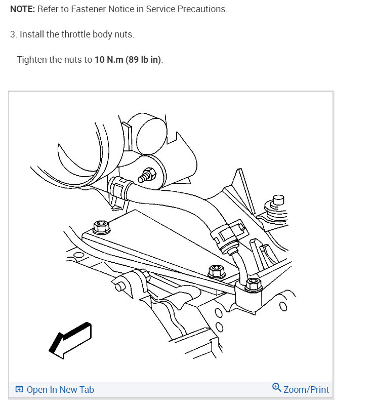

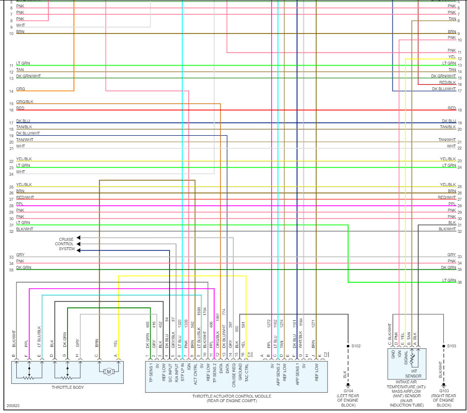

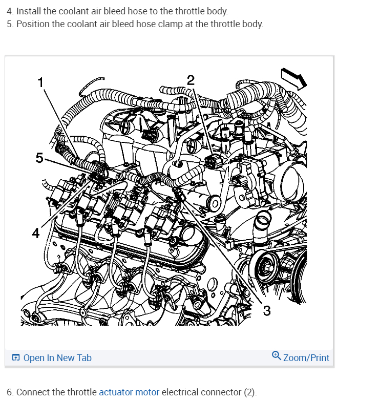

Okay, we are getting closer I would replace the Throttle Actuator Control Module. Here it is for $78.00:
https://amzn.to/43Rzn4e
Here is a video to help with the replacement:
https://youtu.be/eI9aH1r_yc8
Jul 29, 2023 at 12:59 PM

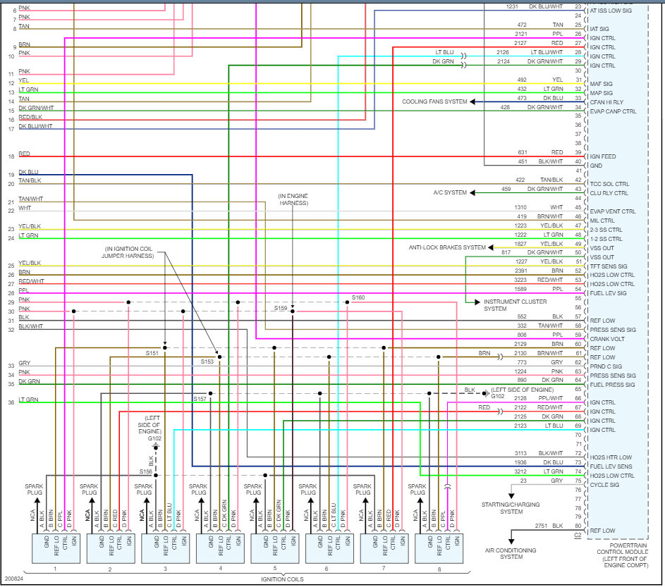

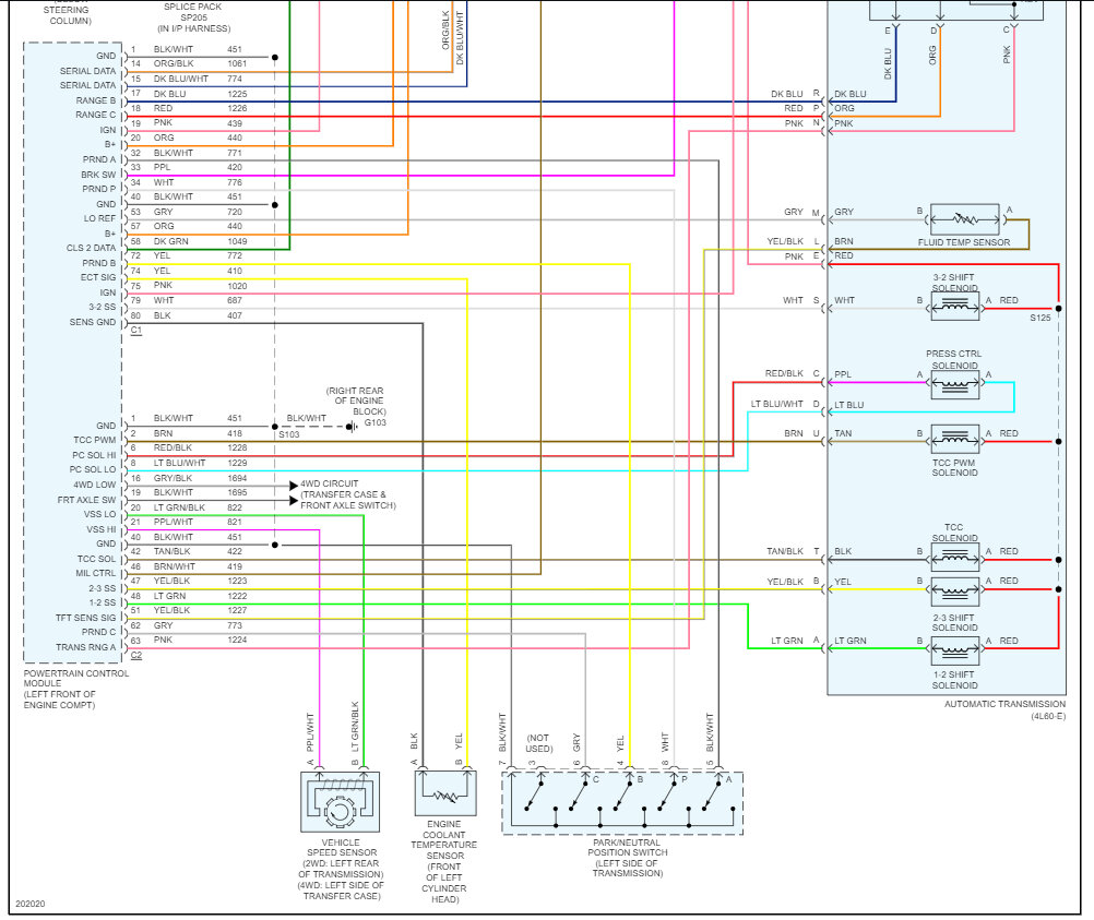

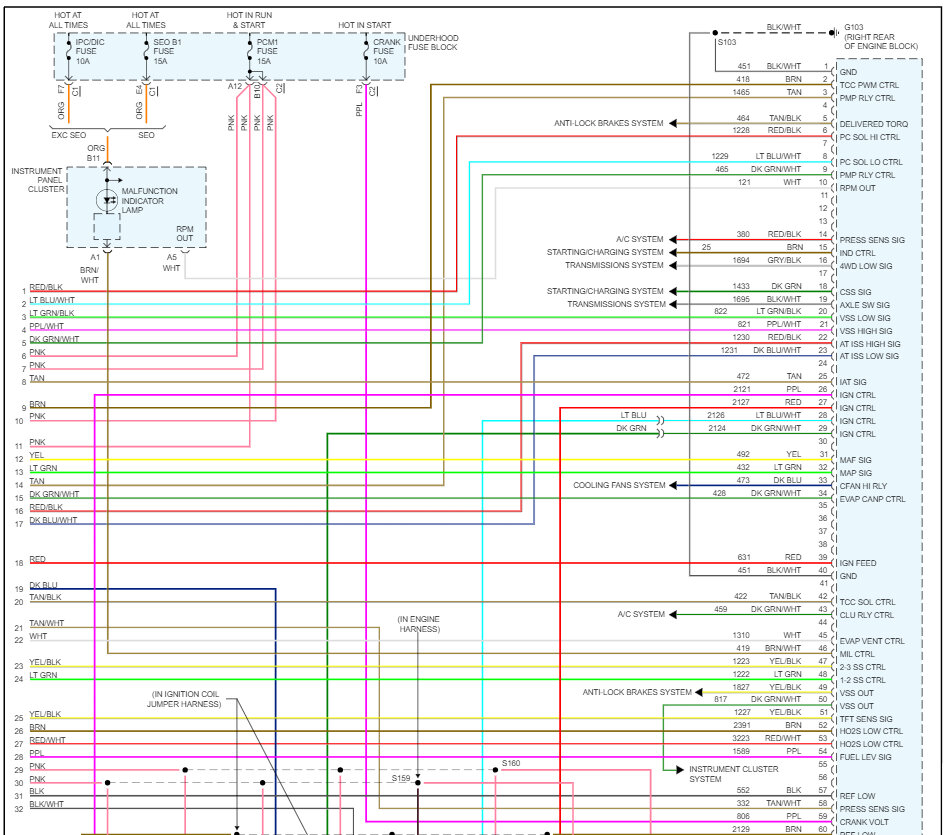

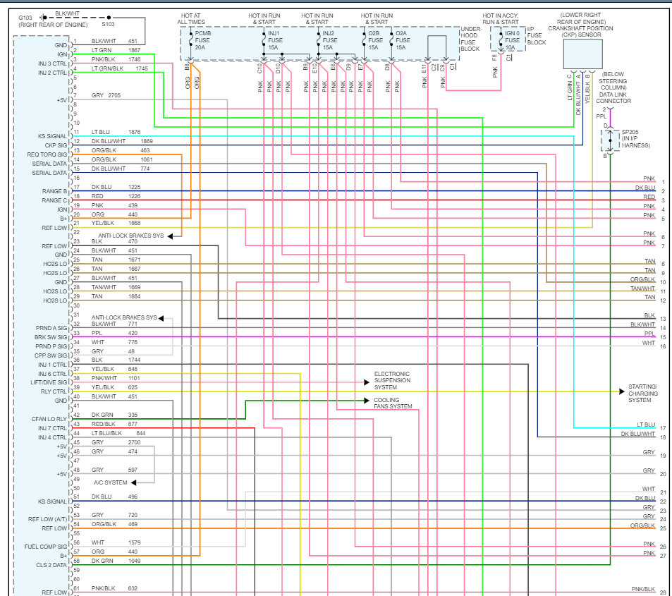

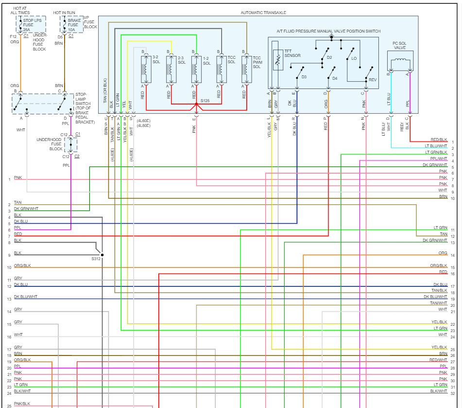

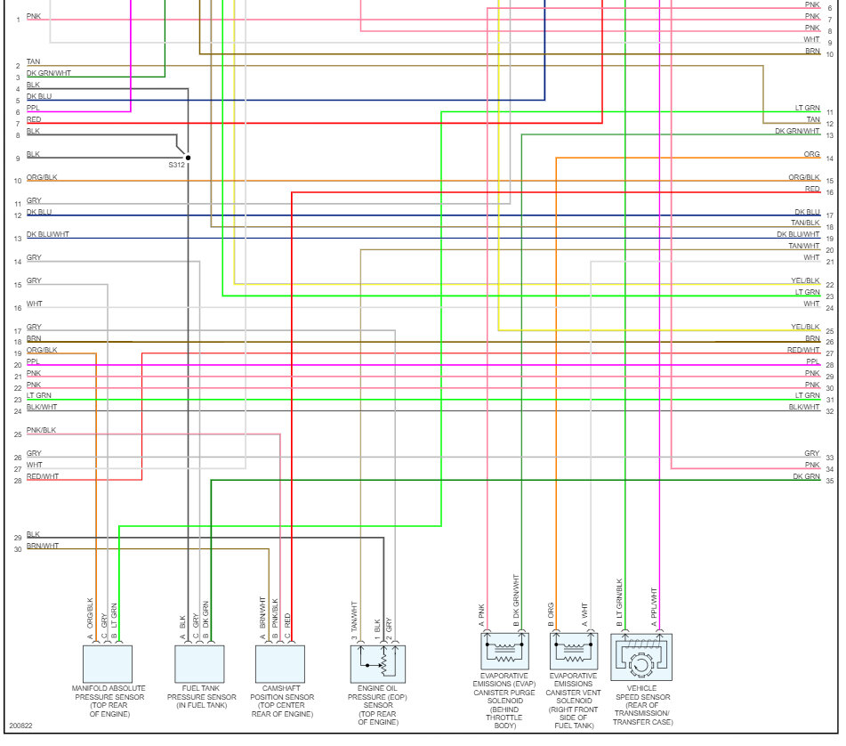

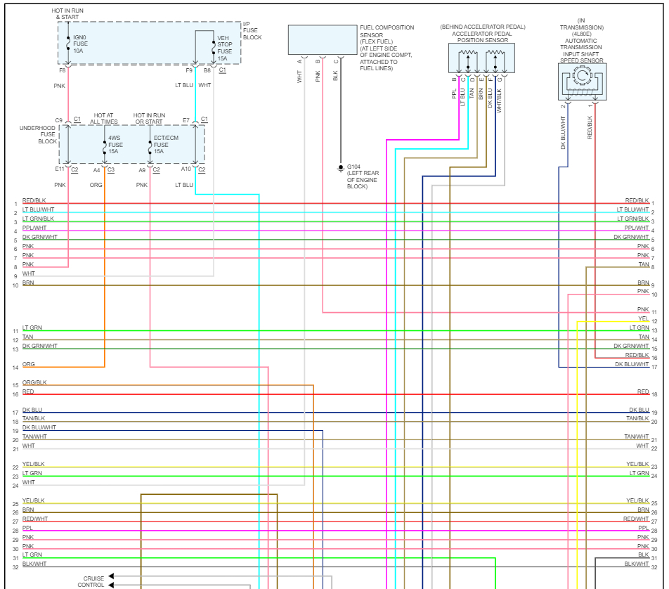

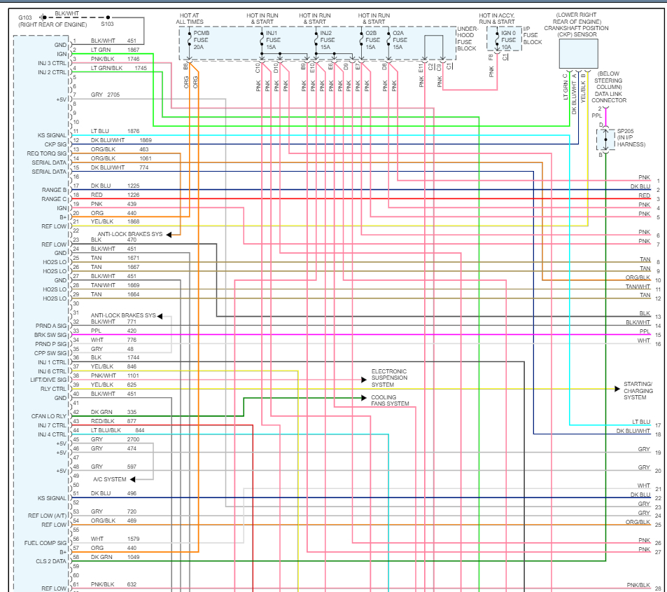

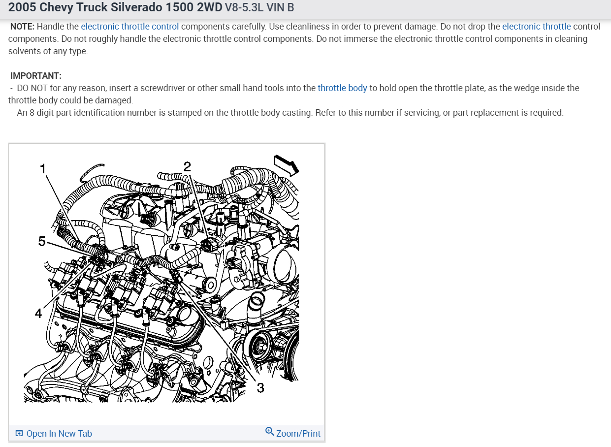

It sounds like the PCM is bad, but here are the grounds and power inputs to be sure.
This guide can help:
Jul 31, 2023 at 10:43 AM
