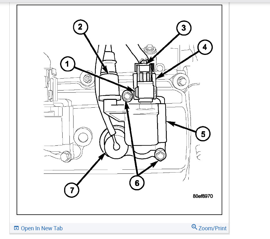

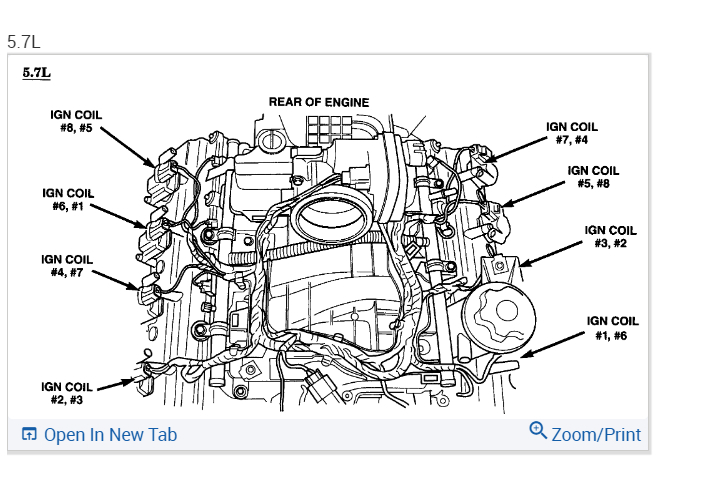

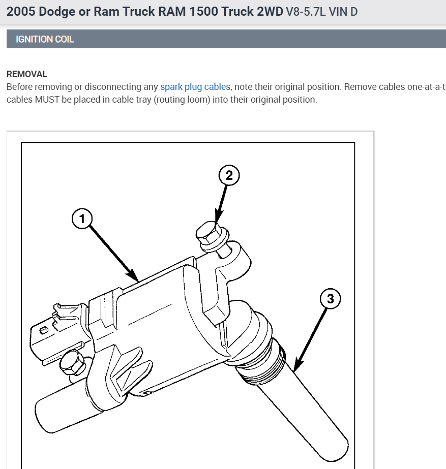

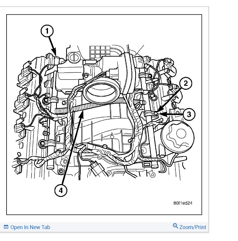

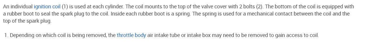

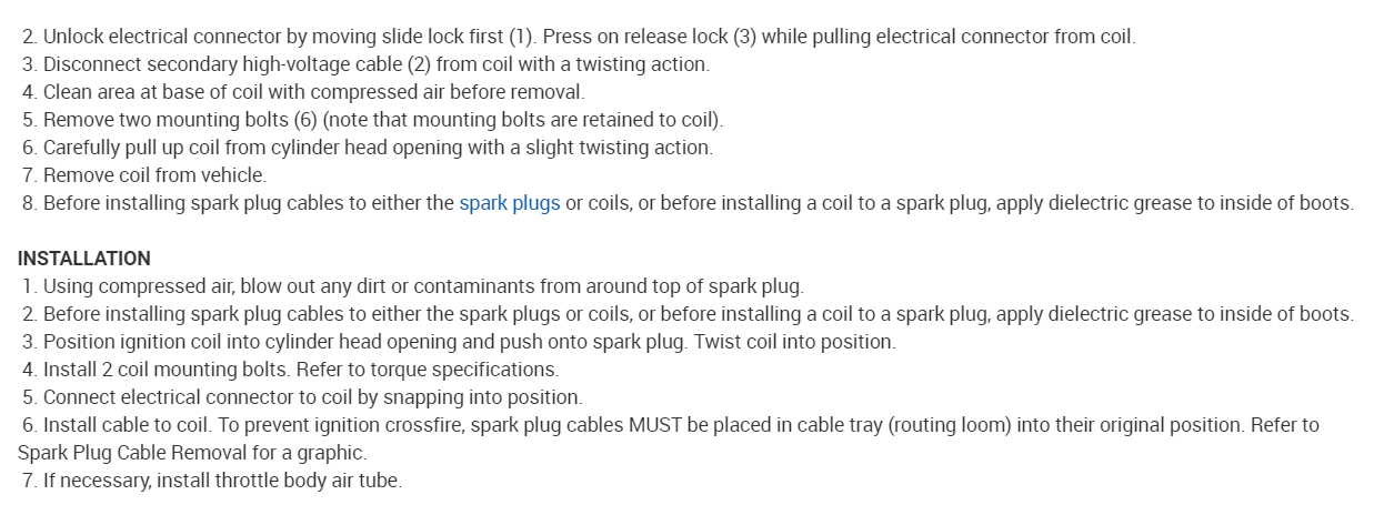

The P0303 code is the clue, it sounds like the ignition coil is going bad if you have already replaced the spark plug. This is where I would start because it is common for coils to go out. Here is how you can replace the coil in the images below. BTW it is the #3 cylinder, this guide can help as well:
https://www.2carpros.com/articles/engine-misfires-or-runs-rough
Check out the diagrams (below). Please let us know if you need anything else to get the problem fixed. Please make sure the spark plug is not cracked while you are doing the job.

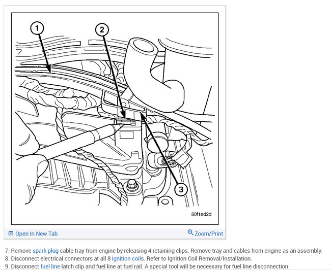

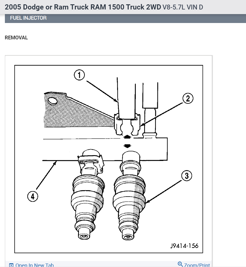

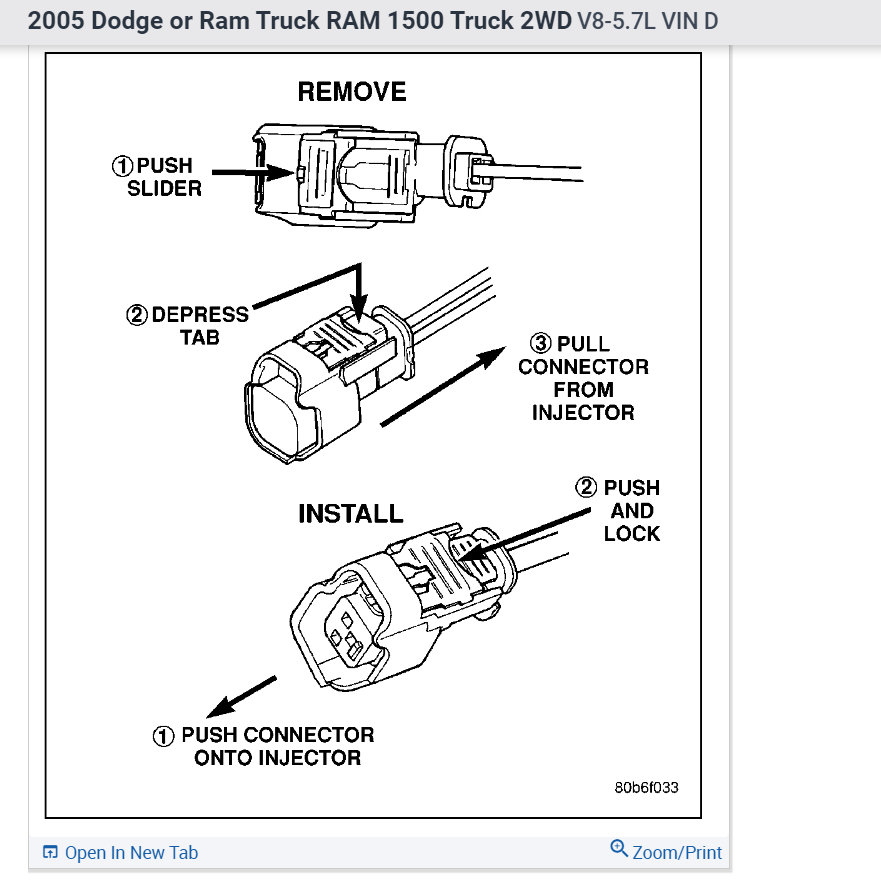

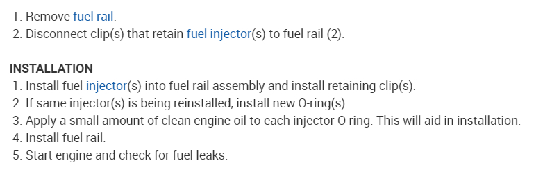

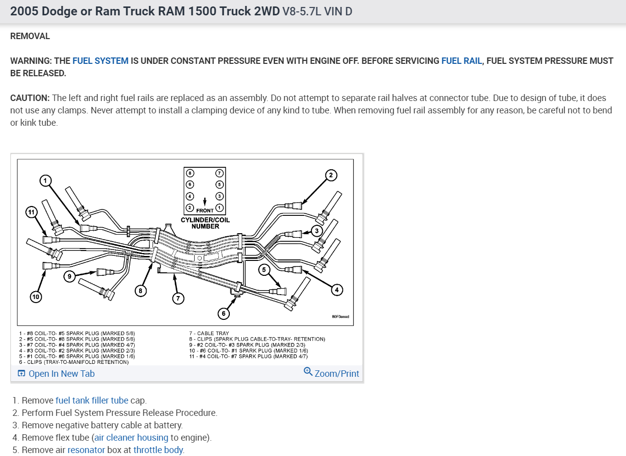

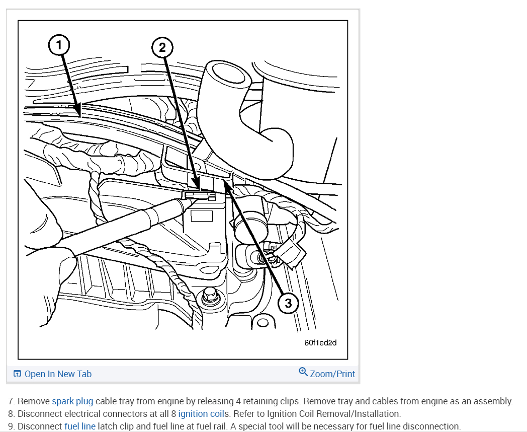

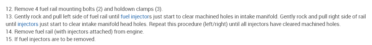

It only leaves the fuel injector if the cylinder has good compression. here is a guide and instructions, also check the images below for help as well.
Did you use OEM plug wires and plugs? You should check the spark plug to make sure it is not cracked.
