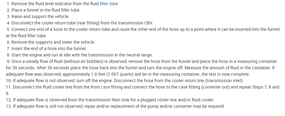

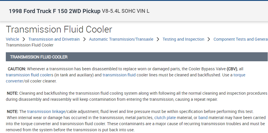

Based on what you described, it sounds like it could be related to the torque or low line pressure. I know the transmission coolers are known to plug.
I attached a test below. Let me know if this is something you are comfortable performing.
See pics below.
