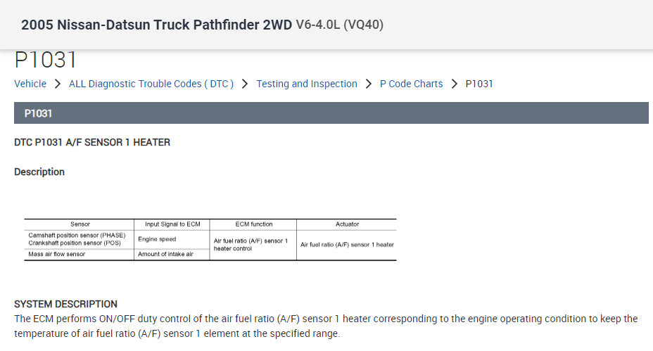

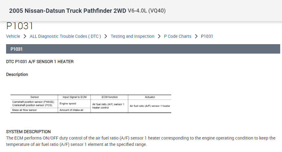

Could you have made a mistake on the P1030? It isn't listed in two manuals for this vehicle. Additionally, they are showing it as a 4.0L V6. Please confirm.

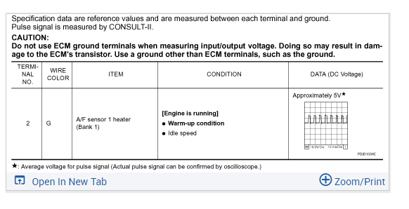

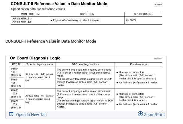

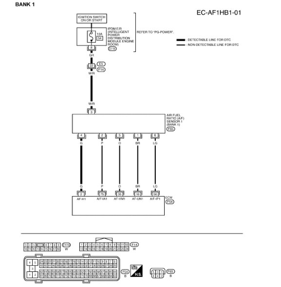

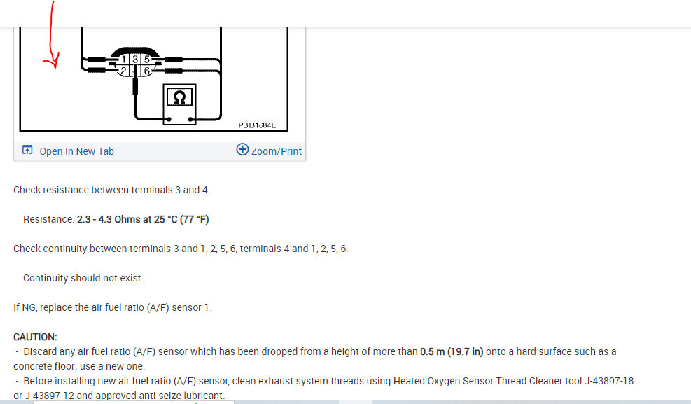

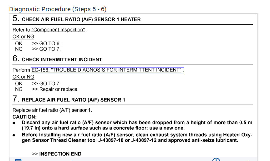

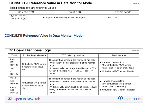

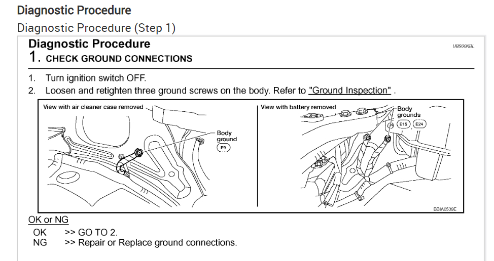

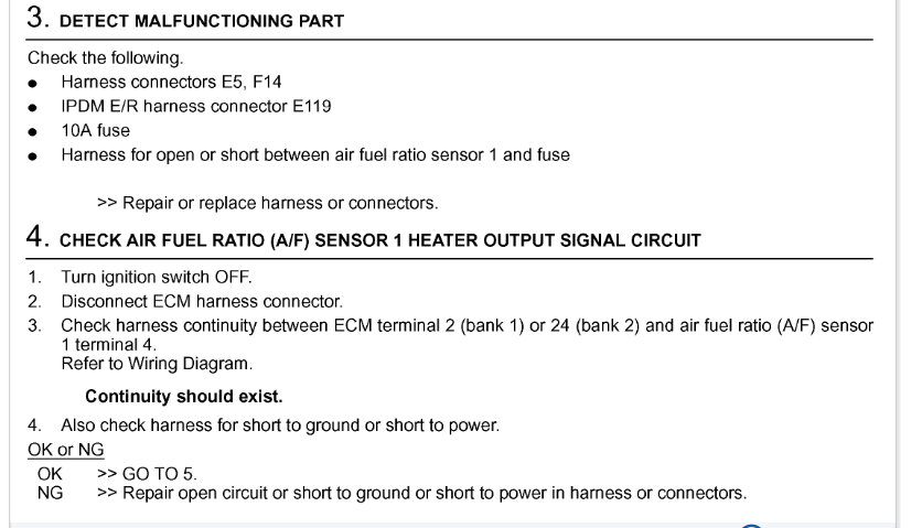

As far as the P1148, that indicated a problem (bank 1) closed loop system. However, if you have code P1031, that is related to an air fuel mixture (O2 sensor). Those two could be tied together, but it would be odd that only one of the cylinders has the misfire rather than all three on bank 1.
Did you remove the spark plug from cylinder 3 for inspection? If so, in what condition was it?
