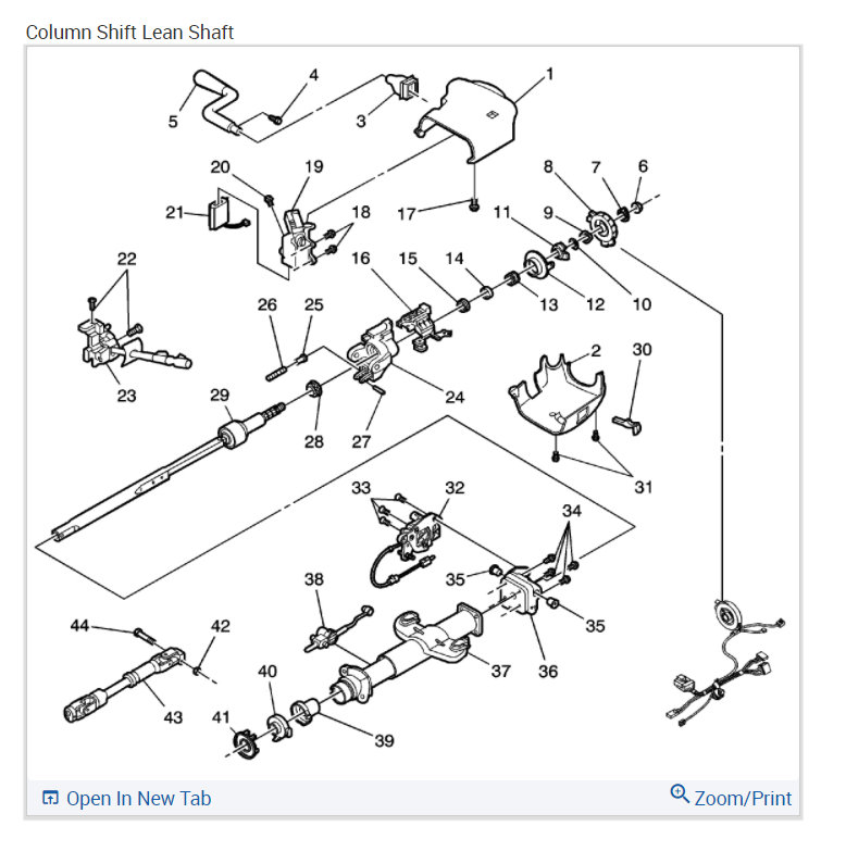

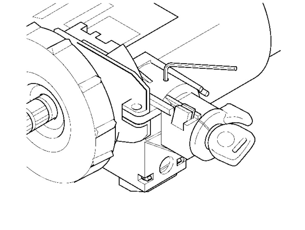

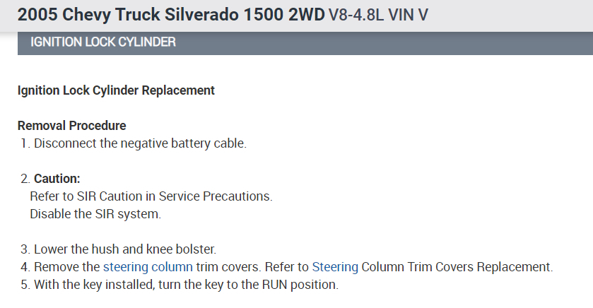

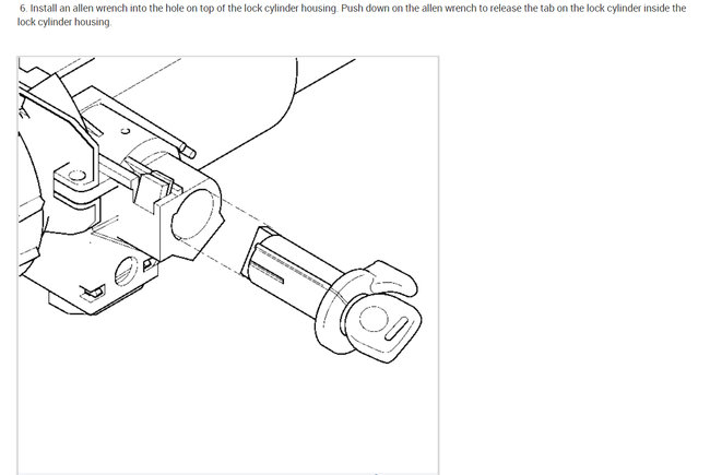

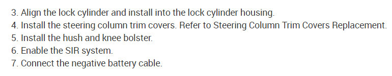

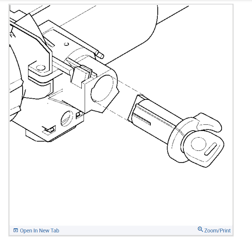

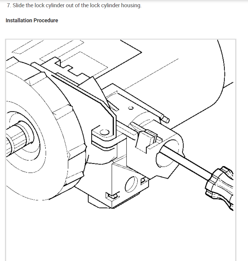

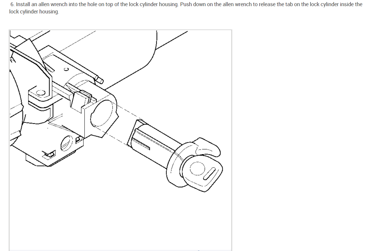

Here are the instructions to replace the ignition key and lock tumbler in the diagrams below. Check out the diagrams (Below). Please let us know if you need anything else to get the problem fixed.
