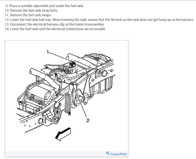

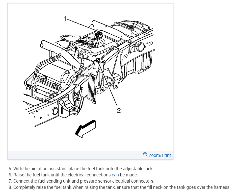

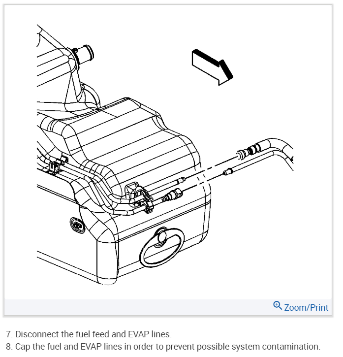

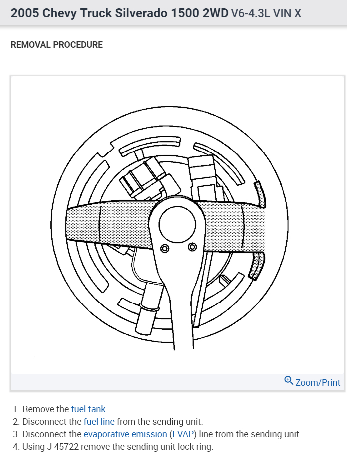

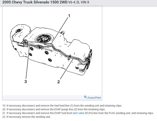

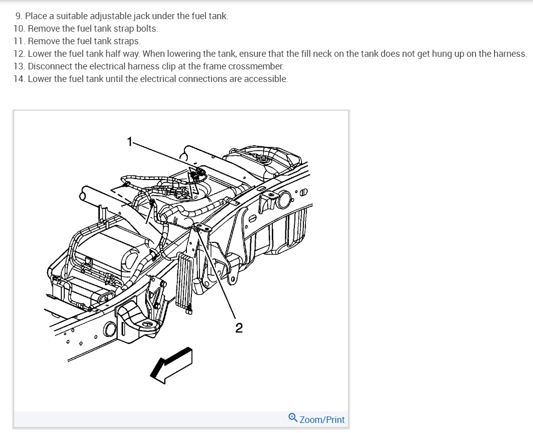

It sounds like the fuel pump is going out. Have you run the codes? Here is a guide to help us:
Next, we should check the fuel pressure when the engine is not running correctly and if no good replace the fuel pump, I would use an AC Delco unit.

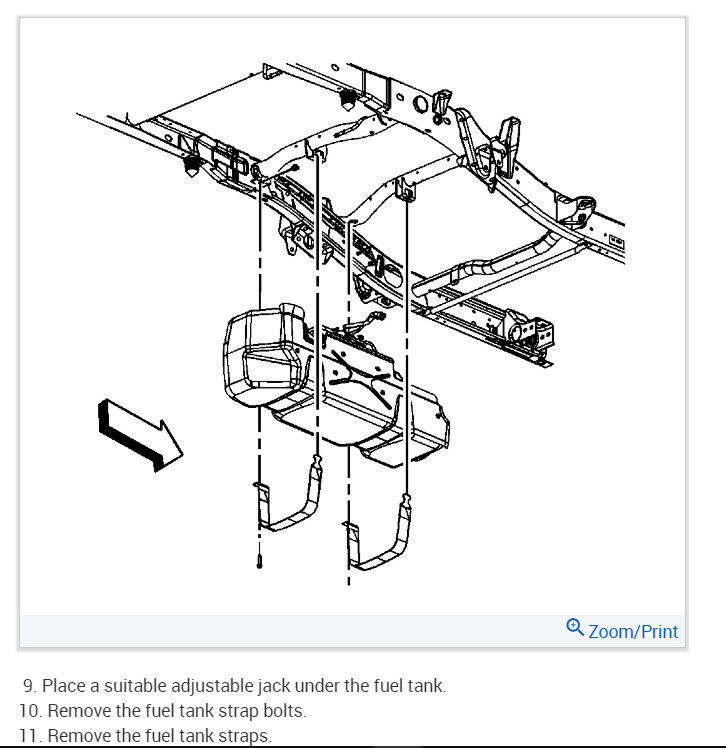

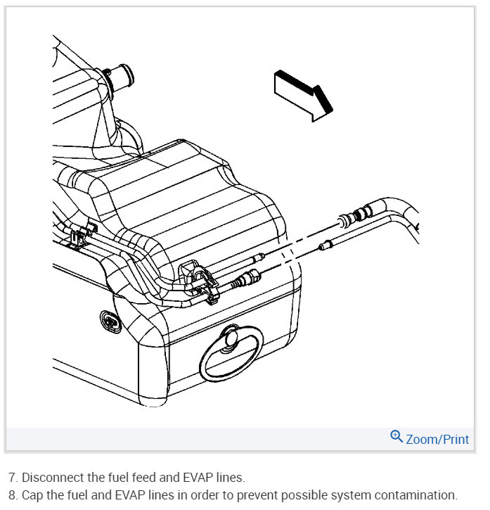

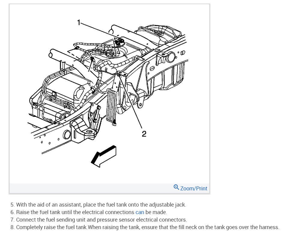

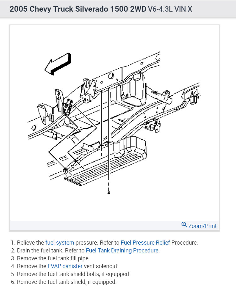

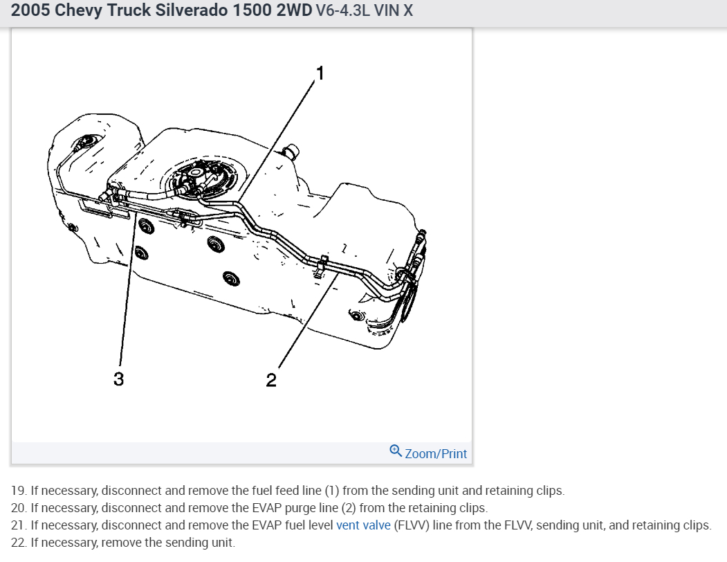

You can rent a gauge kit from the auto parts store. Here is how to change he pump out in the diagrams below. Check out the diagrams (below). Please let us know what you find. We are interested to see what it is.
