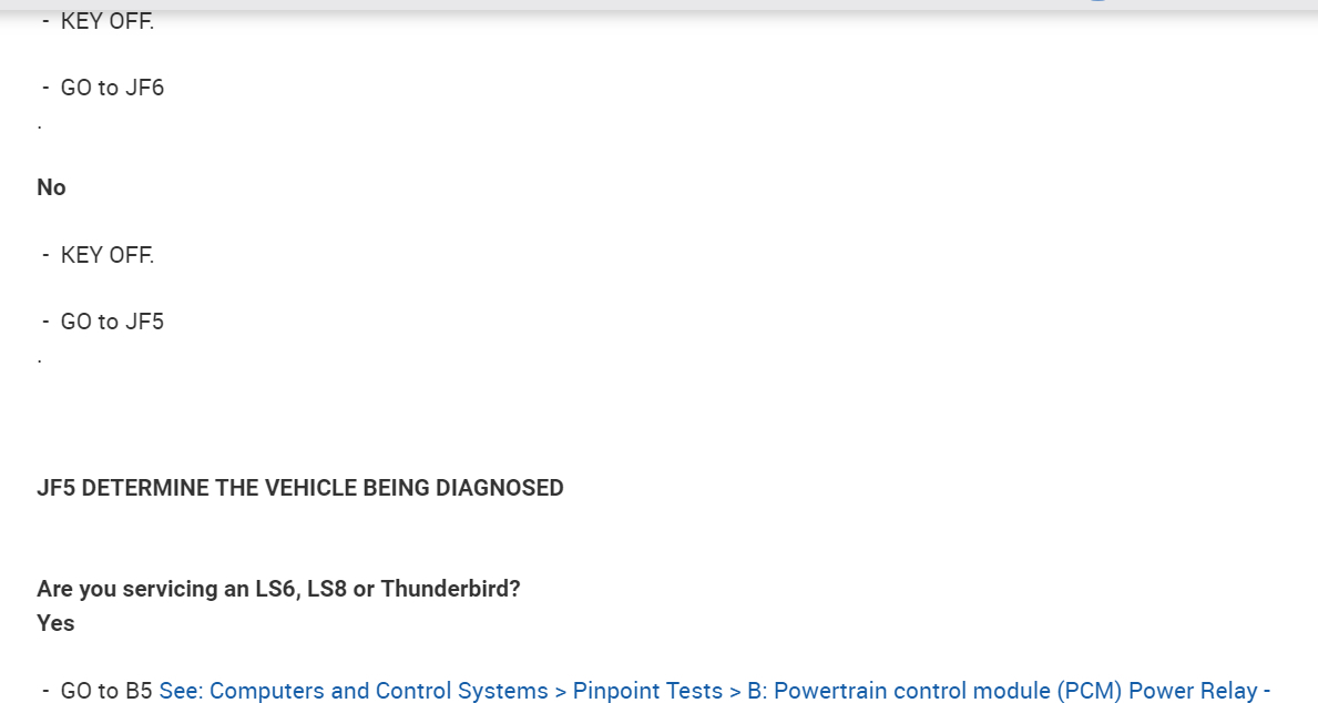

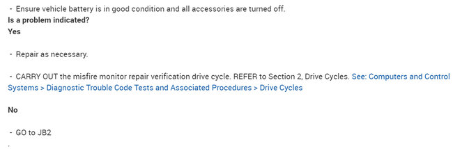

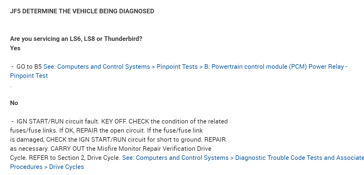

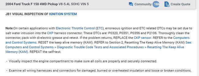

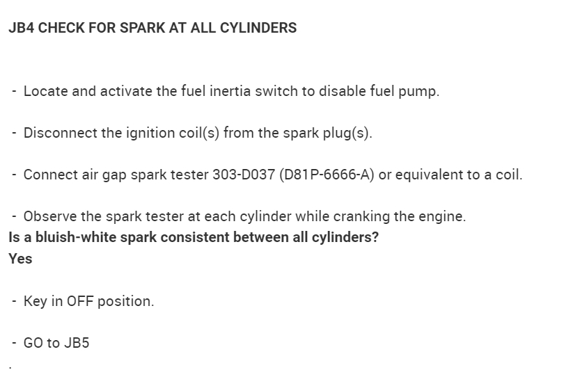

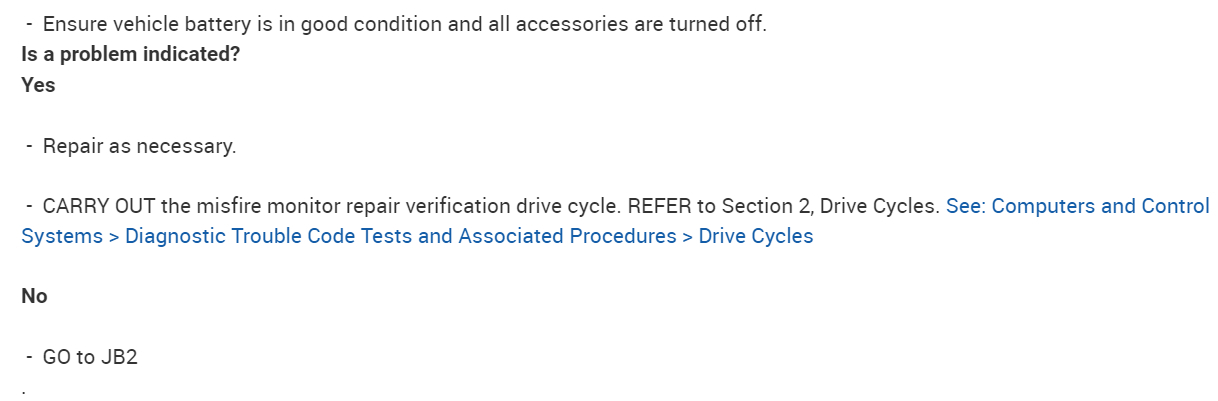

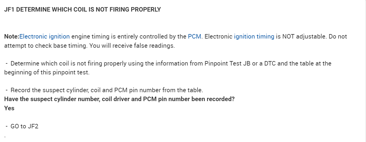

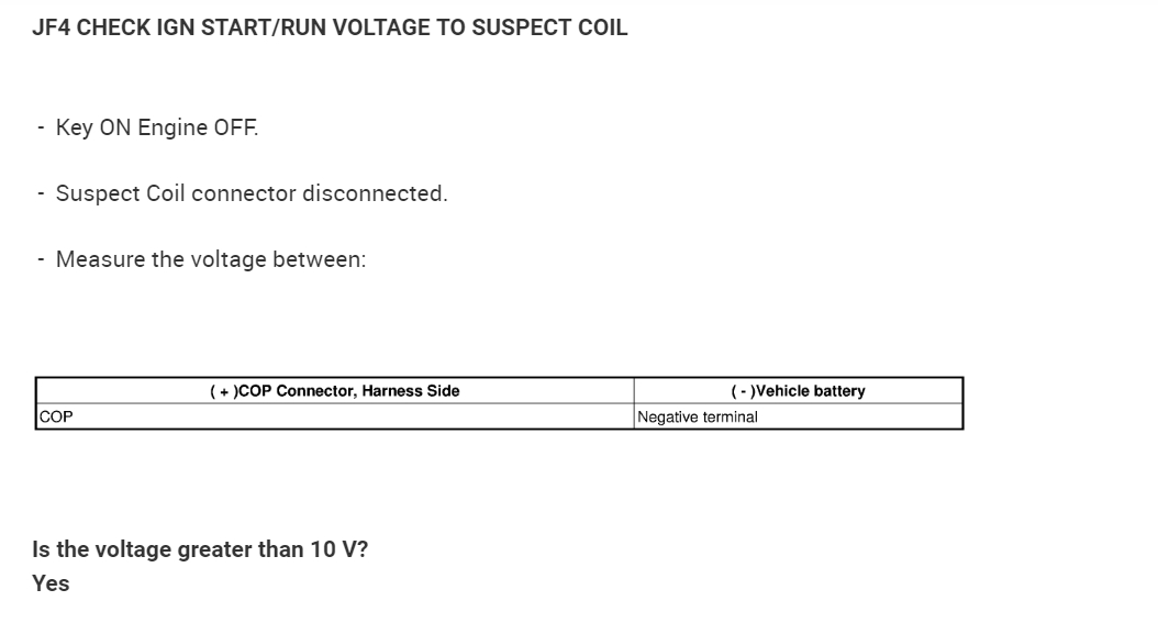

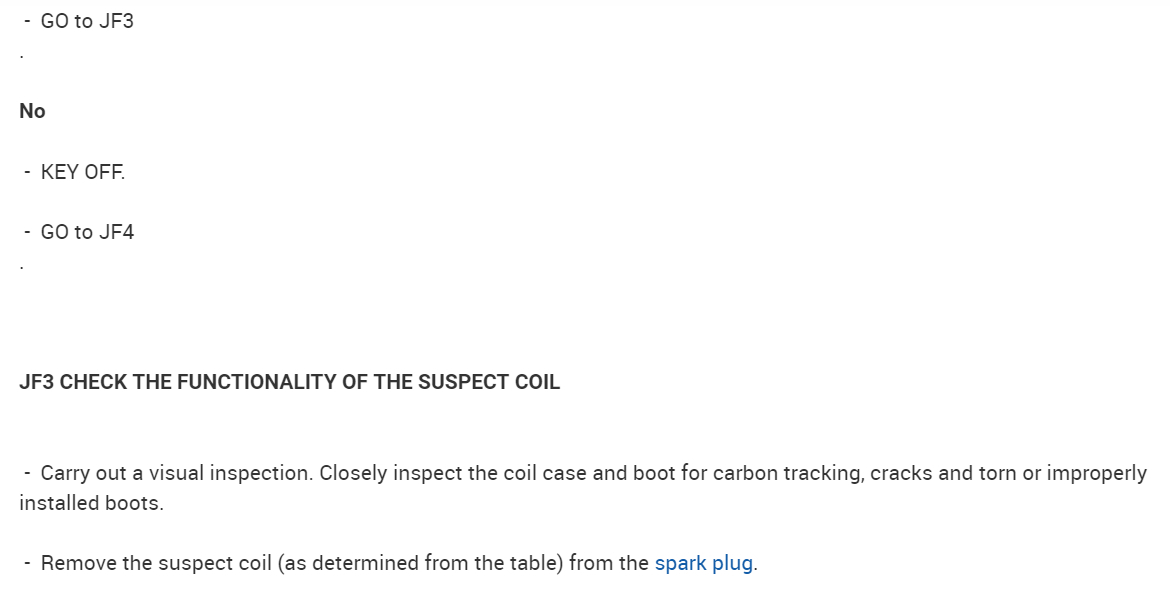

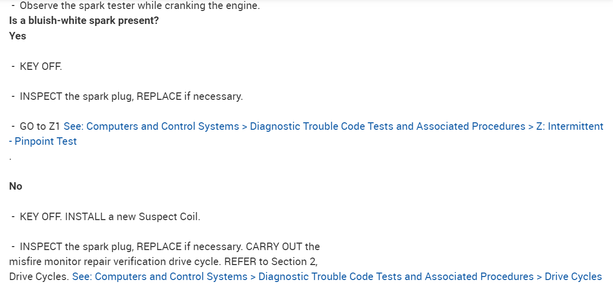

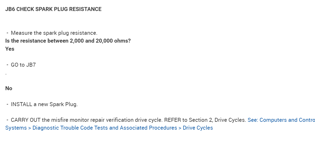

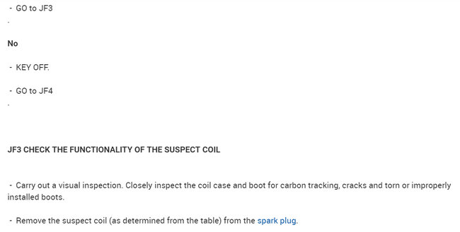

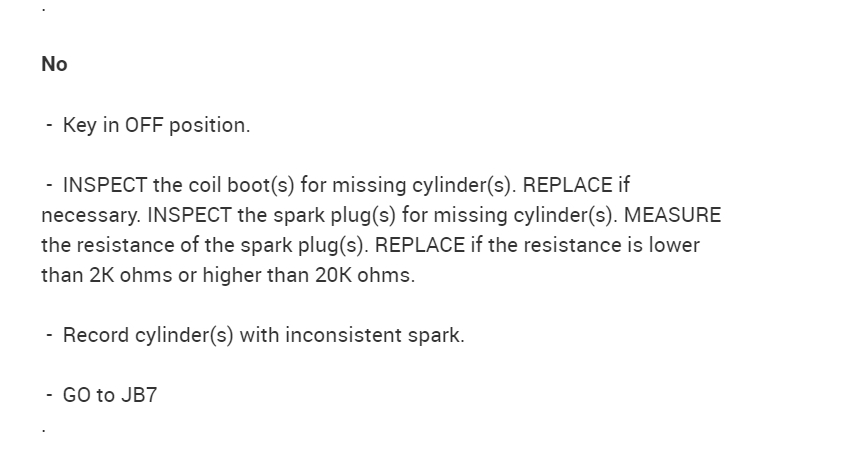

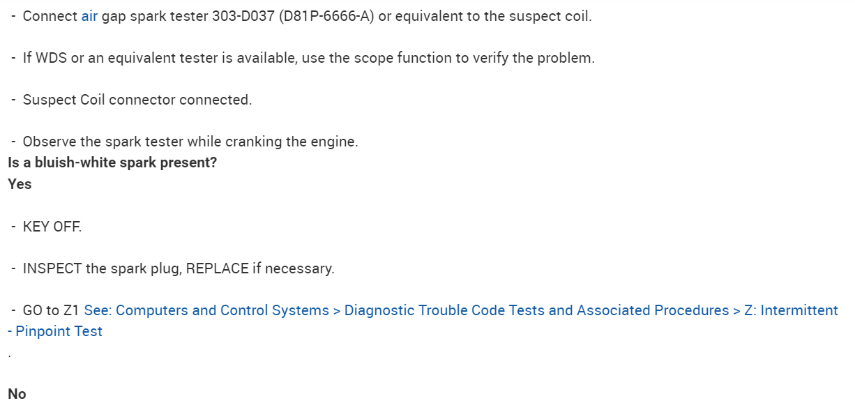

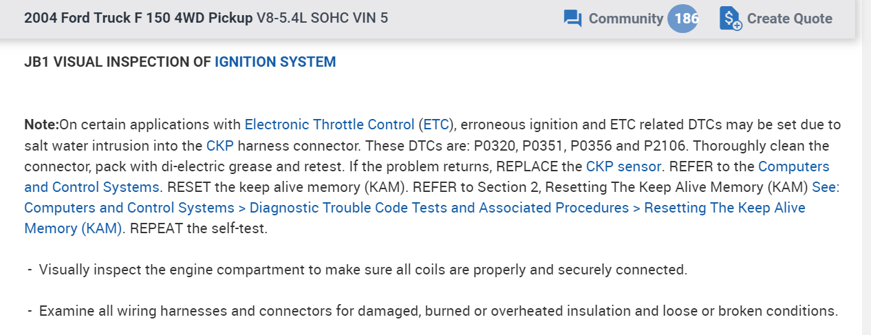

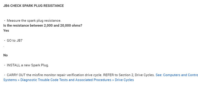

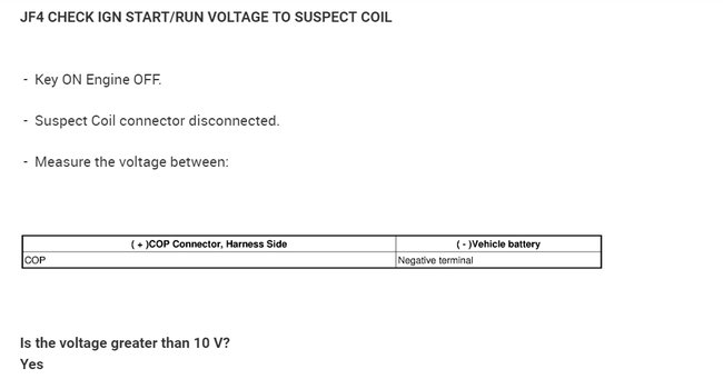

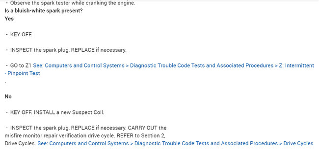

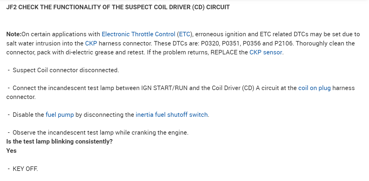

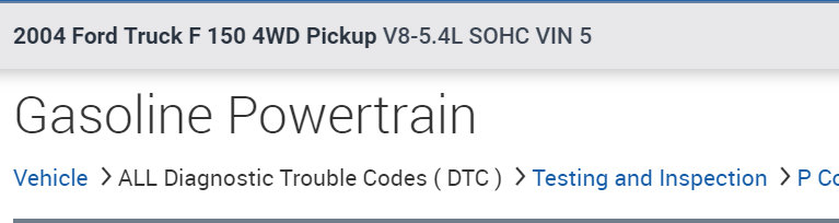

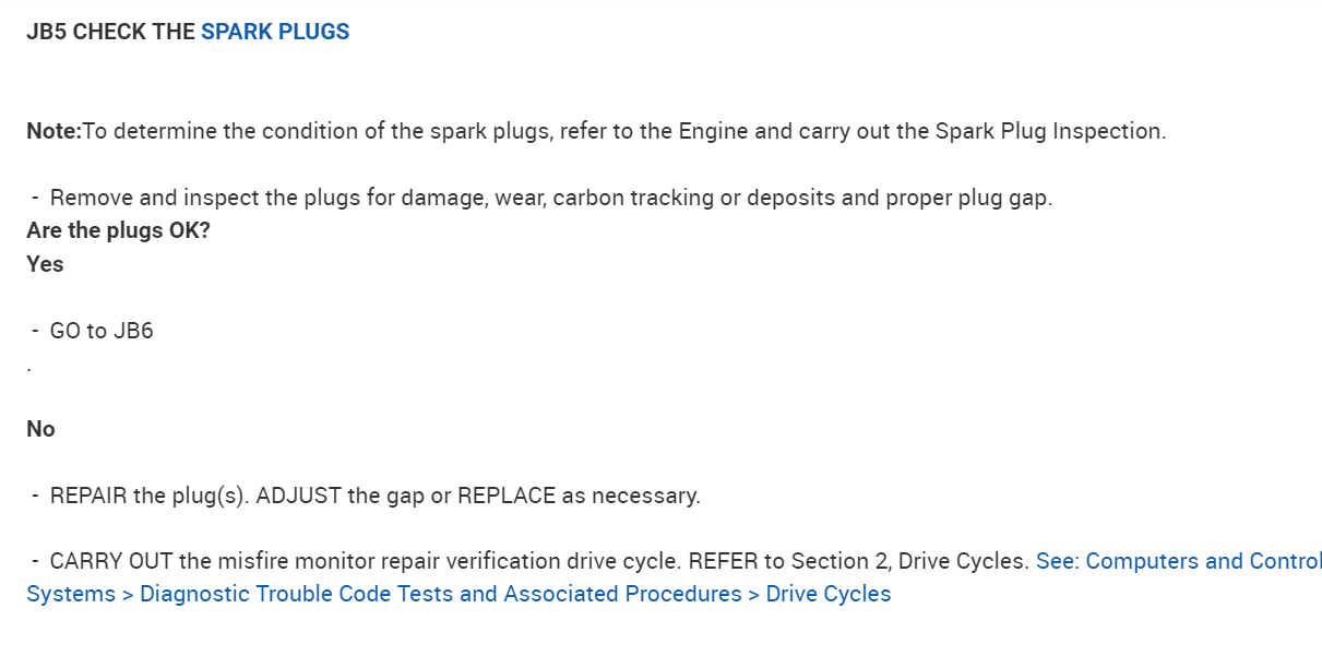

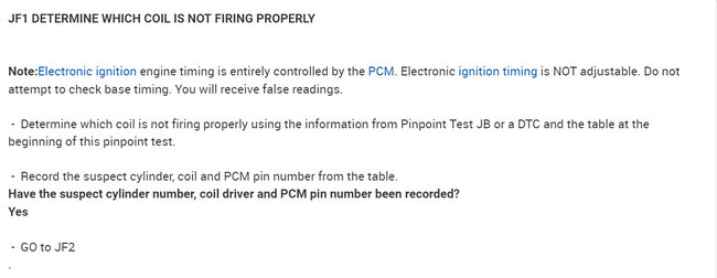

In the diagrams down below I have included for you the factory diagnostic troubleshooting flowcharts for your vehicle for Direct Trouble Code(s)(DTC)(s) P0351 and P0356. In the pinpoint tests they will have you test for spark, and here is a link below explaining how to do this if you don't have a spark tester:
Please go through these guides and get back to us with what you are able to find out.
