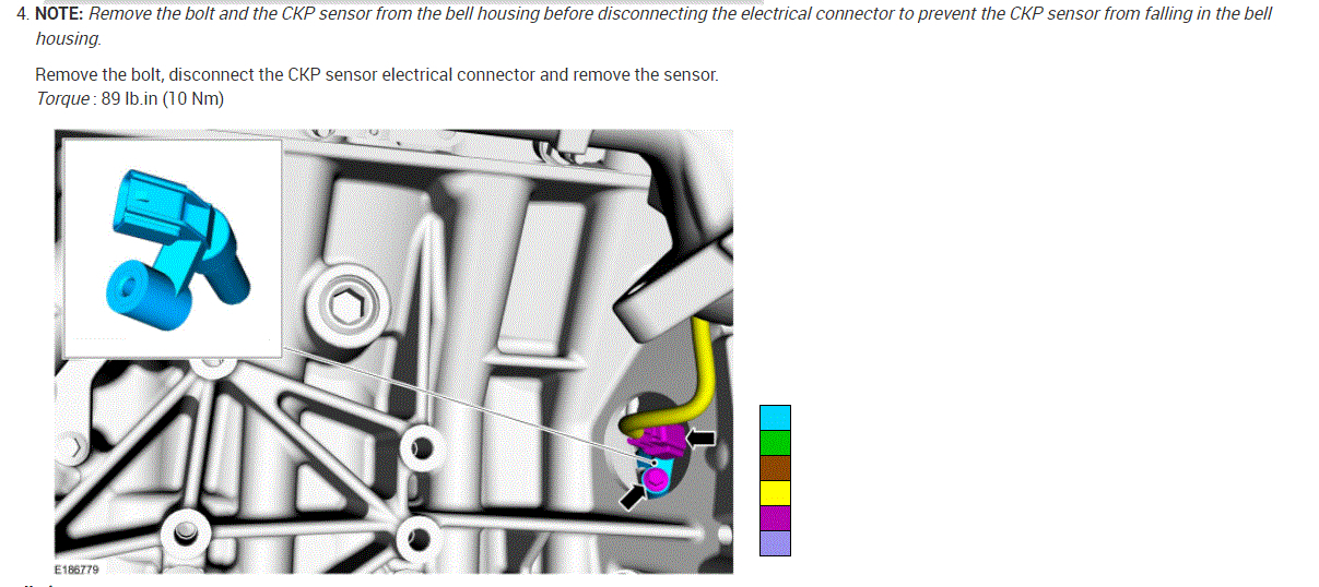

What you described sounds like a faulty crankshaft position sensor. Oftentimes, when they start to fail, heat adversely affects them causing a no start or stalling. Then, when they cool off, they work again.
Do me a favor and look through this link and let me know if it seems to mirror what you experience.

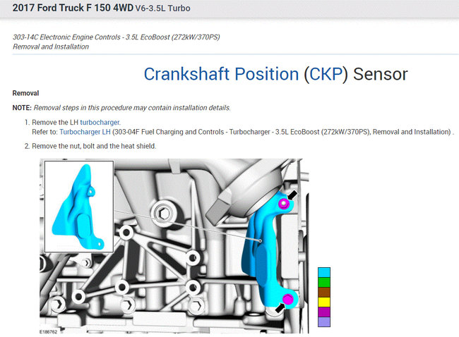

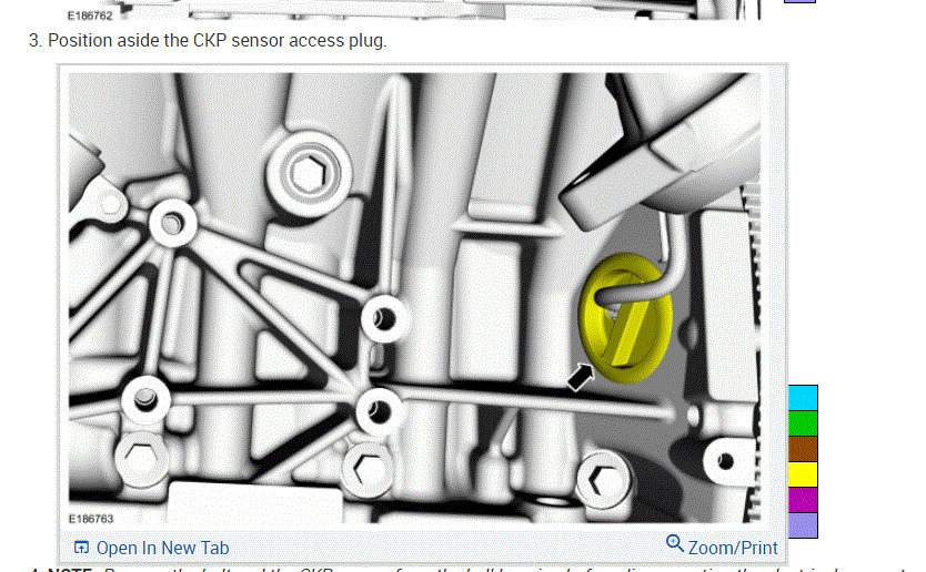

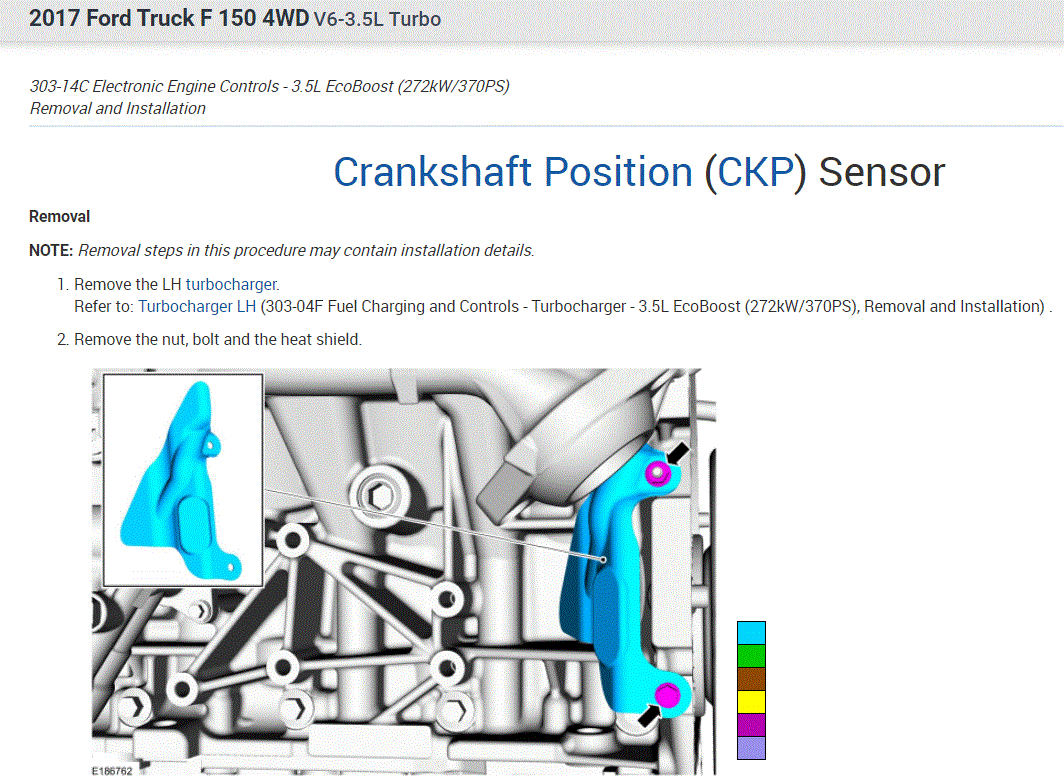

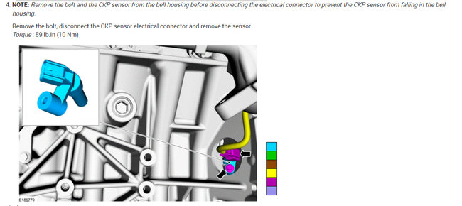

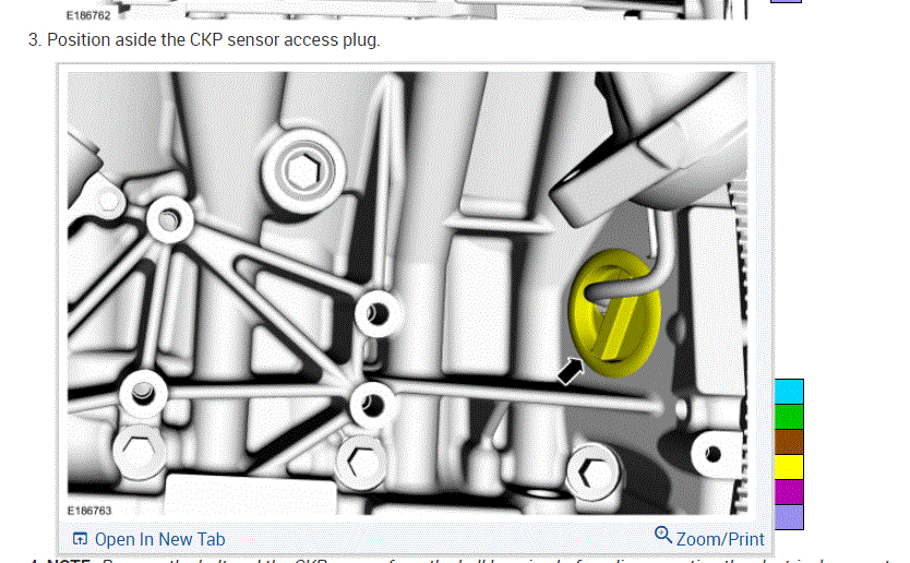

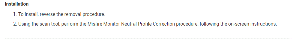

The pics below show the directions and pics specific to your vehicle for removal and replacement.
Let me know if this helps.
See pics below.
