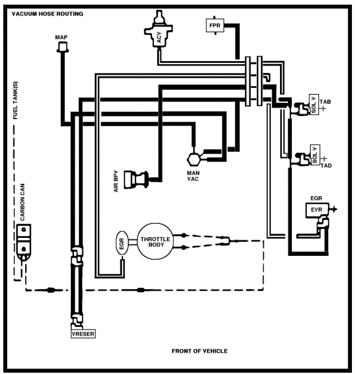

You've been through a lot. I attached the only vacuum schematic I could find for a 1989. Take a look through it and see if it helps.

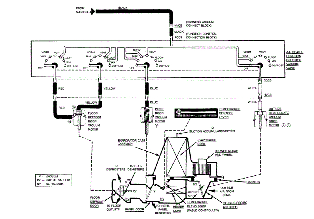

Also, the HVAC mode is controlled via engine vacuum, so check that as well. If you look at pic 2, it shows the vacuum schematic for the system.

There is a vacuum hose routing decal on the truck, I will compare with the one sent (thank you).

True HVAC vacuum hose(s) or vacuum door can cause run ability issues, I ruled this out since the engine vacuum ports are capped off.
