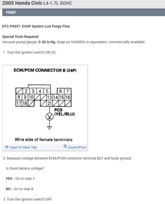

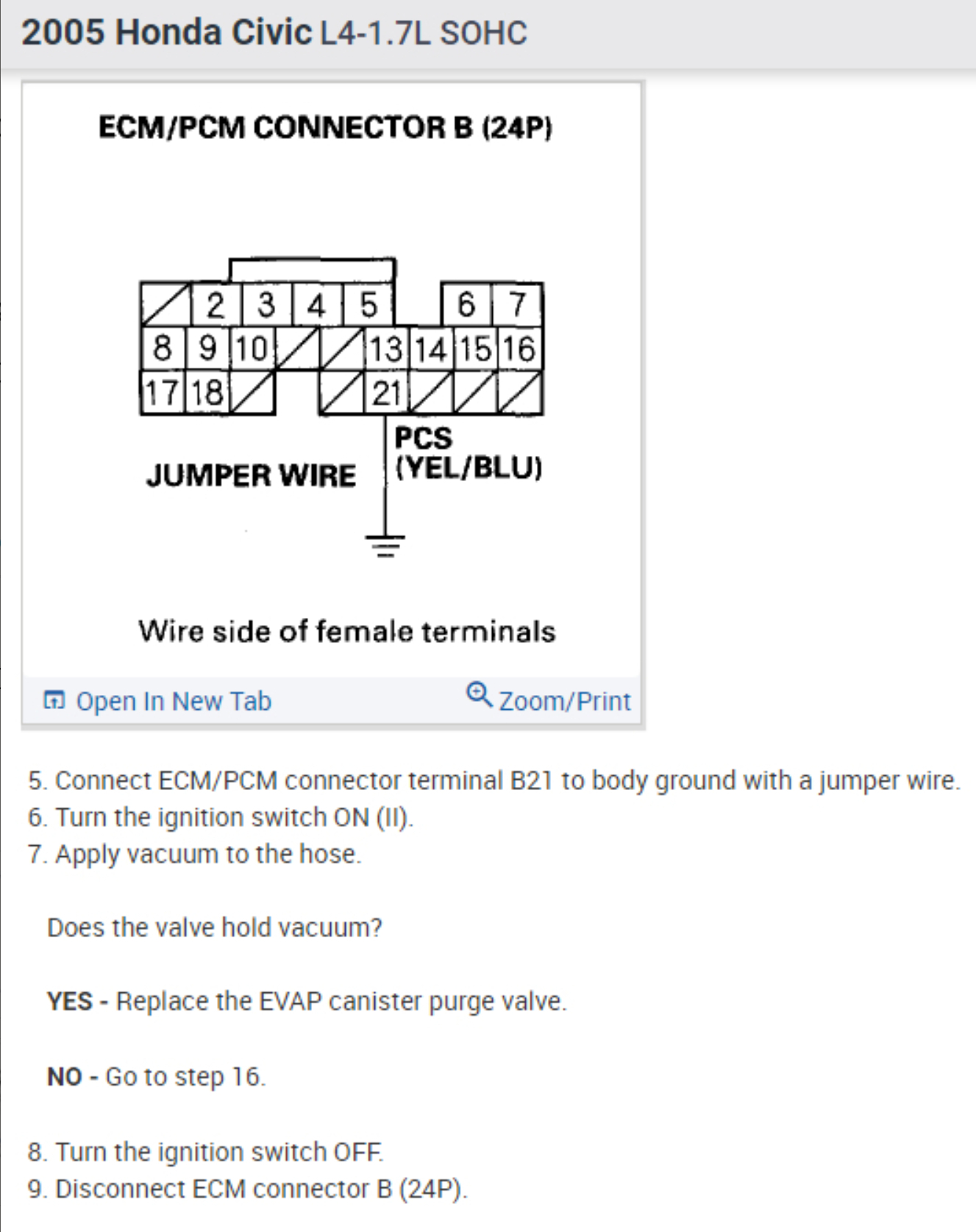

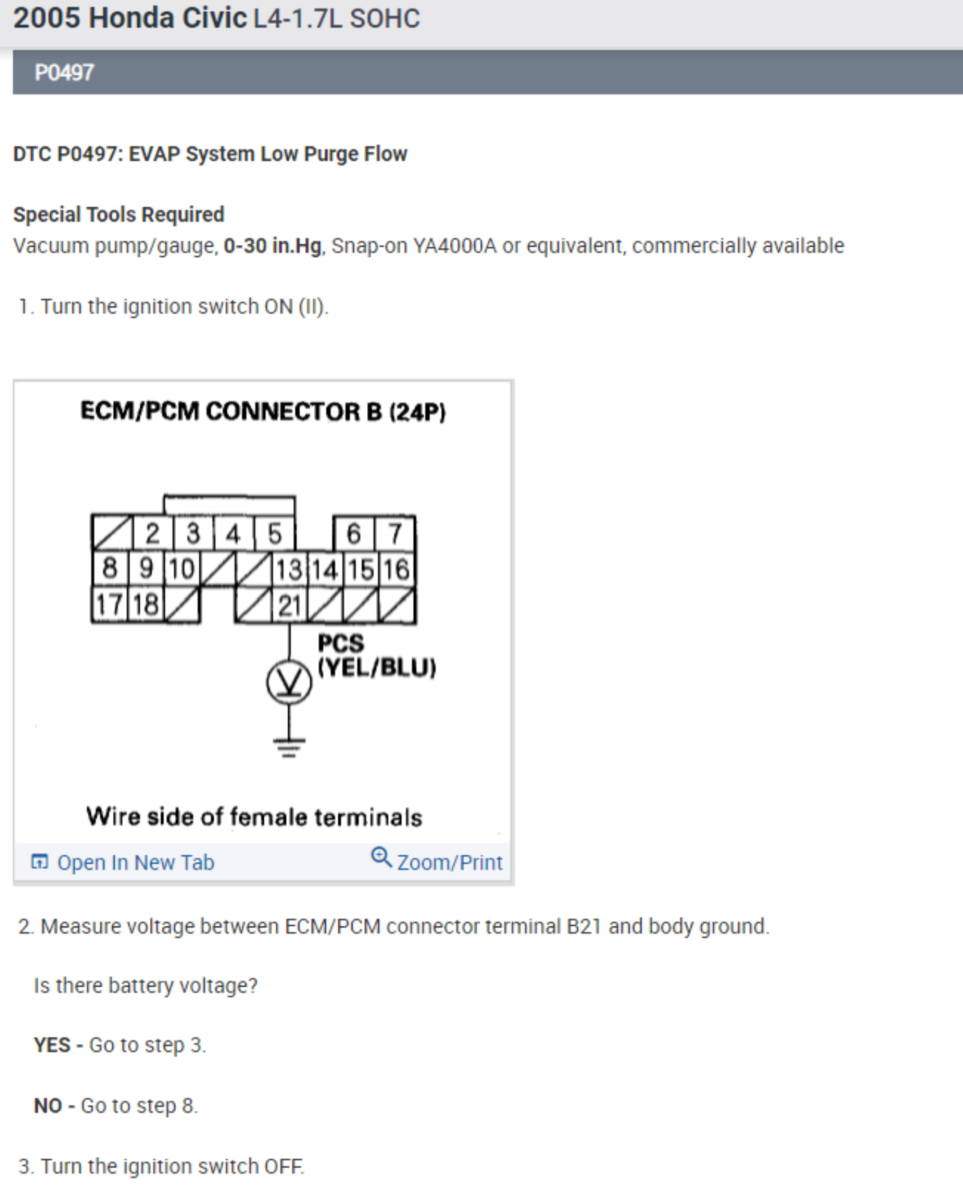

After doing a search I found a post on this website and a solution by @SQM (https://www.2carpros.com/questions/2005-honda-civic-engine-code-p0497#last) with the troubleshooting steps to diagnose the source of the problem. The steps are very detailed, and I appreciate SQM input. The only doubt I have is related to the steps that require you to measure voltage or jump a connector terminal to body ground. For example, if you look at the post linked above and the image containing step 1 (image #3) or step 5 (image #5); Is that action done while the connector is plugged into the ECM/PCM or should I pull the plug out and then do the required action.

You should remove the connector for the control unit before testing. Here is more information on the problem:
