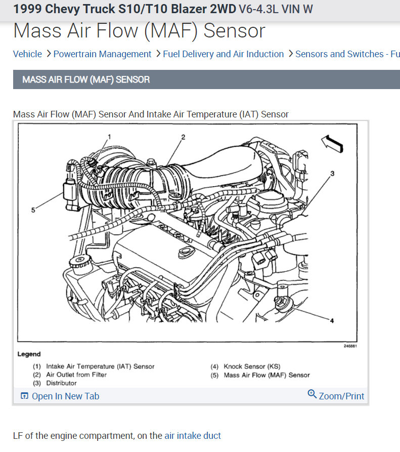

the MAF sensor can cause this issue. If the sensor stops working the computer sees the engine not running and cuts the fuel delivery. Here is a guide to help you step by step with instructions in the diagrams below to show you how on your car:
https://www.2carpros.com/articles/how-to-replace-a-mass-air-flow-sensor-maf
