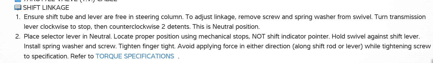

The actuating lever on the side of the transmission however will go into the park detent position. Where and why is it hanging up???? Is the problem with the lock cylinder/steering column, shift lever on the steering column/ shifter cable from the steering column to the A/T housing?
