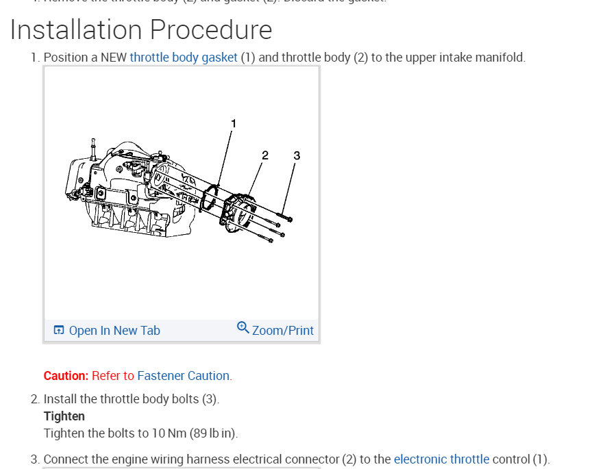

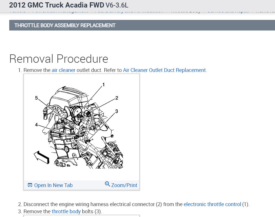

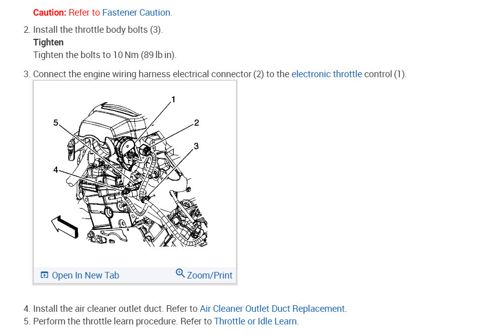

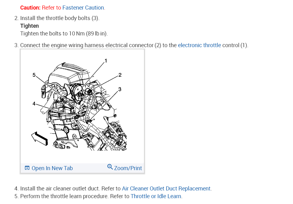

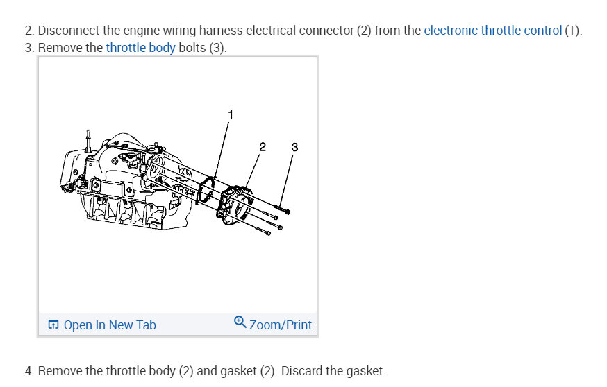

It sounds like the engine is in limp mode, this can be because the throttle body needs to be replaced but we need to run the codes to see what comes up and then go from there. Also, you can try servicing the throttle body as well.
This guide will help:
and this guide can explain more of what is wrong:
https://www.2carpros.com/articles/reduced-power-limp-mode
Here is a generic guide to help you step by step with instructions in the diagrams below to show you how on your car:
Check out the images (below). Let us know what happens and please upload pictures or videos of the problem so we can see what's going on.
