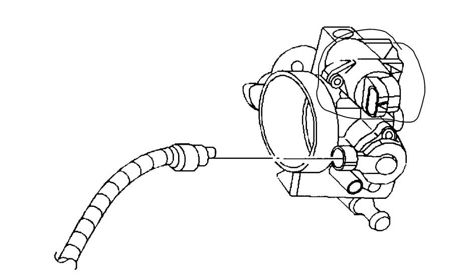

Good morning,

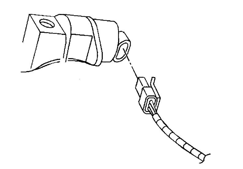

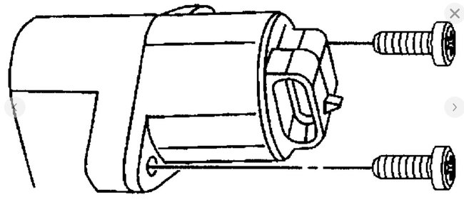

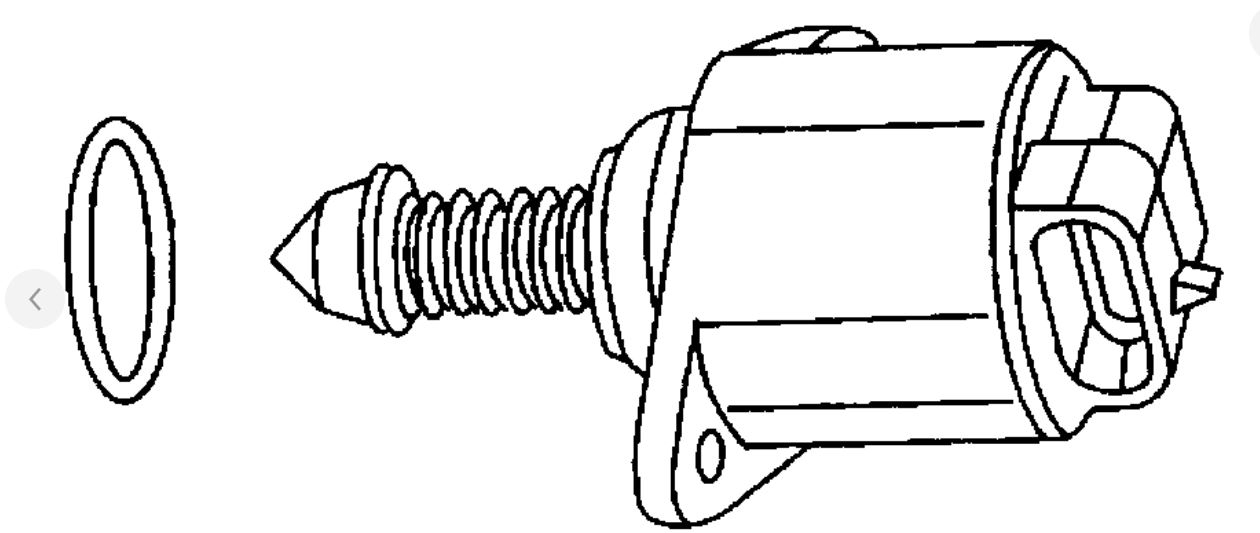

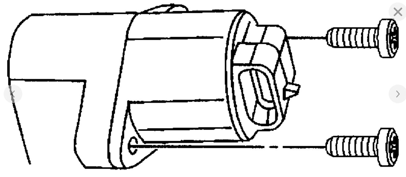

the most common cause for this issue is the idle air control motor on the throttle body.
I attached a picture and a procedure for you to view.
REMOVAL PROCEDURE
1. Remove the electrical connector from the idle air control valve.
2. Remove the idle air control valve (2) attaching screws.
3. Remove the idle air control valve.
4. Remove the idle air control valve O-ring.
