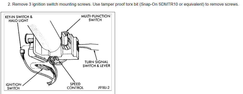

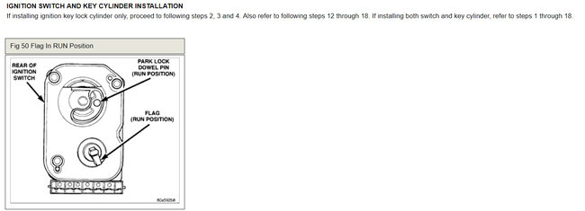

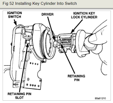

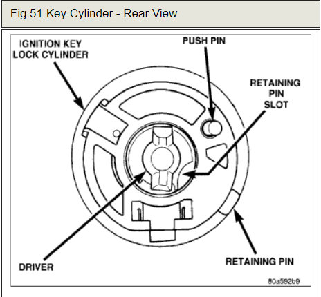

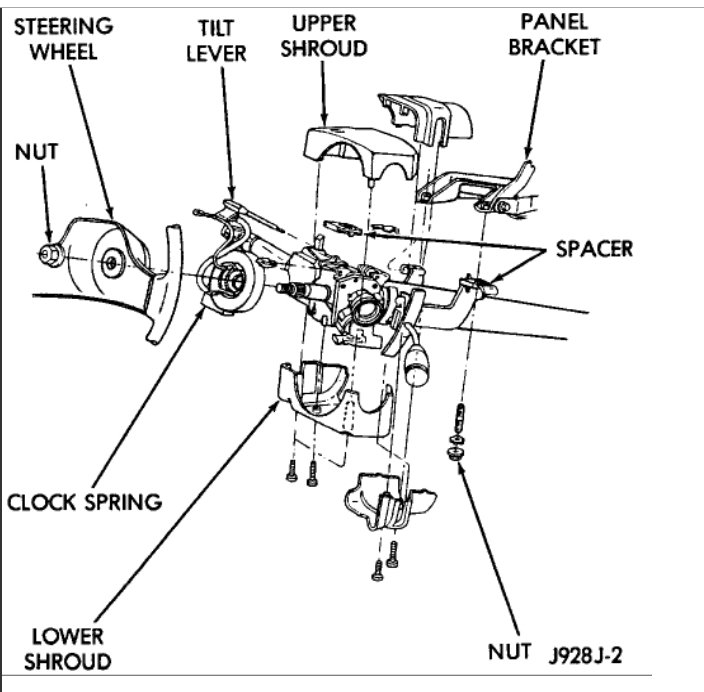

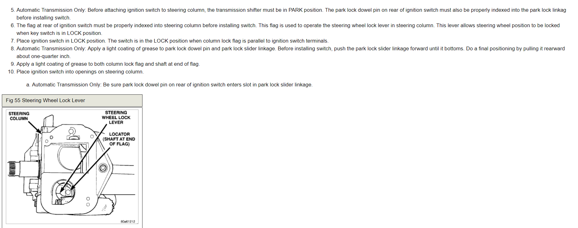

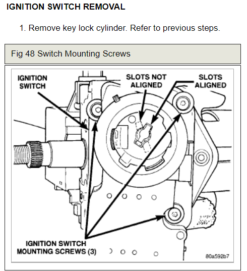

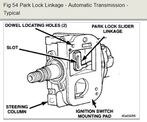

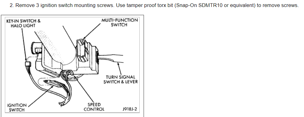

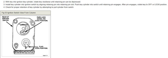

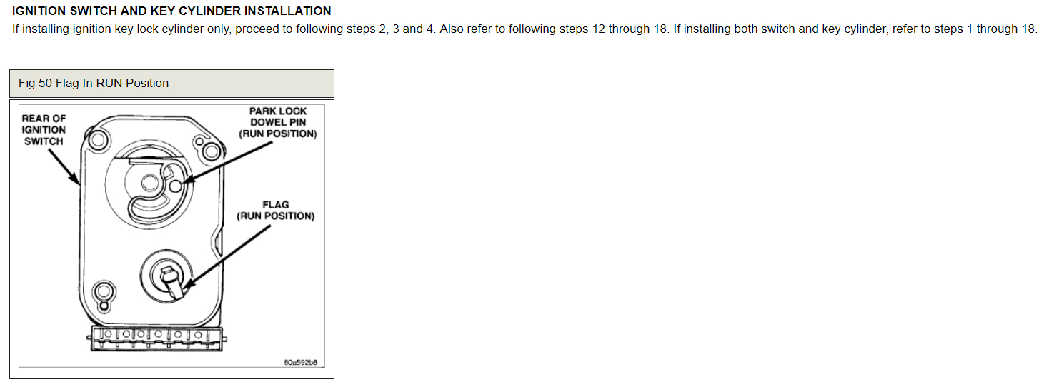

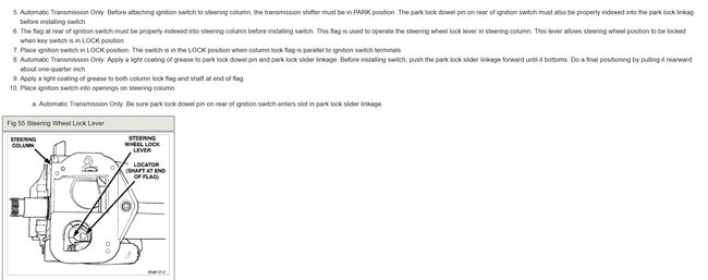

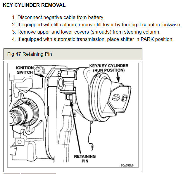

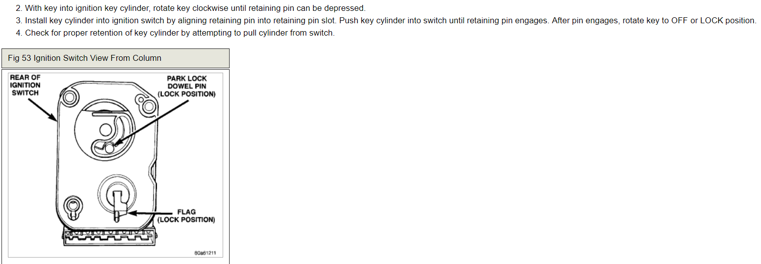

Oh yes, they had problems with ignition switches in those trucks. Here is a guide to help you change out the ignition switch and below are diagrams to help you get the job done.
Check out the diagrams (below).
