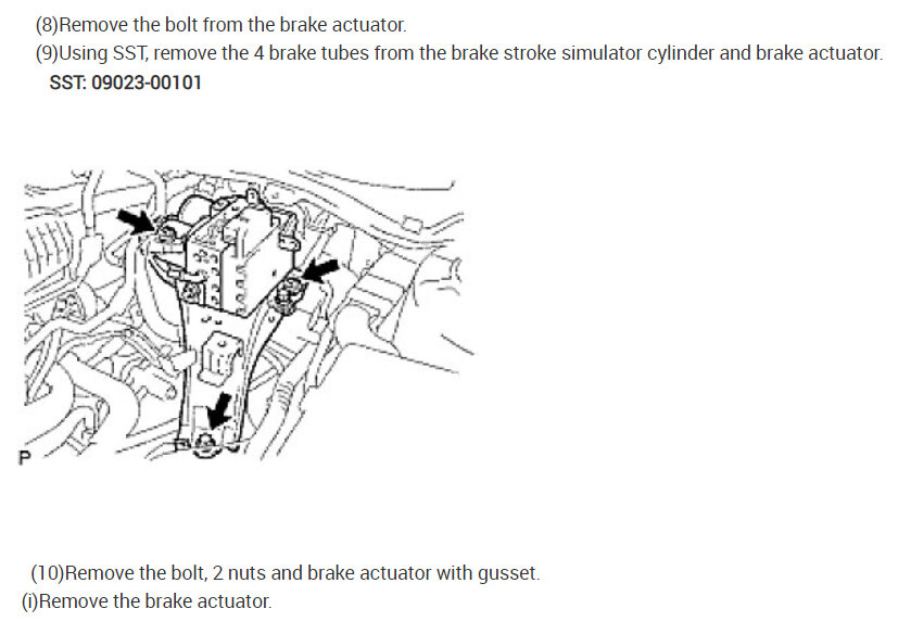

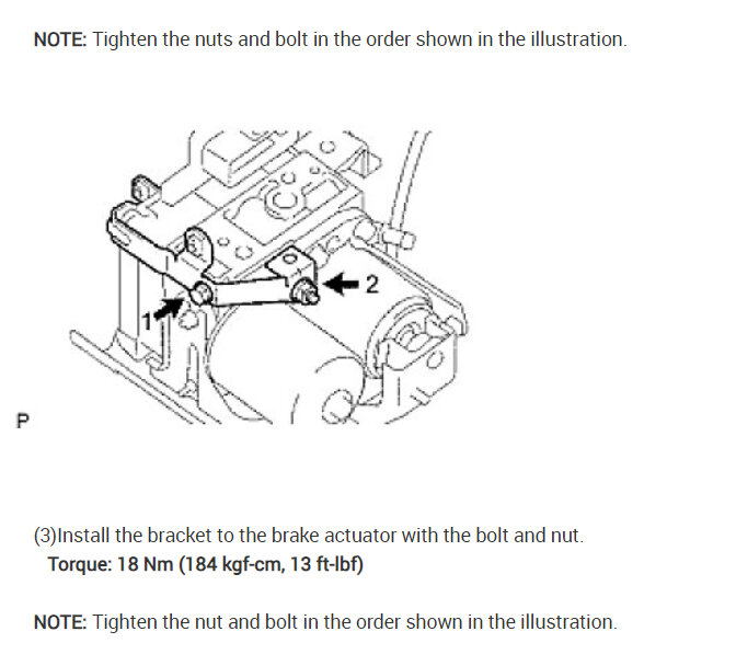

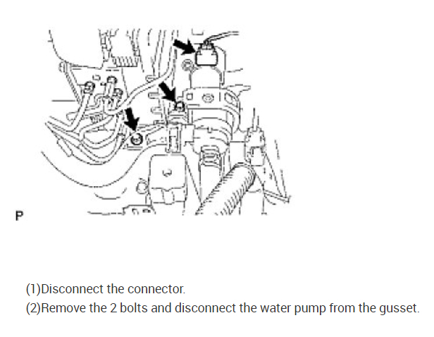

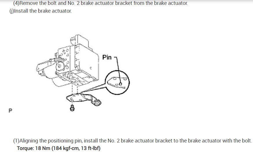

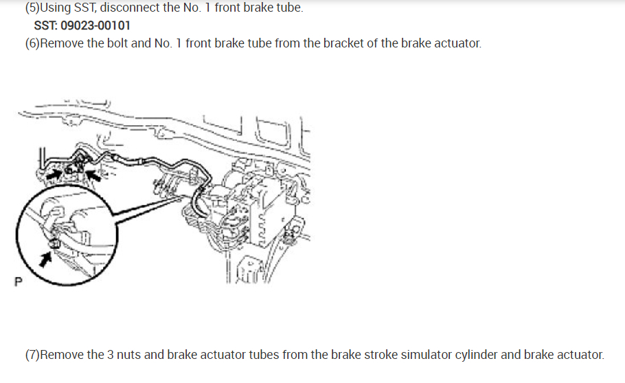

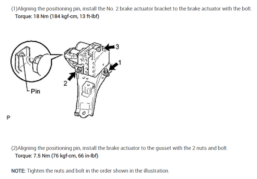

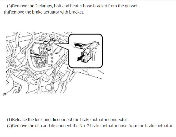

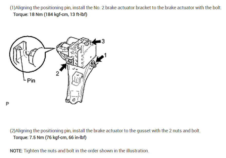

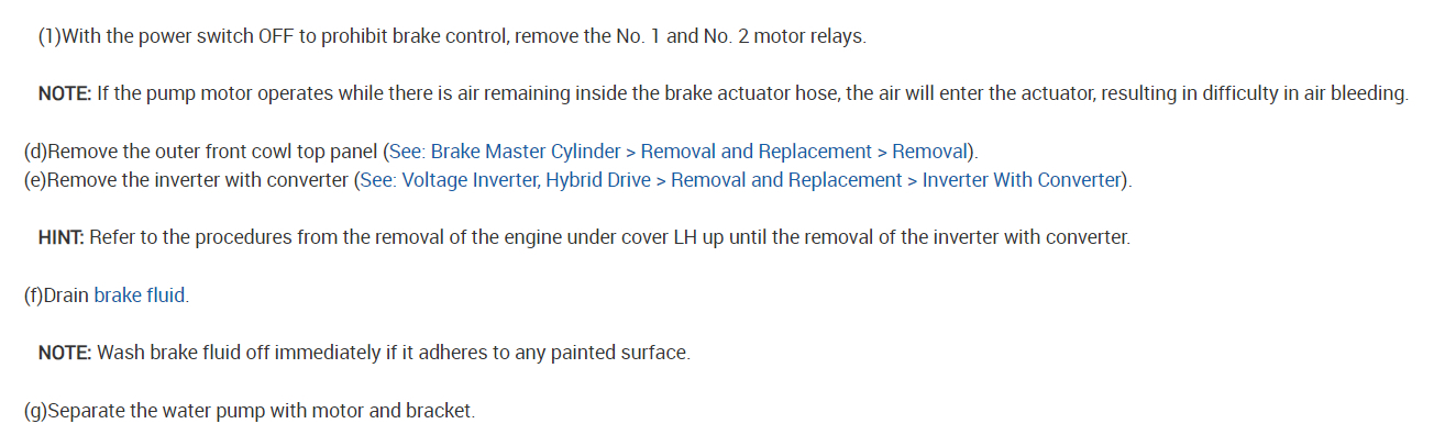

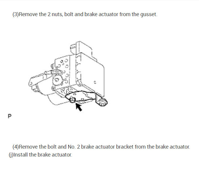

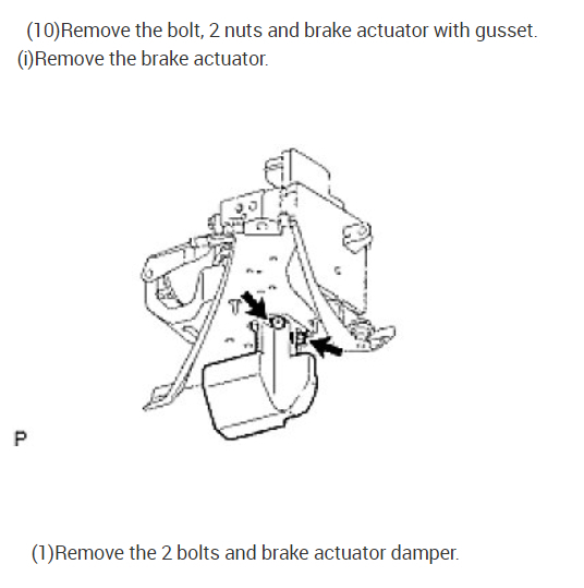

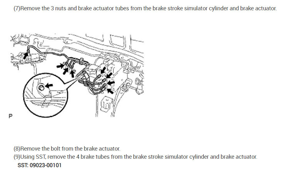

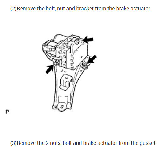

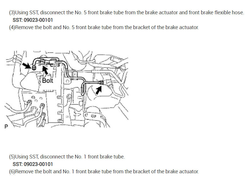

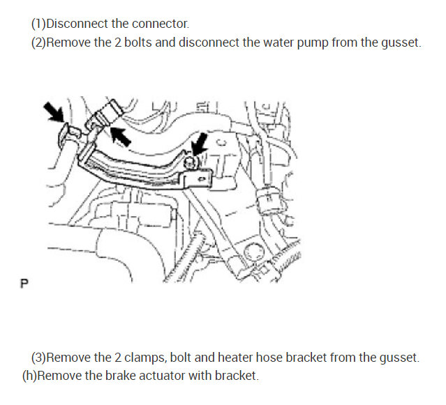

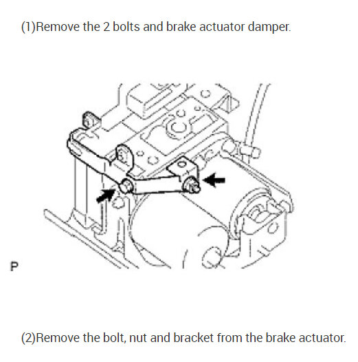

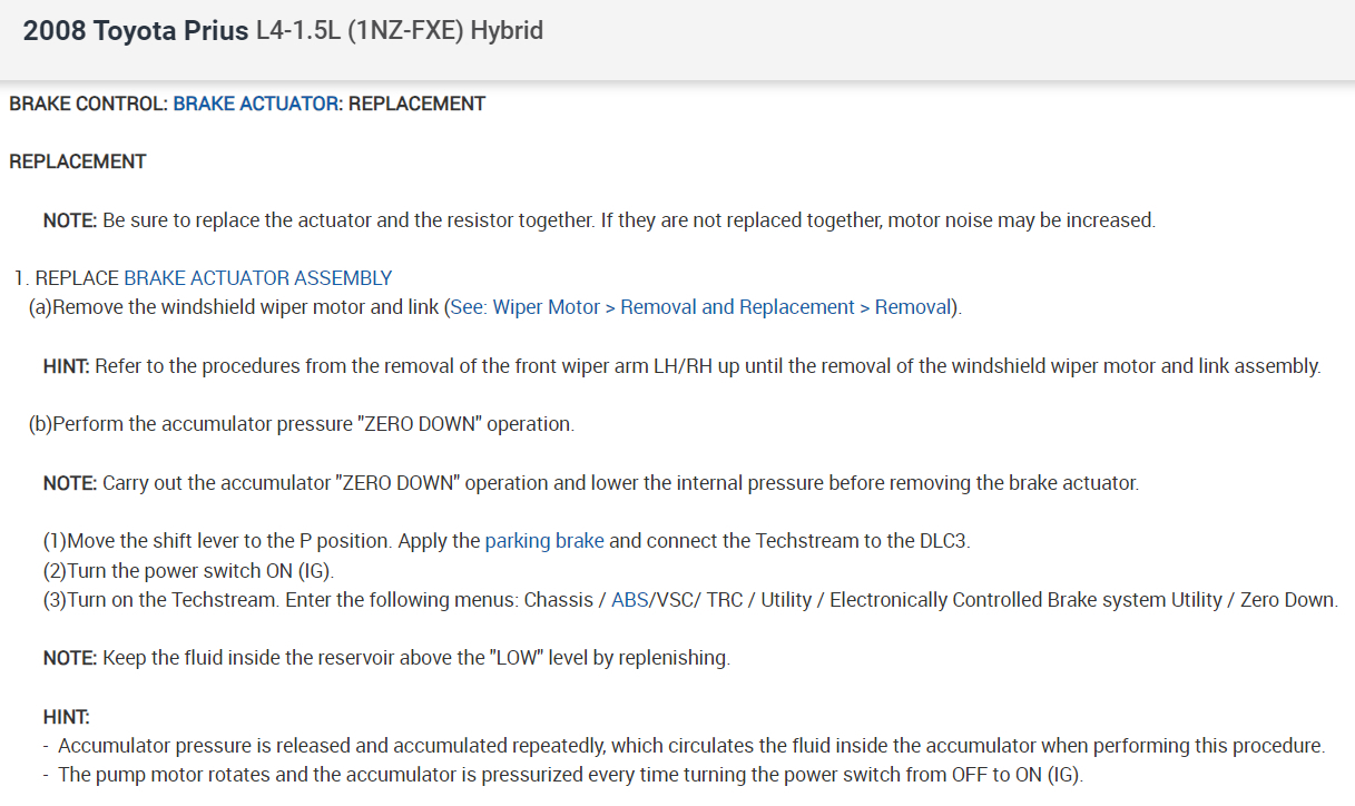

Bummer, I am sorry to tell you this, but the ABS control module is out, and this is a common problem with these cars with this many miles on it. I would check the brake fluid level first and if it is okay here is what needs to be done to fix it.
Code C1256 - HV System Malfunction (Accumulator Low Pressure)
Code C1365 - Brake Control System Malfunction (Linear Valve Offset Learning Abnormal)

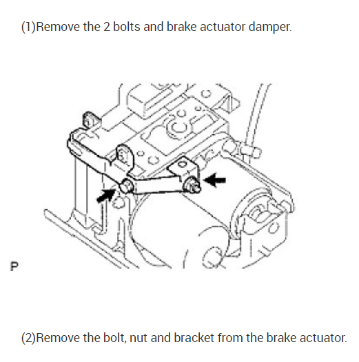

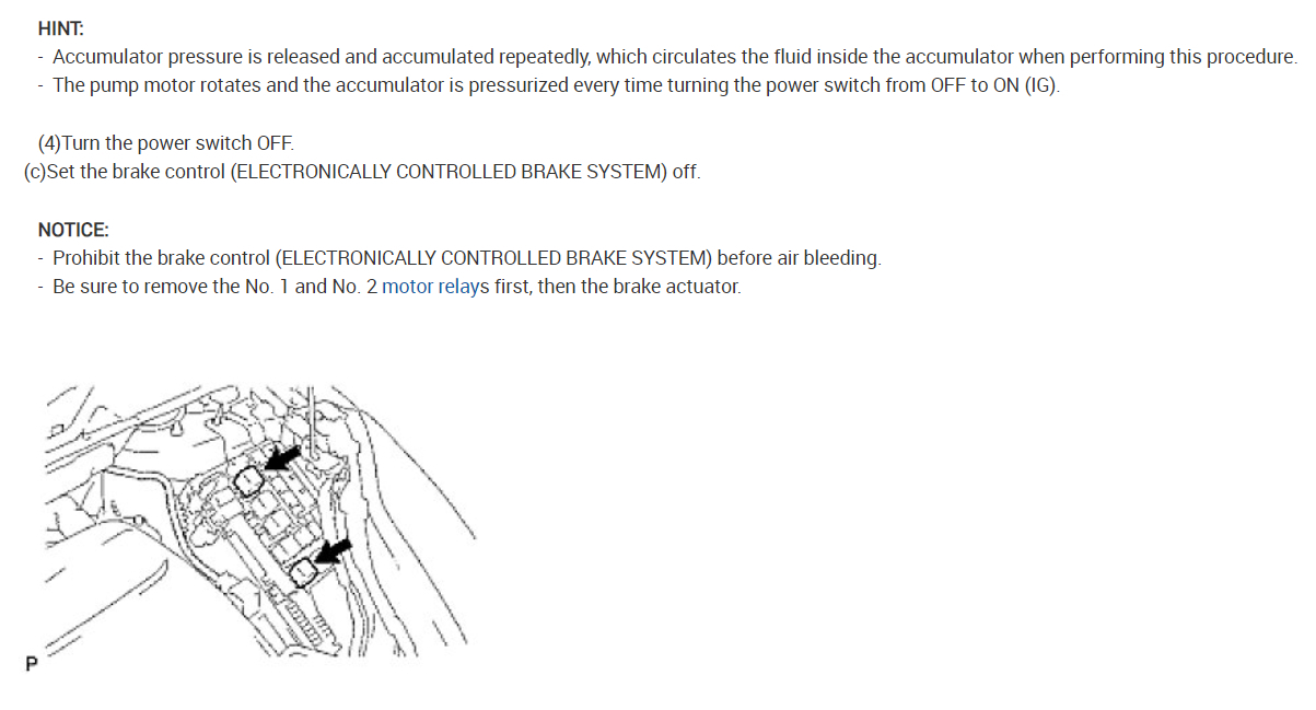

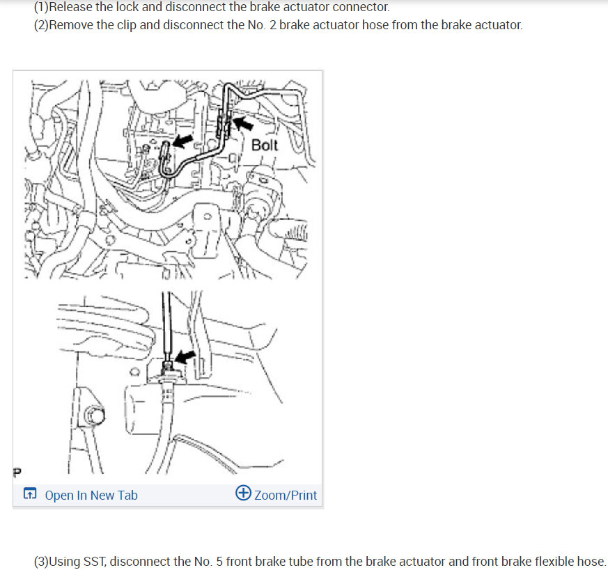

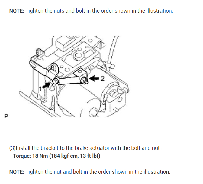

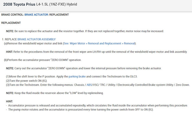

I would search google or Ebay to find a used or rebuilt unit. This is how the job is done so you can see the steps. Check out the images (below). Let us know what you find.
