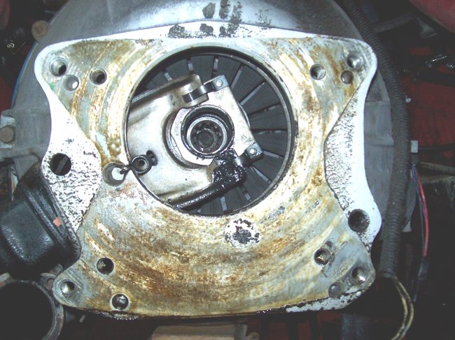

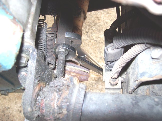

The clutch linkages tend to "saw" into each other over time.
The rod may have a deep groove cut into it, top or bottom end , or the bell crank holes may be mega elongated. Over time they will saw away at each other and get harder and harder to push. Eventually one or the other will saw thru and the linkage will fail!
Normally this happens in stopped traffic, suddenly the clutch pedal hits the floor, and you are eagerly on the brake to avoid smacking the guy in front of you!
Must keep good linkages, keep 'em greased and oiled. Or break down, like me, and modify the links with real bearings at the pivots.
You should have "1 inch" of free play in the pedal before you feel the throwout bearing contact the pressure plate.

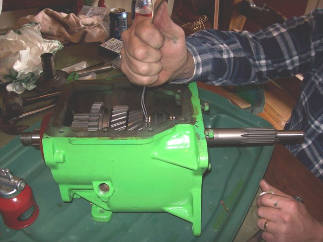

You DID NOT separate the tranny from the transfer case? Nor did anyone else?
Bellcrank on backwards?
