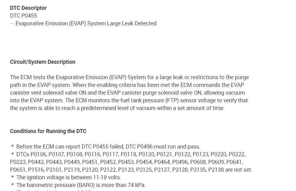

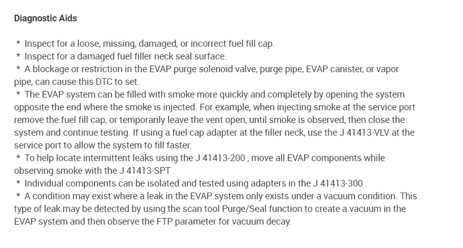

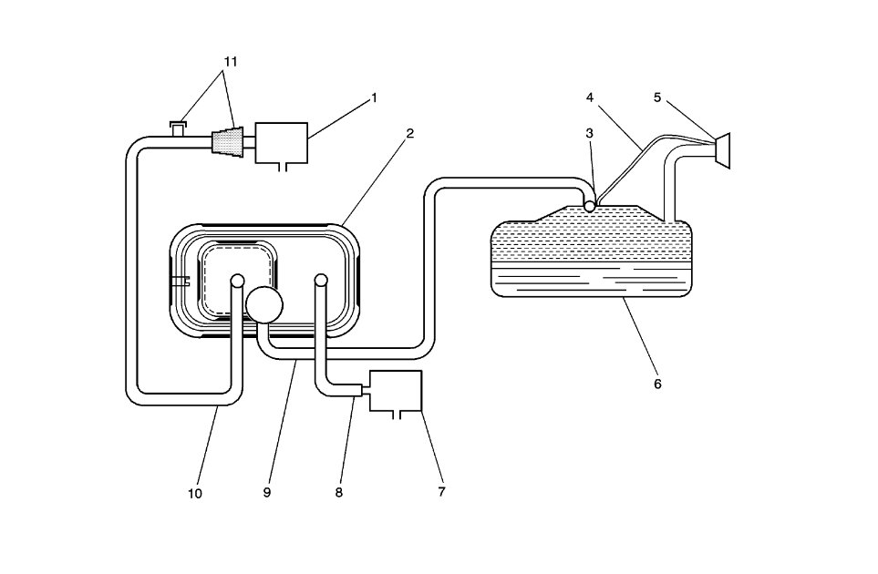

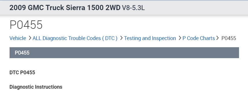

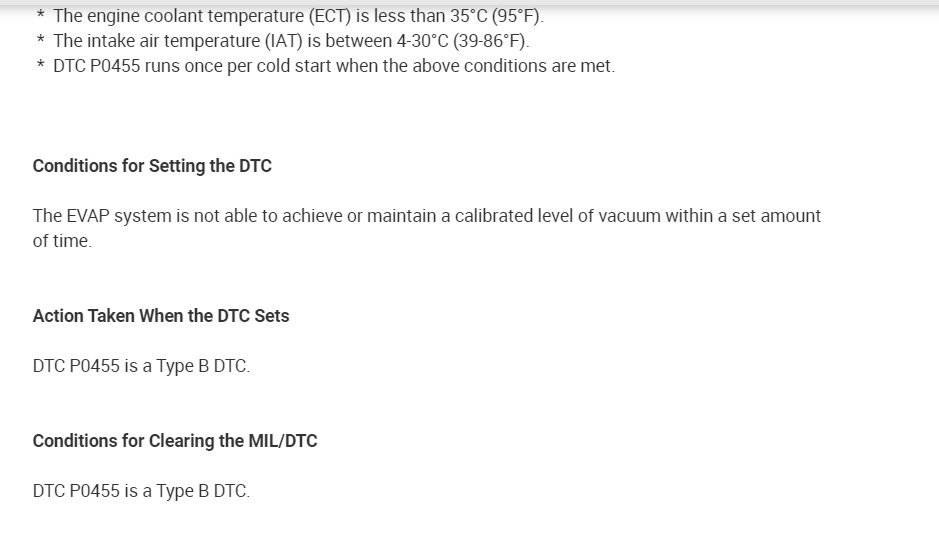

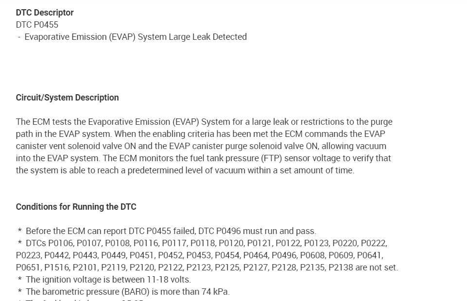

I have the vehicle manufacturer's diagnostic troubleshooting guide for Direct Trouble Code[DTC] P0455, which is a large leak in the EVAP system, but I do not show a DTC for P0499 in the list for your vehicle. I have included in the diagrams down below the diagnostic troubleshooting guide for DTC P0455 along with an EVAP diagram and callout. The testing part of the I left out because it calls for the use of a smoke machine to test the EVAP system. I can send it to you if you would like. Since the DTC indicates a large leak I would recommend just following the diagram and inspecting the components and the hoses. It should be readily noticeable where the leak is. Look for hoses that are not connected, broken, or damaged components and report back here with what you are able to find out.
