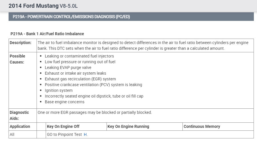

However, the code you have is specific to an air/fuel imbalance between the two engine banks. It can be caused by a few different things. For example, a weak fuel pump can cause it, an engine vacuum leak, or even an exhaust leak. Since you have installed headers, are the upstream oxygen sensors still present, and if so, are there any leaks in the exhaust pre-converter?
Do me a favor. Take a look at the pic I attached below. Note the list of possible issues/causes. Let me know if you have already checked the possible causes listed.

Hello, honestly, I have not checked any of those. The issue with the rough idle was before the header installation, but the P219A code first appeared about 2 weeks after replacing upstream O2 sensors. I replaced them in hopes of resolving the rough idle. I have been keeping an eye on my STFT while driving, and what I noticed was bank two was always lower than bank 1. When I put the car in neutral or park, I'll see the stft drop to about -30 and catch back up eventually. If tried taking the car to a mechanic but my car won't let their readers work due to the tune. And I can't revert to stock without removing parts. Seems like I've dug myself a hole, lol.

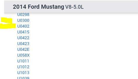

Is it a U0401? If it is, that isn't even listed for this vehicle. I do know it is related to invalid information from the ECM. Please confirm that is the code.

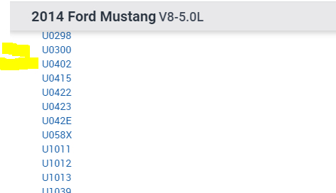

A weak battery can cause all kinds of electrical glitches. Is there a reason you are questioning whether the battery may be faulty? If so, follow this guide and check the alternator output. Let me know what you find.
Also, the code you provided should be a letter (U) and a 4-digit number. See pic below.

Hello, I apologize it was a U0401. Before this code showed up, I had some other weird codes pop up such as front wheel speed sensors invalid. I had both the battery and alternator tested and the battery was in fact bad. I replaced the battery and all my codes have magically disappeared.
Oct 13, 2023 at 6:03 AM
Wow!!! That's good news. Also, I appreciate the update. I'm glad to know it was an easy fix and you were able to resolve it.
