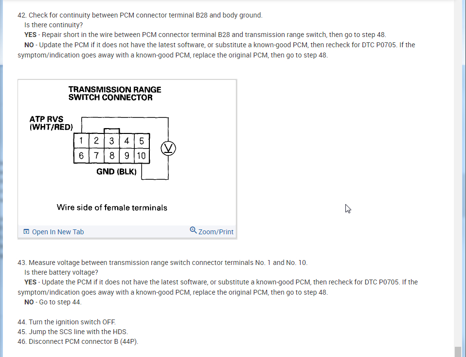

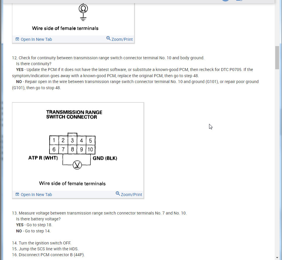

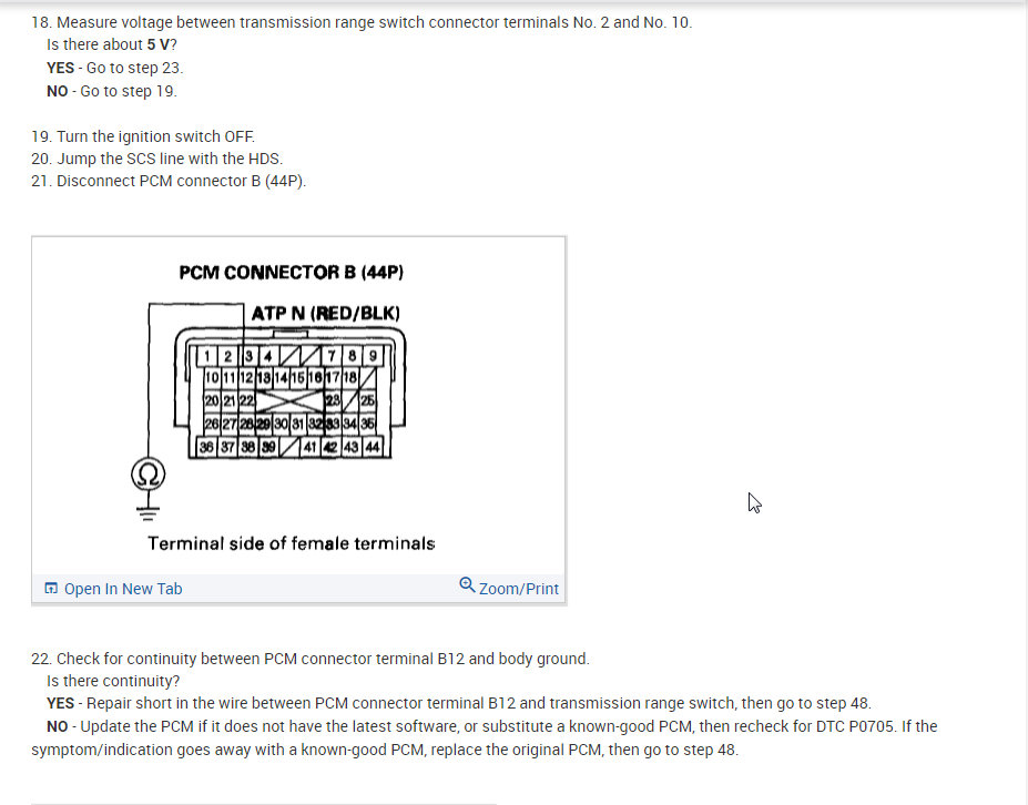

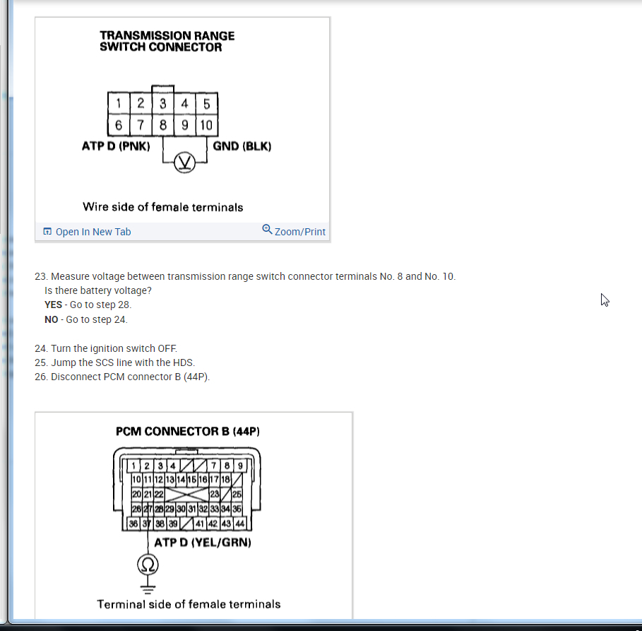

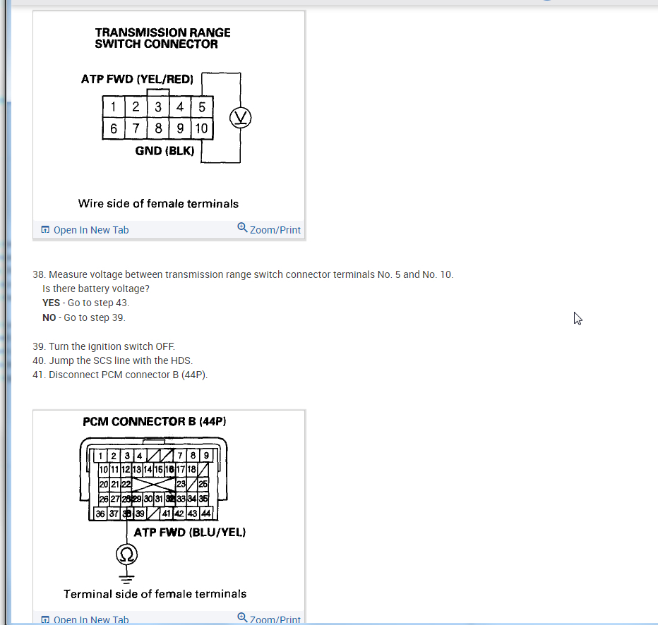

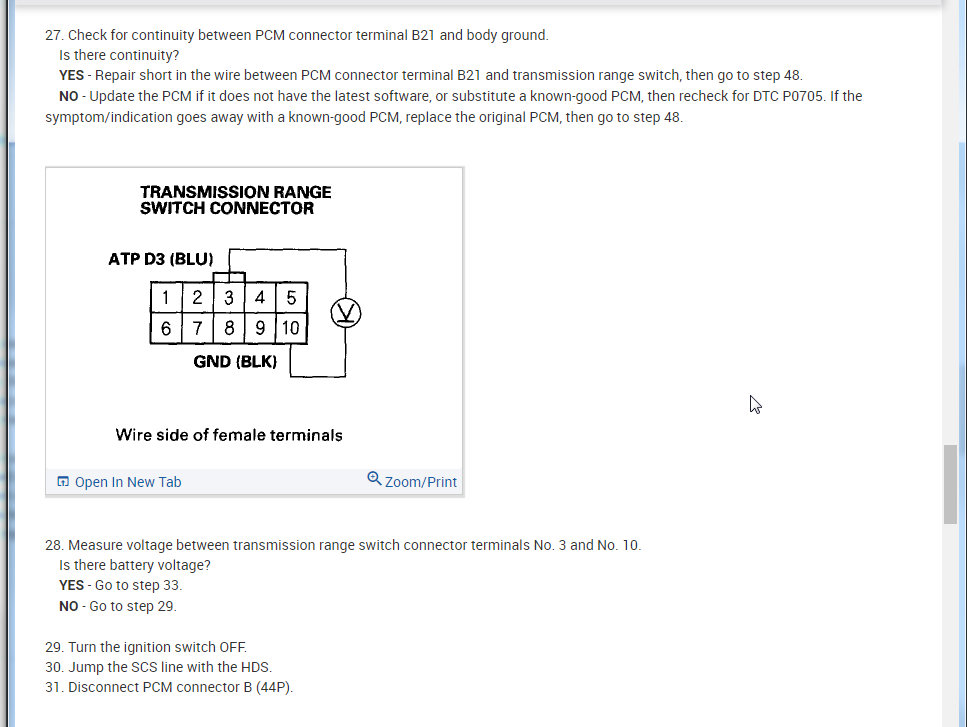

The D flashes when shifted into R. Returns to normal if ignition is turned off and restarted, only to return if shifted into R again. Everything else is fine, even shifting when driving. Code P0705 showing. Could this also be transmission pressure sensors instead of range switch? Also when in R, the R is lit, as is the flashing D together.
