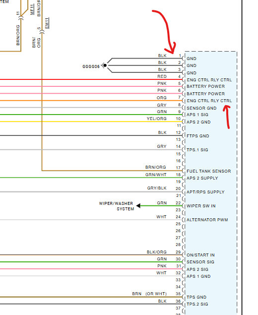

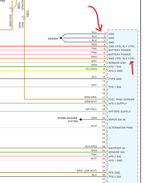

Nice testing, so the power is good and the grounds are good. Did you check the grounds to the PCM ? Here are the locations of the ground so you can check them out. You might as well check the power inputs as well, they are all together on the PCM. Let me know what happens.

Also there's a couple grounding points inside the car that I did not locate are you able to get a picture diagram of their exact location I know they're on the driver's side but I don't know if they're under the carpet or under the panels It was very unclear and I was not able to test those grounds. In the engine compartment I got the ones on the driver and passenger towers , 2 on dr. Side tower by ECU,the strap, the one under the coolant the one on top of the transmission are there any I missed?
Feb 26, 2026 at 3:50 PM
To me it sounds like the PCM might be bad, this is why I wanted to test the power and grounds of the PCM. The problem is all off these codes came up at once correct? I would call these guys, I have had good luck with them.

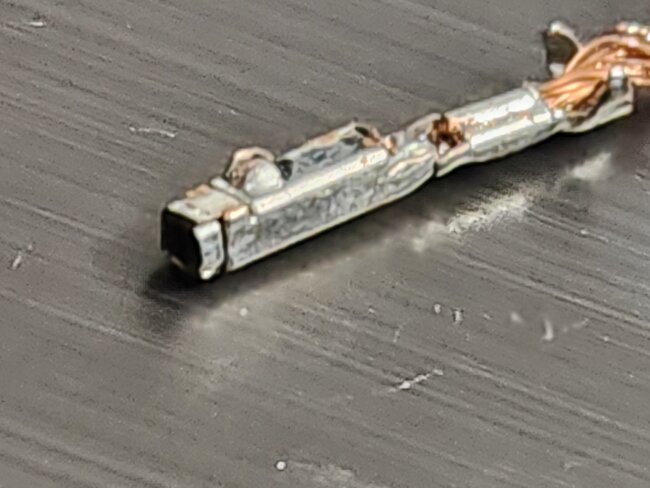

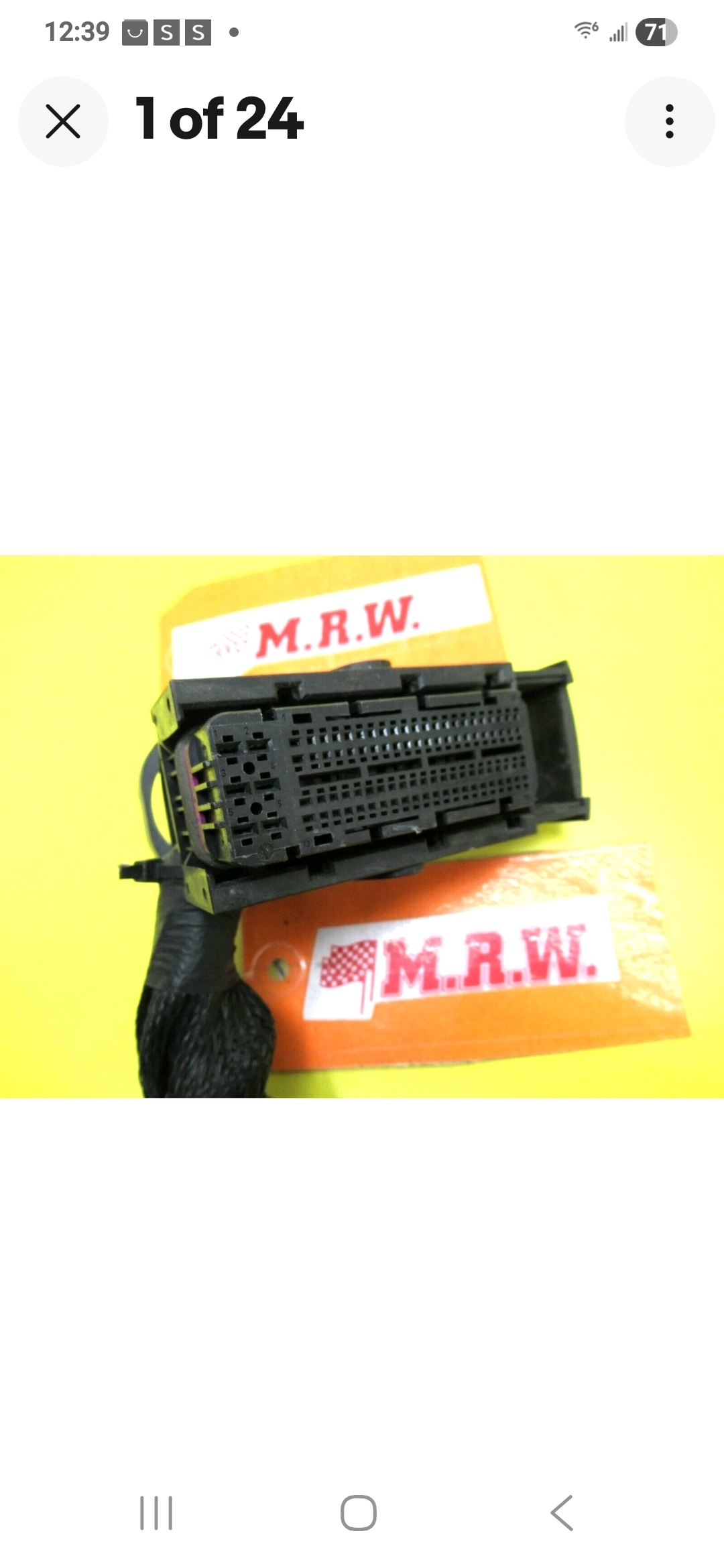

So I'm putting in new wiring to the crankshaft position sensor and I am having trouble finding the terminal pin size for the ECU connector. Can you please see if you can locate the size of the pins I need to order here is a picture of the connector.
Mar 9, 2026 at 2:03 PM
ANNS75
  • 22 POSTS
Approximately 2mm squared x 16 mm long

What I recommend ordering
Look for:
0.64mm ECU terminal pins 20-22 AWG
or
Bosch / Hyundai ECU Micro-64 terminals
Those are the ones most harness builders use.
