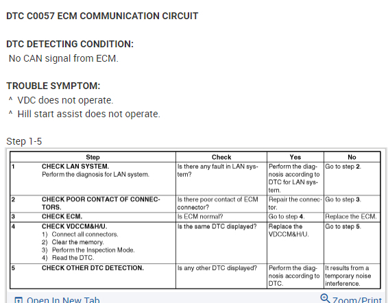

The car looks and runs great when suddenly the following lights come on;
1. Check Engine
2. AT Oil Temp
3. Traction control
4. Brake light (flashing)
5. Cruise light (flashing)
The car continues to run fine.
The first time this happened I put the code reader on it and found;
1. P0042 (minor evap system leak)
2. C0057 (ECM Control)
3. C0045 (ICM Malfunction
4. C0042 (Power Supply Voltage Failure)
The second time this happened, I didn't have the code reader with me but after the first stop 2 lights went away and after a second stop, all lights went away.

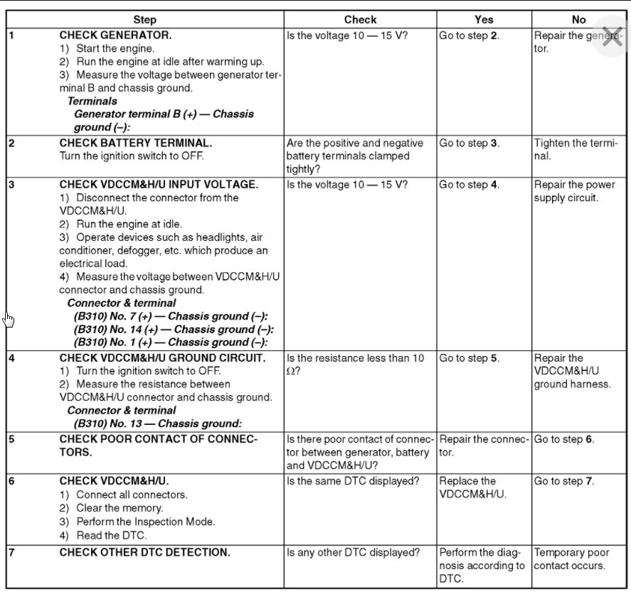

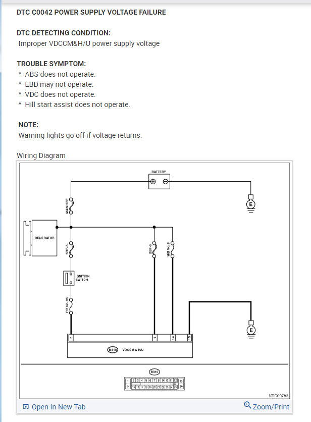

I suspect the root of the problem is C0042. I read the ABS computer monitors voltage and an interruption could effect or cause all the other codes. I decided there may be corrosion in the plug so I tried to take the master plug off the ABS system but it is quite stuck. I don't want to risk breaking it until I am certain the problem may be there.
Any thoughts?
