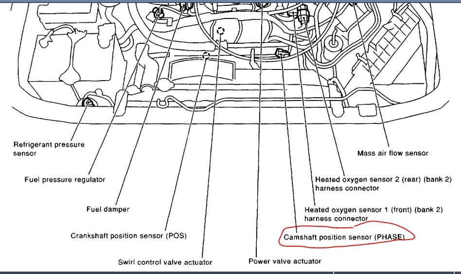

Next, I need you to check the connections at the swirl valve and the camshaft position sensors. Make sure there are no issues with corrosion or damage.

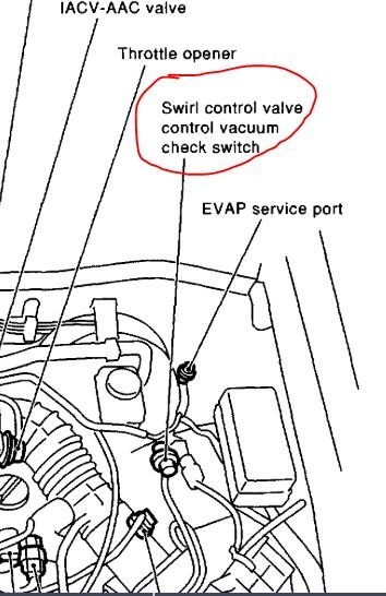

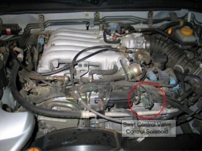

Since the swirl valve also operates on engine vacuum, we need to check for a leak. Here is a link that shows how to check.
I attached 3 pictures below. The first shows the swirl valve connection, the second shows the vacuum control switch for the swirl valve, and the third is the cam sensor.
