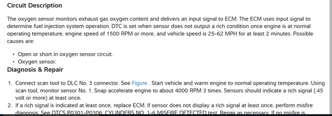

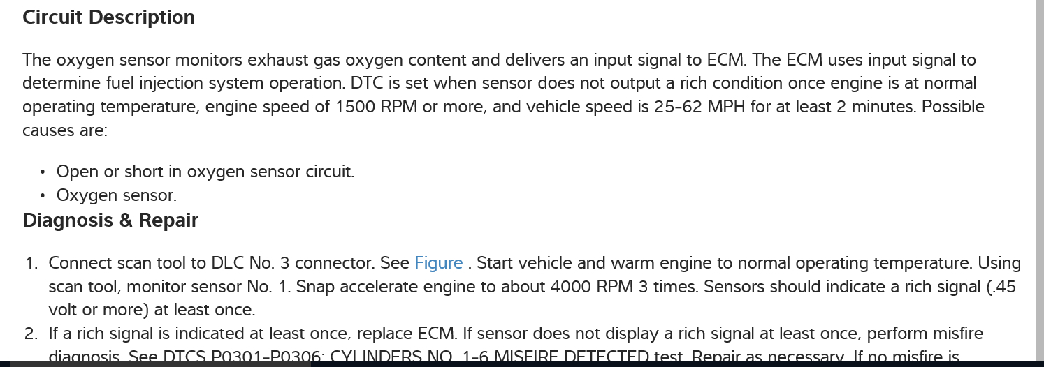

You need to check oxygen sensor in front of catalytic converter. The coolant temperature is too low to go into closed loop. See picture on how to test it.
