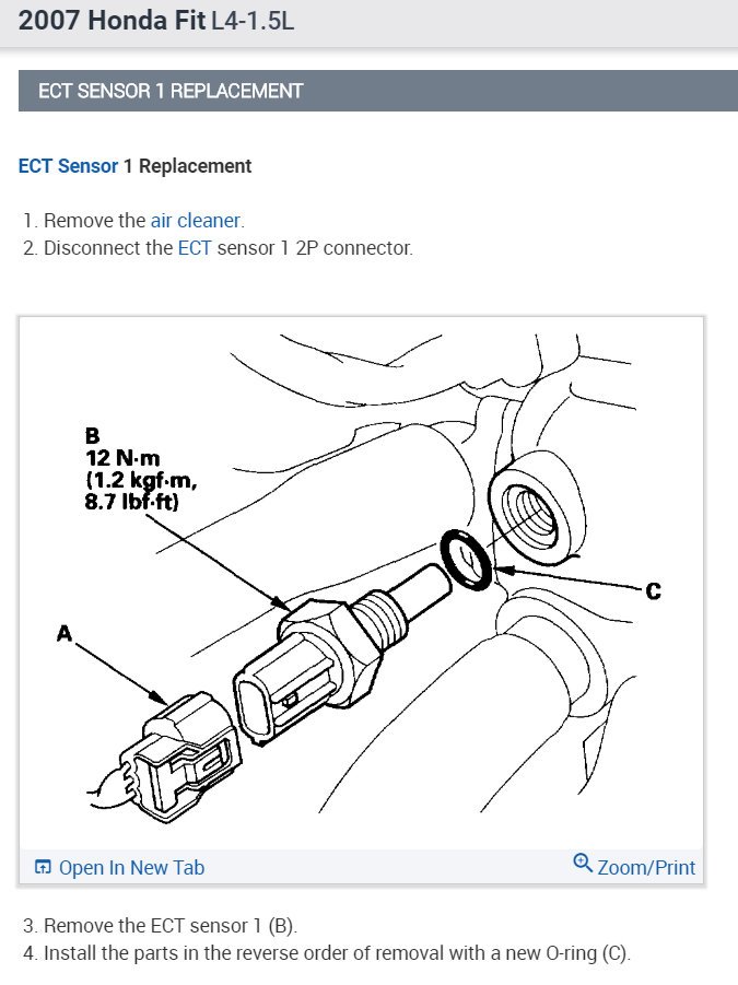

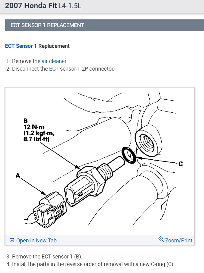

There are two coolant temperature sensors. The one you replaced is for the cooling fan. Here is a guide to help you step by step change the sensor and the location of the coolant sensor up by the upper radiator hose so you can see how its done on your car below:
https://www.2carpros.com/articles/coolant-temperature-sensor-cts-replacement
Check out the diagrams (below). Please let us know if you need anything else to get the problem fixed.

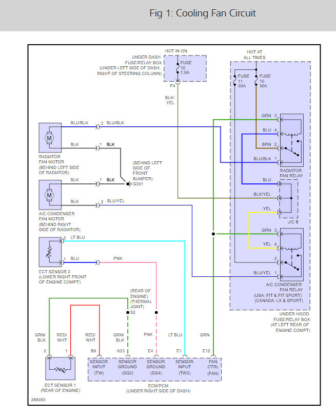

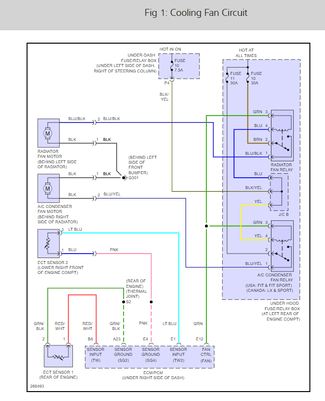

Hi Ken, thanks for the reply. From what I understand, code P2185 refers to coolant sensor 2. When I saw the wire harness at the connector completely corroded to the point that it was no longer attached, I thought I found the problem. Since I could not locate a pigtail replacement connector and Honda wants $860 for a replacement harness, I carefully repaired the existing one by soldering a length of wire to the existing connector. So, I could try replacing the other ECT sensor (1) near the thermostat, but I have a feeling that the harness or repaired connector might be causing the check engine light issue. I would like to find where I would check for continuity or other tests (voltage/resistance) to rule out the harness as the problem.
Oct 13, 2018 at 5:41 PM
Good idea, here is the cooling fan wiring diagrams and a guide to help you run the test:
